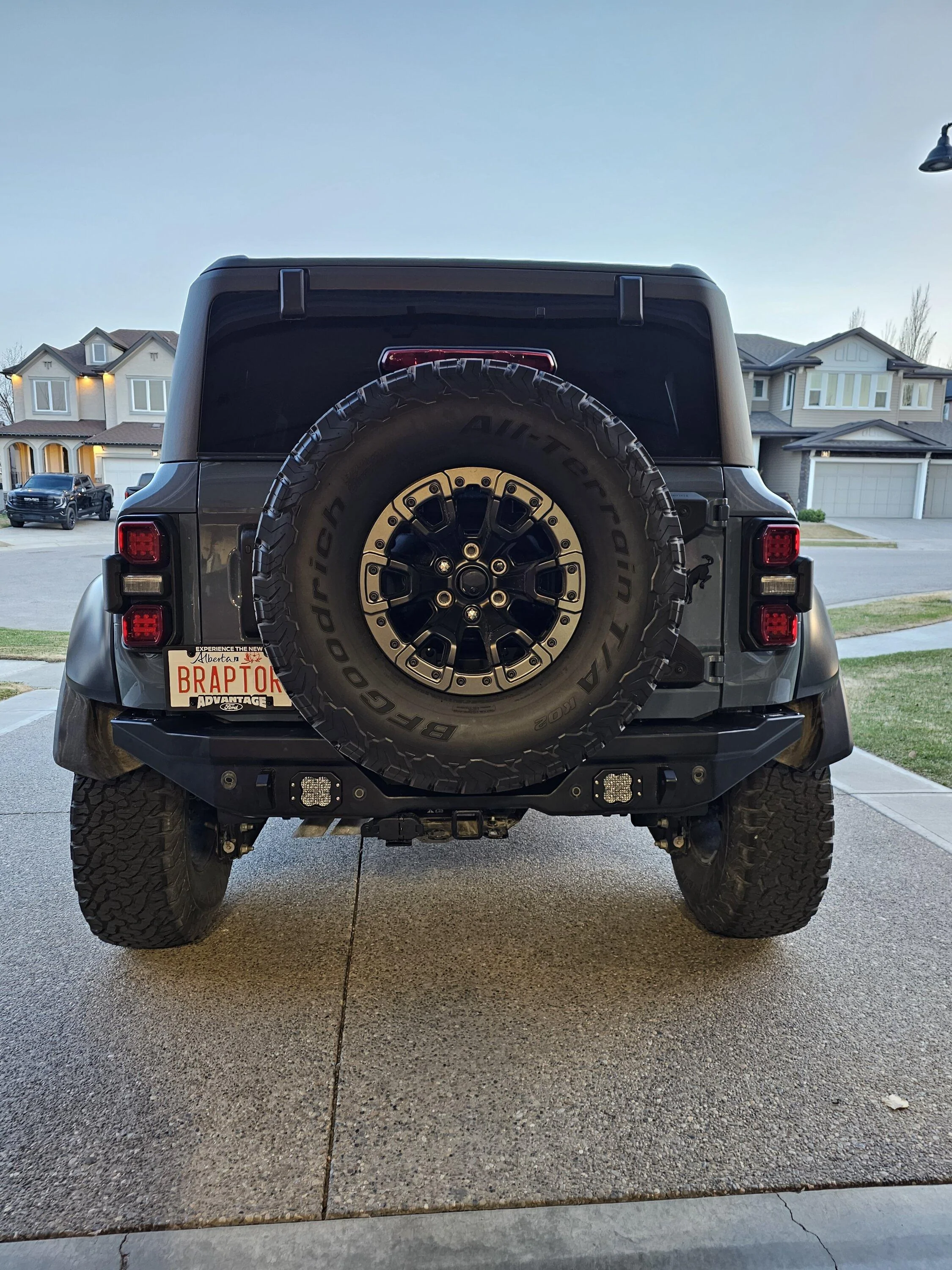

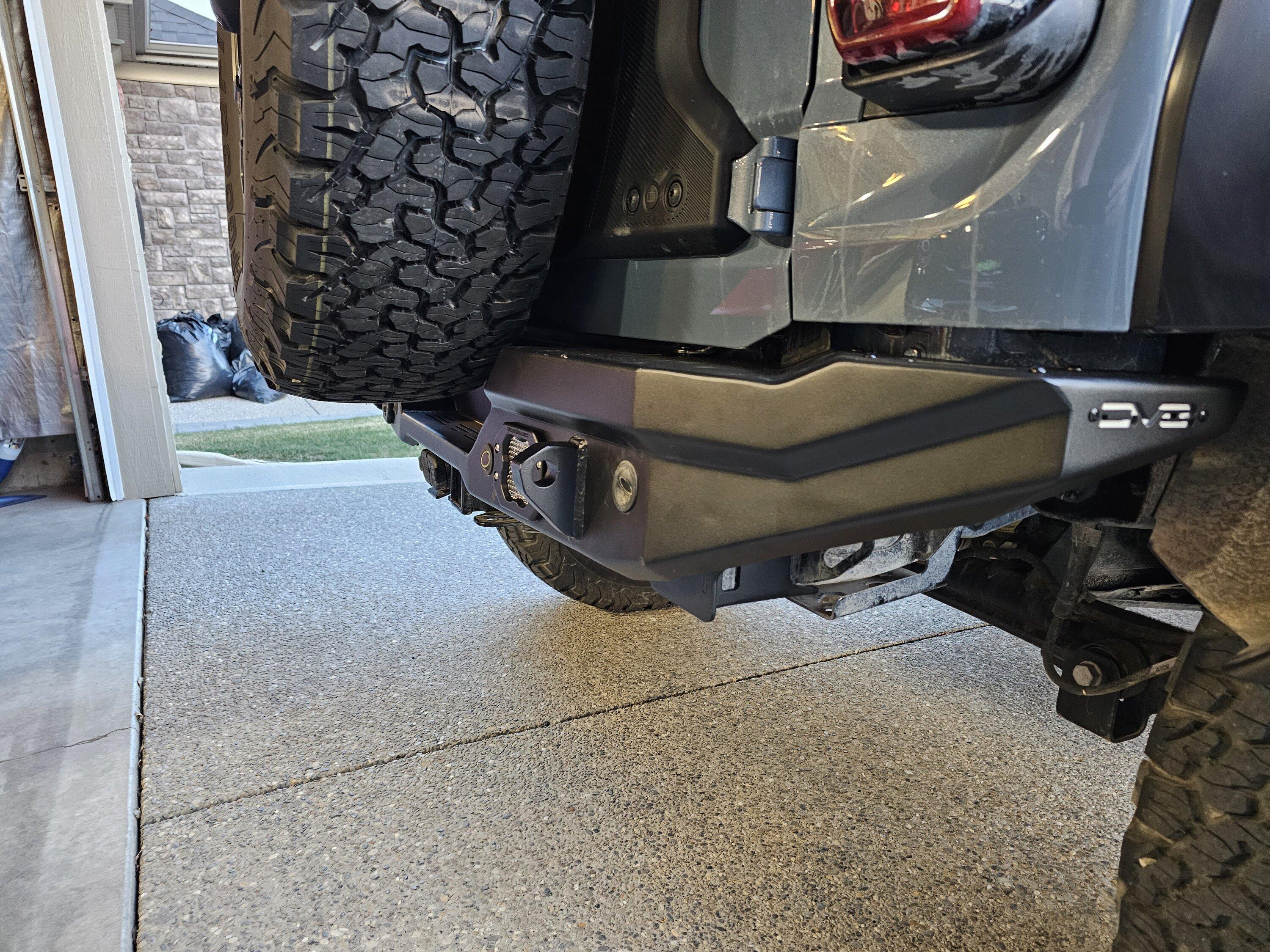

I installed the DV8 FS-15 onto my Braptor (which ultimately has lux package) and had to use the full "LPBR-03" license plate bracket that puts it on the door versus just relocating it to the left. You didn't specify the model you had but I'd guess they are all the same.
I did not have to do any recalibrations on the parking assist sensors and placed them all in the same way as unplugged from the OEM bumper. Both connectors on each side were put into the harness without any oddities.

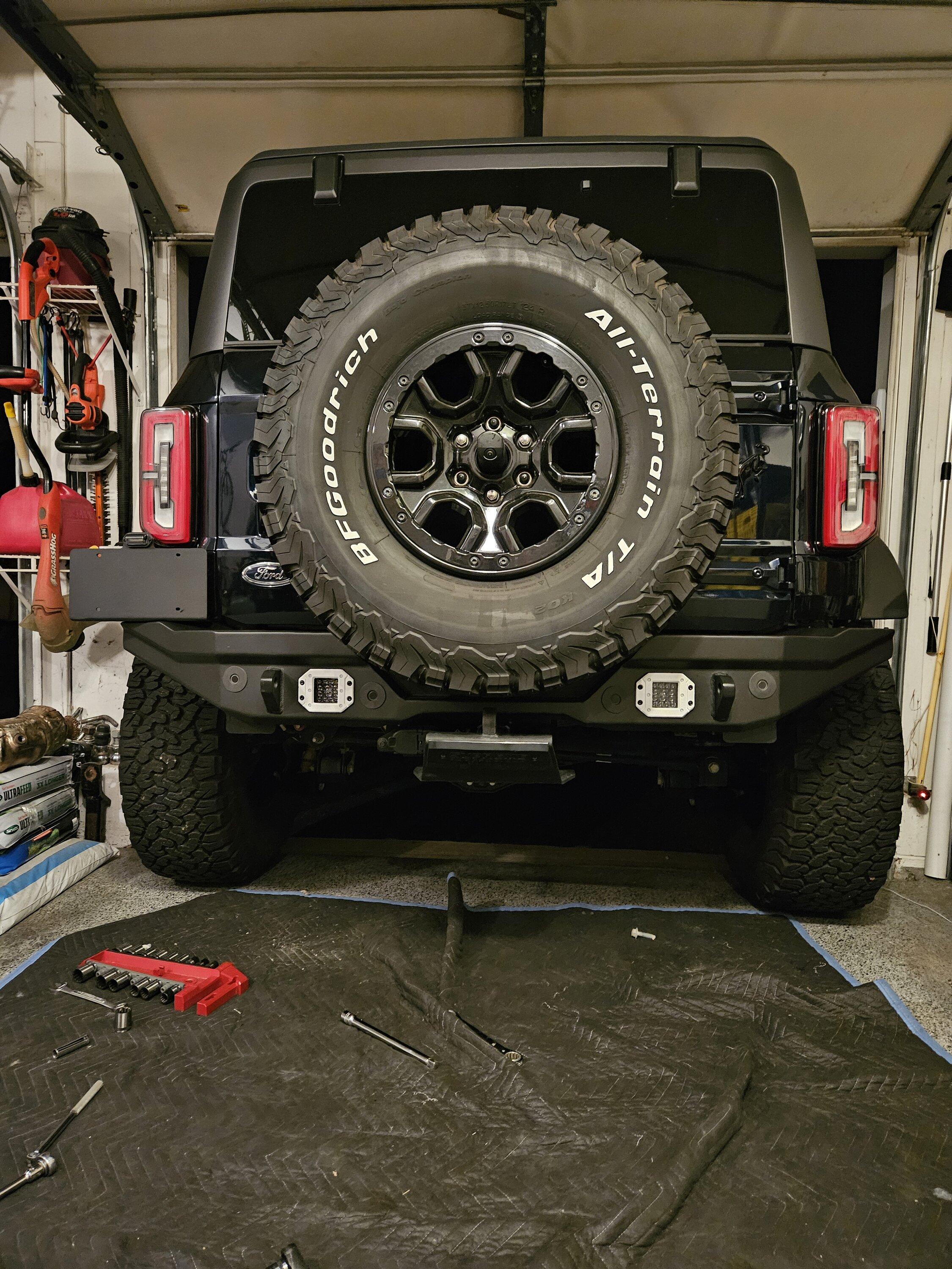

I installed, call it a pre-fit... The WT is going to the shop for new fenders AFC 8/1".
I'm pulling some of the stuff (flares, wheel liners, rear bumper) off to help with the fit test, sand / paint, and install.

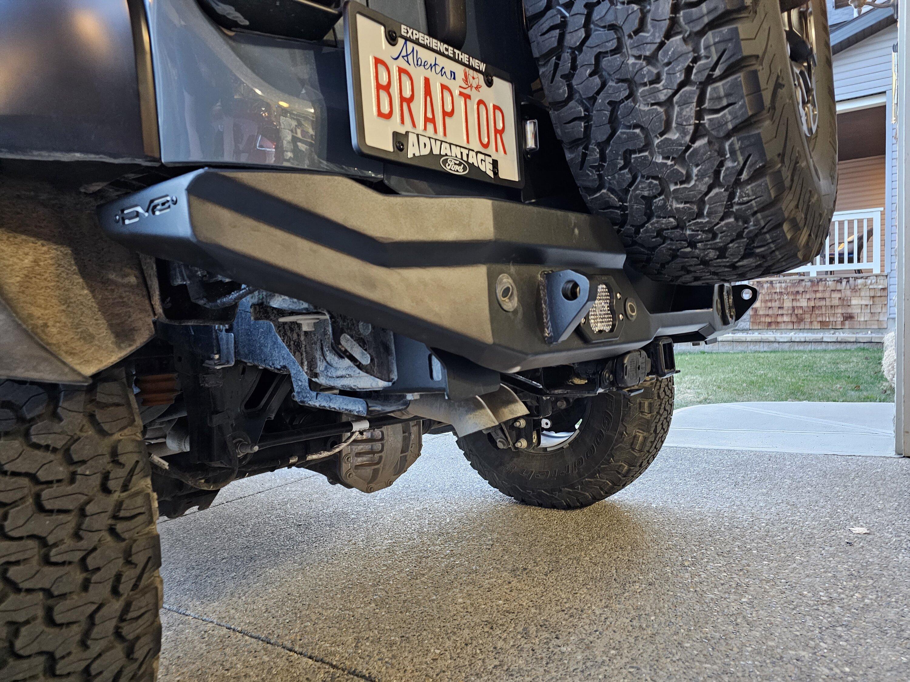

Putting the plate on the tailgate was the option dv8 said I had to do. I kind of like it there but occasionally hit myself opening or closing the door because I forget it's there. Was to used to my badlands and got in the habit of where to stand when closing it.

Will not fit on passenger side for sure. Bracket sticks past the door and would hit the light opening it and is designed one way on driver side 100%. 0 chance.
