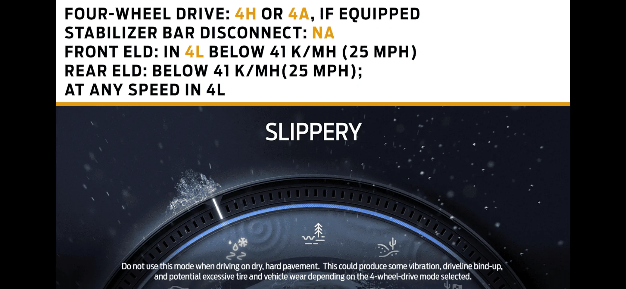

I agree, it is vague and you could interpret it either way specially as the first part focus on “DO NOT use 4WD drive on DRY hard surfaces” and rain is obviously not “dry”
Honestly I don’t think it is a big deal, even “GOAT’s slippery” engages 4WD, and there’s no warning just like the other modes, nor a max speed warning.

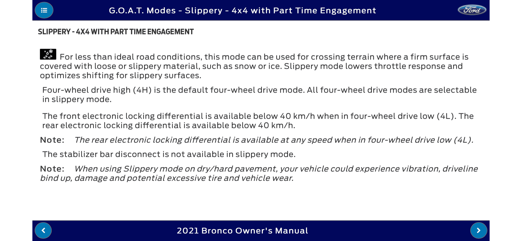

Yes it does default to 4H if you don’t have the advanced 4A
You can press 2H after selecting slippery mode which I believe would modulate throttle response while keeping 2H, but it is a two step process that I doubt Ford is expecting owners to do.

It sounds like it was a learning experience and that is good. The time lag coming out of 4H is due to mechanical binding caused by running 4H when not needed. The trick is to shift to 2H before the transfer case binds, then it will be quick. And as you now know 4H really isn't for rain, but 4A (if you have it) would be fine. But don't hesitate to use 4H on snow slicked pavement, just disengage when you transition to non slick conditions, the 4H-2H-4H-2H etc shift can be done on the fly, at will, just be sure you are not spinning a tire when you do it (the Bronco will actually cue you to back out of the throttle) and be traveling in a more or less straight line.
The Bronco defaults to 4H in slippery but you can still run Slippery in the rain if, after selecting Slippery you manually shift to 2H. This will give you the benefit of Slippery (throttle response, braking, shift points) without being in 4wd.

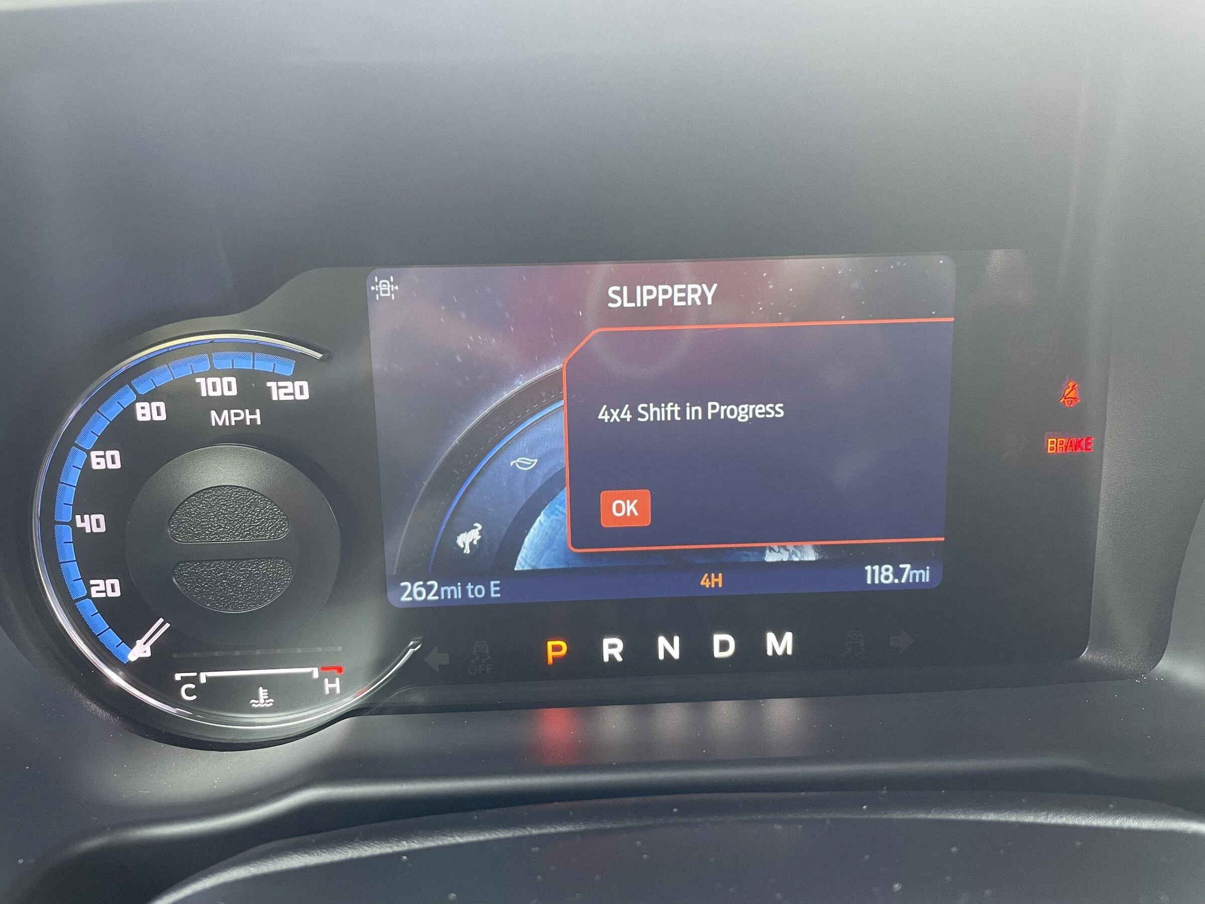

Can confirm that you are unable to switch to 2H while in slippery
Give it a try. It throws up a message on your dash. I just tried several minutes ago

The point at which the communication is breaking down is on the definition of 'slippery'.
The Ford manual considers 'slippery' under the G.O.A.T. mode of the same name to be on pavement
to be used '...for crossing terrain where a firm surface is covered with loose or slippery material, such as snow and ice.'
To me it seems clear they are talking about a very low friction surface that you won't sink in. (not mud ) like gravel, snow, and ice. Something the vehicle rides upon above the firm surface, rain does not qualify to my mind as it is displaced by the tires under the vehicle weight and you don't ride upon it (unless hydroplaning and at that point it doesn't matter how many wheels are powered, you are done.)
I suspect that is Ford's take on it as well from the way it is written and their knowledge base that makes some subconscious assumptions about the understanding of a laymen.
The use of the 'less than ideal road conditions' is poorly written and we can all see how that could confuse the meaning of the '...for crossing terrain..." section for someone without a moderate understanding of how 4WD differs from AWD (and the manufacturers love to use those interchangeably, I am well-versed in the differences and I often have to dig deep in research to try to figure out what system a vehicle actually possess, they don't make it easy)
Ford assumed folks understood because they understand rain is not slippery per their internal 4WD definition. Folks don't understand because, well...rain can be slippery by the dictionary definition.
do you have 4A and slippery mode selects 4A??
Because I do not have 4A and slippery mode selects 4H and I was able to select 2H after selecting slippery and no warning whatsoever (I didn’t drive it though just tested it while parked)
I have 4a and yes, Slippery mode for me selects 4A by default. Tried to switch to 2H at that point but the message says that engagement is not available in this mode, or something to that effect
Interesting how having 4a or not changes what the Bronco allows you to do
