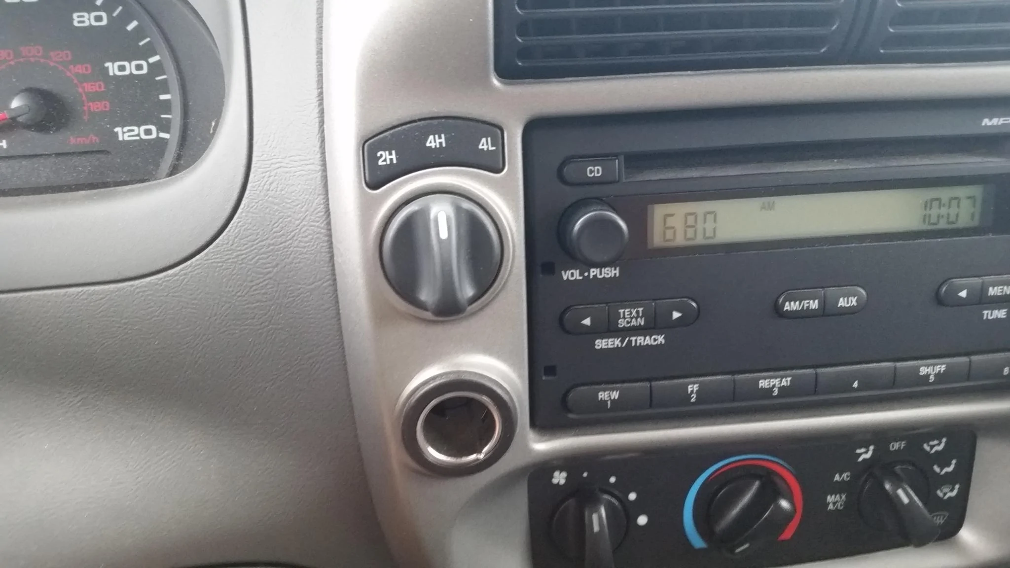

As anyone who has owned a part-time transfer case vehicle knows; it's perfectly OK to drive in 4H, for short periods of time, at moderate speeds, AS LONG AS YOU DON'T TURN!!!
I switch my 2010 Ranger into 4H all the time, in the rain, at stoplights, next to 2WD musclecars.
Pisses them off everdayumtime!!!

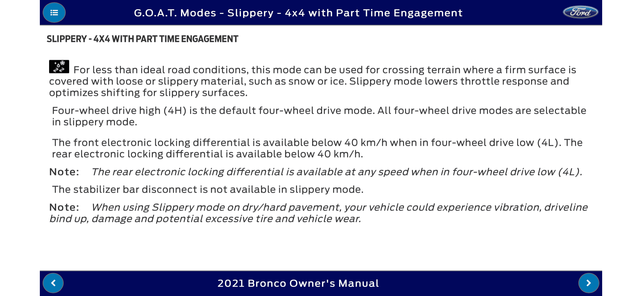

Thanks for your thorough explanation, what I meant about “fragile” was that there’s no warnings In the dashboard, if the system could explode by using it on pavement I would assume Ford would put a warning on the screen when you engage it, “4H is not intended for pavement driving” or something similar
an annoying warning for experts like you but not for novice idiots like me who didn’t read the whole manual before driving on heavy rain (and I am not being sarcastic I do feel like an idiot) but luckily nothing happened, felt weird a bit at slow speed and I disengaged it. Even the manual is not as dramatic about this, I would expect a bigger and/or a warranty void warning if this could happen.
“Do not use four-wheel drive high or four-wheel drive low mode on dry, hard surfaced roads. Doing so can produce excessive noise, increase tire wear and can damage driveline components. Four-wheel drive high or four-wheel drive low mode is only for use on consistently slippery or loose surfaces. Use of four-wheel drive low mode on these surfaces could produce some noise, such as occasional clunks, but should not damage driveline components.”
Thank you very much

Thanks for your thorough explanation, what I meant about “fragile” was that there’s no warnings In the dashboard, if the system could explode by using it on pavement I would assume Ford would put a warning when you engage it, an annoying warning for experts like you but not for novice idiots like me who didn’t read the whole manual before driving on heavy rain (and I am not being sarcastic I do feel like an idiot) but luckily nothing happened, felt weird a bit at slow speed and I disengaged it. Even the manual is not as dramatic about this, I would expect a bigger warning if this could happen.

Yes but the manual states “less than ideal conditions …such as snow or ice”
But I can imagine a lot of owners selecting it in the rain.
Anyways, lesson learned, nothing happened and I will leave it in normal, eco or sport even if it pours rain.

I can see that interpretation.
"Four-wheel drive high or four-wheel drive low mode is only for use on consistently slippery or loose surfaces."
I wouldn't consider wet roads "consistently slippery", though.
I agree, it is vague and you could interpret it either way especially as the first part focus on “DO NOT use 4WD drive on DRY hard surfaces” and rain is obviously not “dry”
Honestly I don’t think it is a big deal, even “GOAT’s slippery” engages 4WD, and there’s no warning just like the other modes, nor a max speed warning.
But good to know it is not intended for rain and you can really feel the jerkyness and braking feeling while turning a very low speed to realize it isn’t right.
