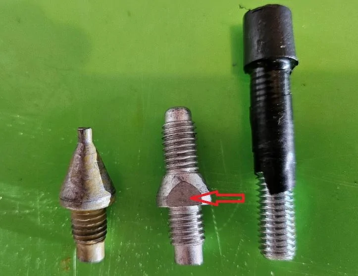

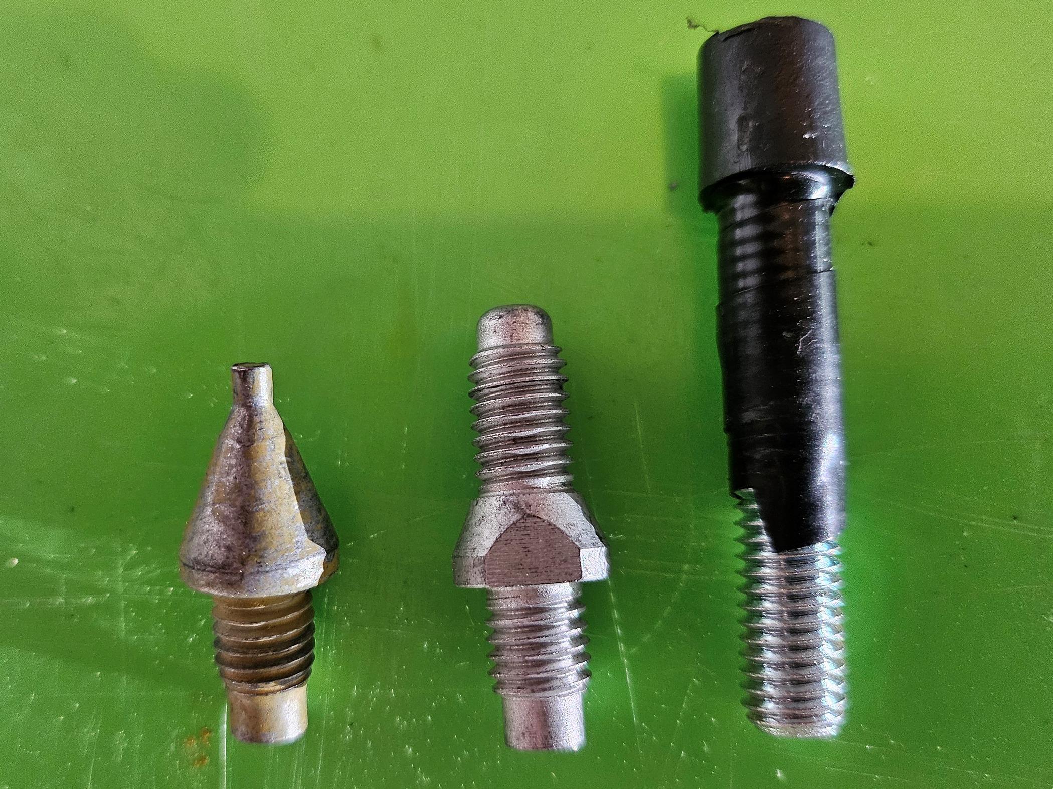

Just tested EZ pins. It works as advertised but I'll be returning since it doesn't really act as an elongated guide pin.
The exposed portion of the Ford pin is ~10/16. EZ pin is ~13/16. I don't think the additional 3/16 is going to help me much when struggling to align the front doors.
Regarding the clicking sound. I learned something today on that front. It's only the top hinge that makes that sound when there's a loose/missing bolt, so this product has no impact on the clicking.
Oh my...the Amazon pin is not that much longer than the original Bronco pin, so it seems like it won't really help! Thanks for the update! I guess I'm going to use the bolt system on the right!
AmbyMc
Dec 19, 2023
New England
2021 Badlands 4 Door
Thanks for that info.
So am I correct, that the middle Amazon pin flat area (see red arrow), is for tightening down the pin to the hinge, then you install the door, and tighten a nut down onto the threads of the pin to secure the door?

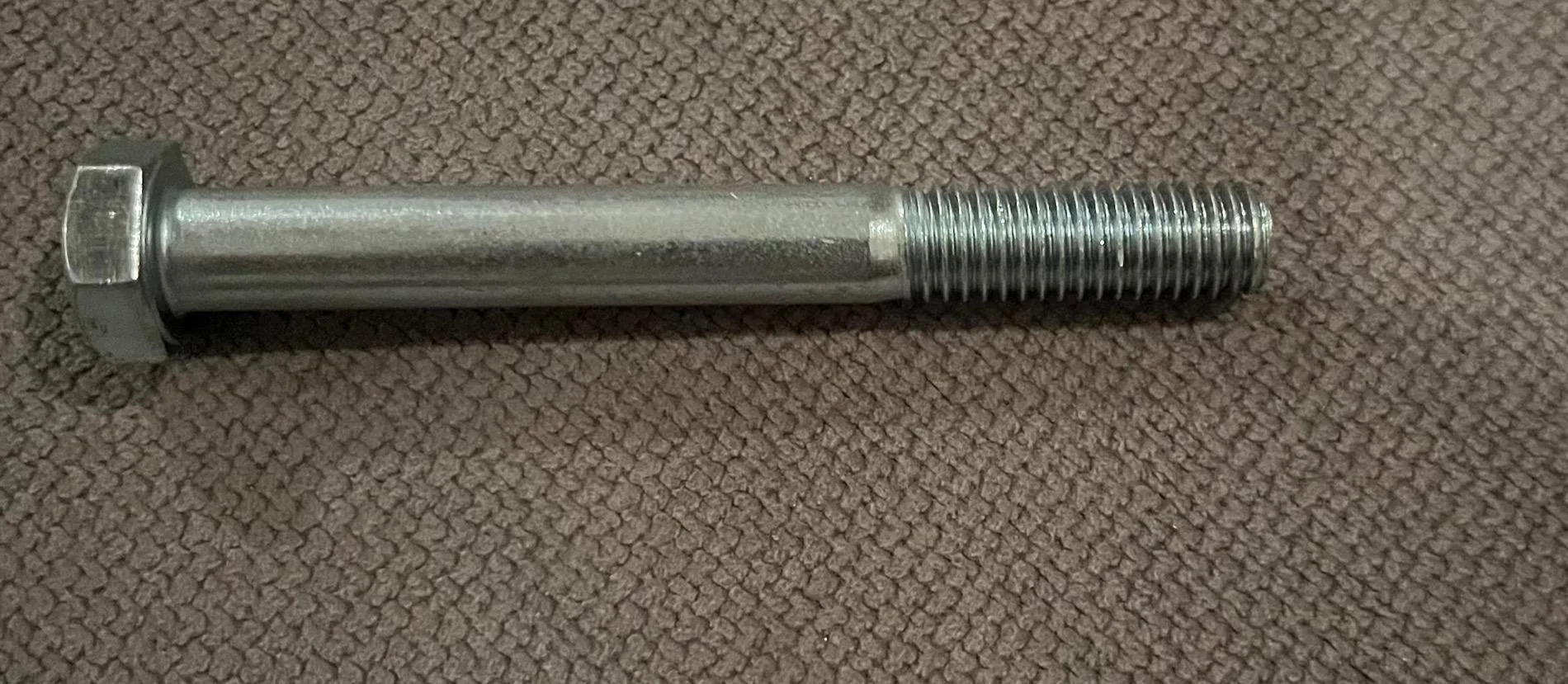

In that case, to have a longer "guide pin" portion as in your homemade approach, a nut (ground down a bit as needed) could be welded to a longer threaded bolt, to basically replicated the Amazon pin but longer?
Or, is it possible to install the door using your hex cap bolt approach, and then tighten your bolt down all the way, unto the hex cap portion secures the door to the hinge? Or does the hex bolt bottom out on something before you can tighten it down all the way?
Your description/questions on how the EZ 4x4 product works are correct.
Regarding creating your own version of the EZ product, could be fun/interesting to come up with something.
I think one of the keys is to make sure the door and body side hinge mating is not changed.
My solution is just acting as a guide pin, so like the Ford pin, you remove once the door is on safely. I never thought to reproduce what this EZ product offers. (I actually created my pin before the EZ product was even offered.) The black grommet top and electrical tape was added just to make it a bit easier to screw in/out. Not needed at all.
But your last paragraph is probably correct. I think talking off that black tape and cap, screwing into the door hinge until it hits bottom (and the bottom hinge is capped off) and then (when it's time to put door back on) using an M8x1.25 flange nut to secure door should work. I think.
I don't think I'm going to bother to investigate. I was just looking for an easier/safer way to get the door back on. Longer pin worked for me. Still need to use ford bolt for top hinge so I'll just continue to use the bottom bolt.
