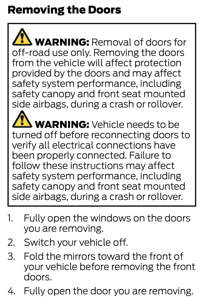

Hello,
When removing the doors should the ignition be in off or "half on" or "full on" position?
My first time coming up soon.
Thanks all!
TofuD
WarthogJr
Oct 15, 2020
637
2,843
'21 Bronco Black Diamond
I checked the owners manual. Page 339 helps. Looks like Off is the answer.
Ford Bronco Doors Off Question ignition off/acc/on ? IMG_4722
tofudrifter
Mar 26, 2023
145
160
Los Angeles
RAM
Thank you for the lookup!
I read a story somewhere.....they took off the doors in "half on" position and it drained the battery overnight.
