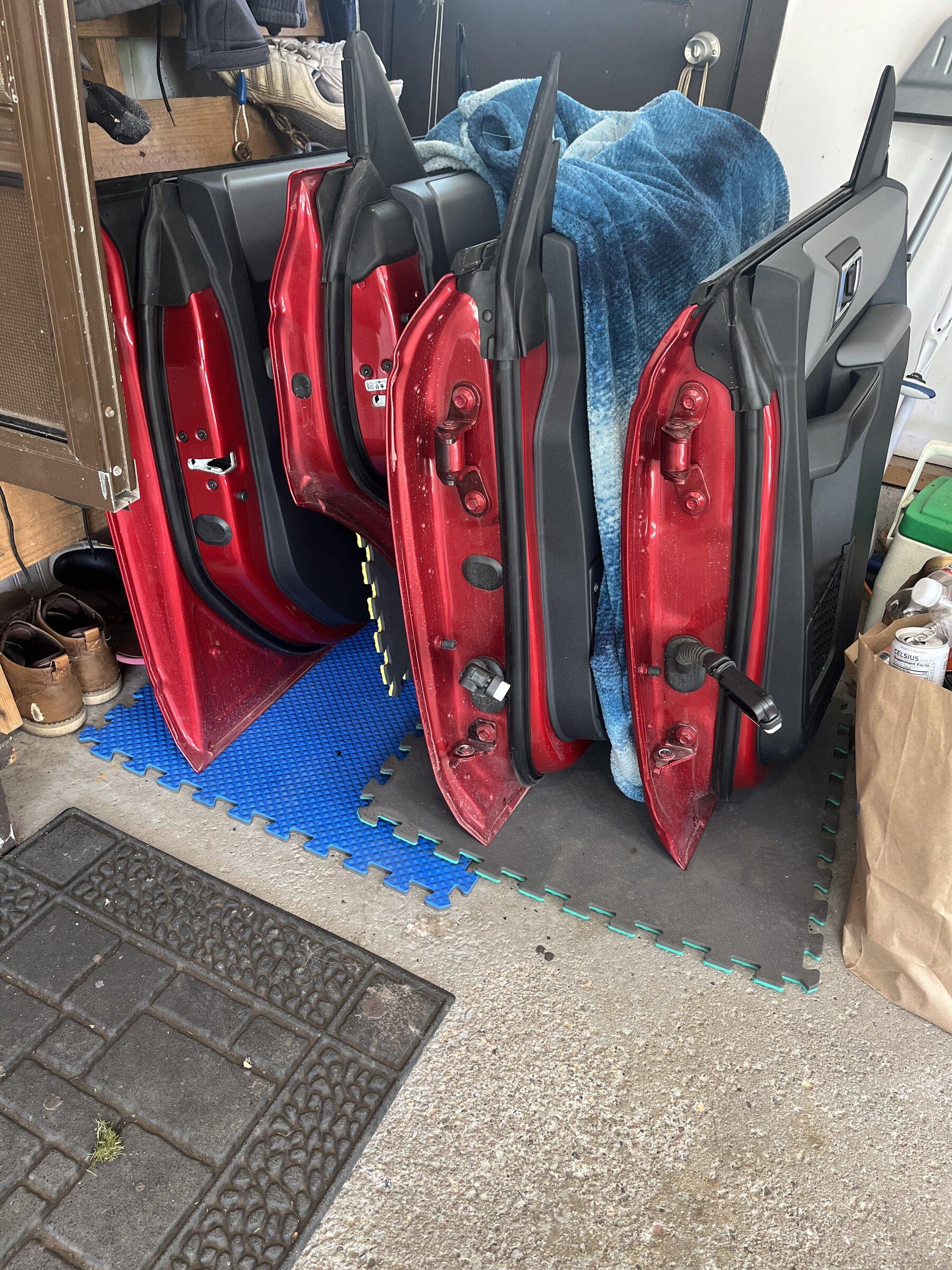

I found this Door holder idea on the inter webs for a Jeep and decided to utilize the plans for my 4 door bronco.
4 - 10' X1" PVC pipe
 schedule 40
6-1" pipe insulators
 (black foam)
14 - 1" PVC elbows
10 - 1" PVC TEEs
1 - Can of PVC cement
Cut the pipe into 10 - 2 foot sections,
 8 - 4 inch sections,
and the rest into 1 foot sections. use the images above to copy the assembly. Message me for more info if you have questions.

I'm very interested in a wall mounted option b/c space is so short in my garage... But not the $200 one on Etsy. I think like $80-$120 is a more reasonable price for that... Healthy profit but not losing sight of the fact that it's a small piece of metal with holes in it allowing the wall mount.. haha
I've been thinking about this last couple of days and my idea is a 2 part system with a strap, but it takes up a lot of wall space. I know I don't have the wall space for doors, really don't have the floor space either.
Think bike hooks and ceiling mounts...
Something like that, I was thinking like pictured with a "wall cleat" above it running a strap from the cleat to the bottom bracket to secure it.

I was looking at Harbor Freight Heavy Duty Ladder hooks. Fully vinyl coated, 50lb capacity (each), 7” open area which could be increased by mounting a 2’x4” first.
That said, as I am currently Raptor-less, I dont know how much the doors weigh or how thick they are. so this may be an exceedingly bad idea!
it will require a lot of wall real estate and a safety strap(s) to be rigged (What could go wrong??? Ha ha). 8 x $2.29 a hook, some lag bolts and 2 - 2”x4” (plus safety strap) and you’re done. And you can hang your ladder on it the other 300+ days a year

How much do the doors weigh? Front vs. rear?

I did this as well, added wheels to mine though.
It does take a lot of garage real estate, so I may be looking into a wall mounted storage option soon.
Great Idea I think using those HF dollies ... I want to do the same but something that holds the ROOF panels. !!!
