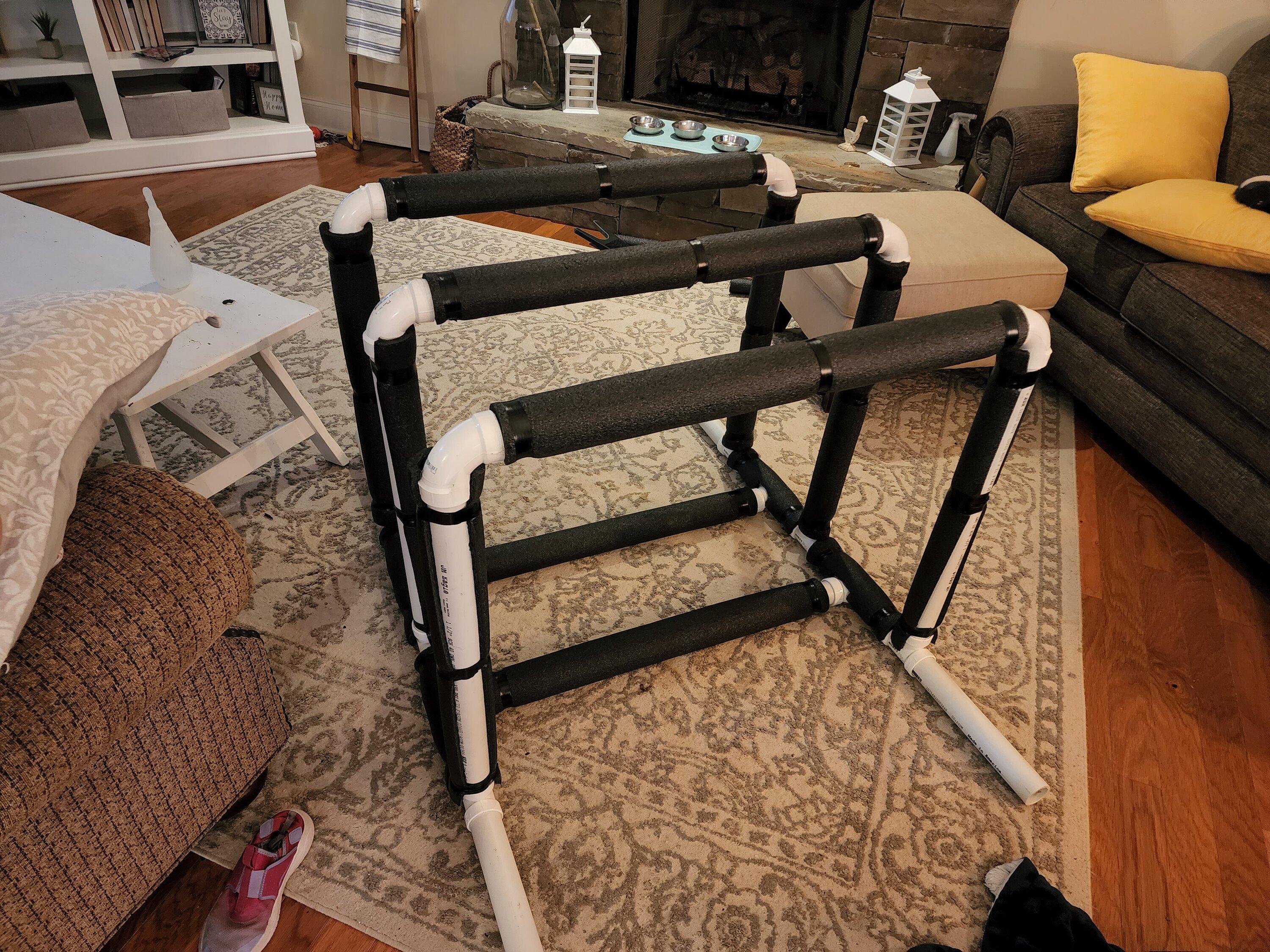

I found this Door holder idea on the inter webs for a Jeep and decided to utilize the plans for my 4 door bronco.
4 - 10' X1" PVC pipe
 schedule 40
6-1" pipe insulators
 (black foam)
14 - 1" PVC elbows
10 - 1" PVC TEEs
1 - Can of PVC cement
Cut the pipe into 10 - 2 foot sections,
 8 - 4 inch sections,
and the rest into 1 foot sections. use the images above to copy the assembly. Message me for more info if you have questions.

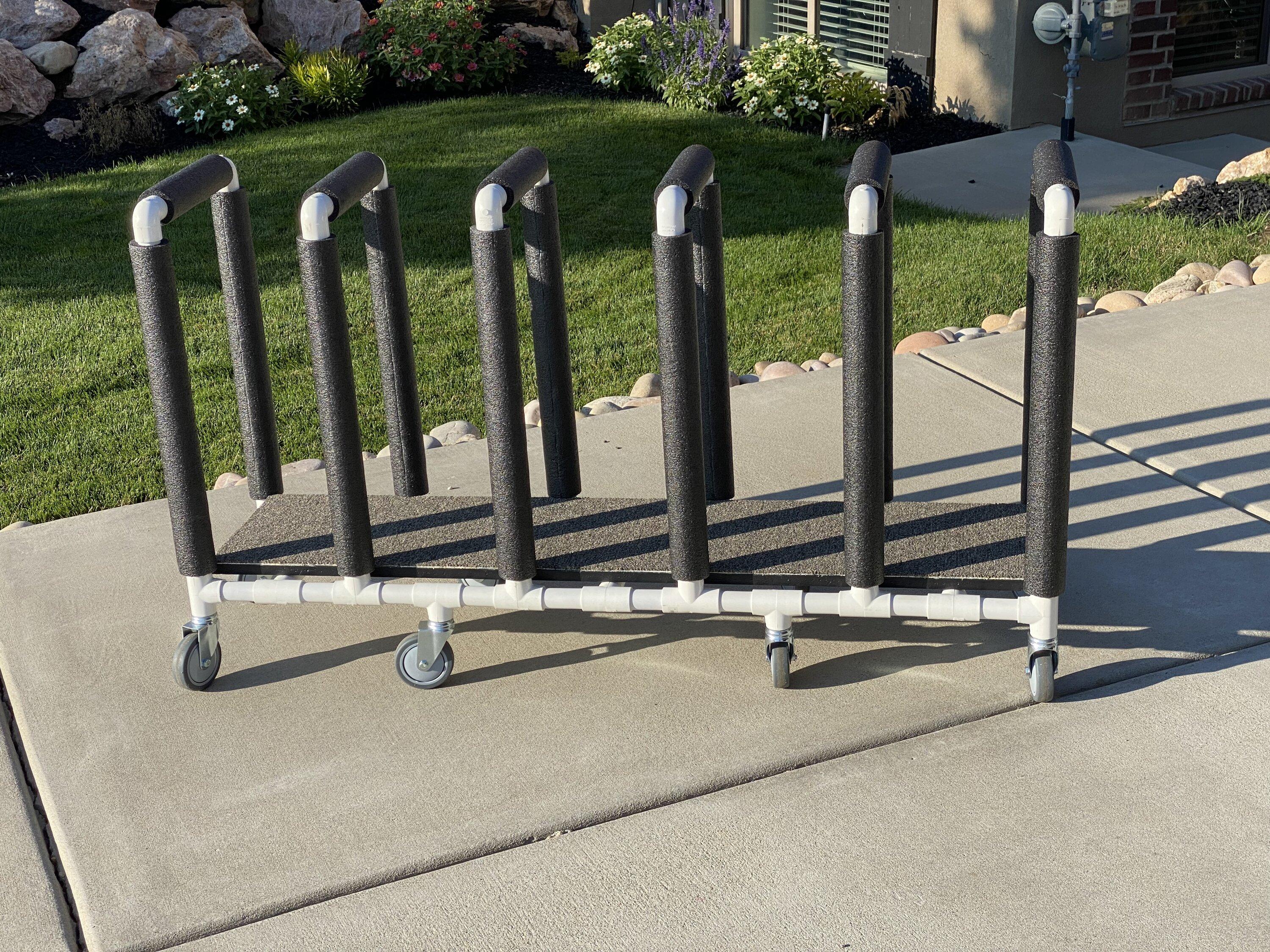

I forgot to post a pic of my completed Deeeluxe model with integrated casters and 5 slots (one for the hardtop center panel).
Ford Bronco Door Holders Using PVC Pipe -- When Off vehicle F99A2574-3B48-41FC-8FD4-715A61A65783

Thank you sir. Yeah, if I see any issues with how they're secured to the dollies, I'll figure out a way to bolt them down. But so far so good.

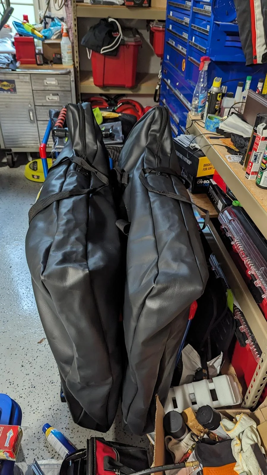

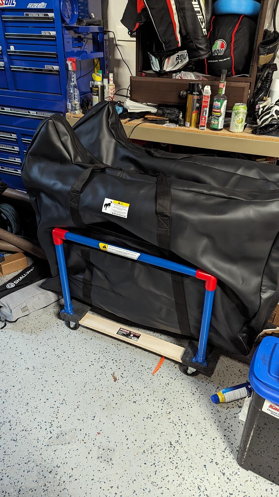

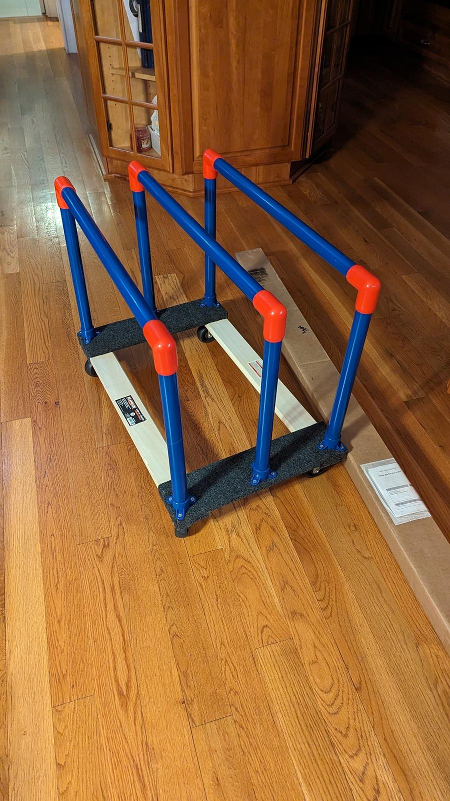

I made separate front/rear dollies for mine so that it would be easier to move around and keep the doors more protected within the confines of the PVC tubing. Trying to sort out how I want to incorporate my mid panel storage into my existing hoist setup. Excuse the mess in the garage.
