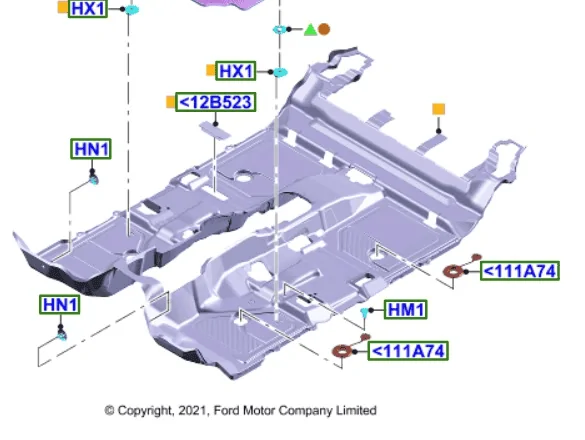

If it's anything like the wash out flooring, just remove the front seats, gear shifter/center console and you can lift the flooring right out. Not connected to the vehicle in any way, just sits in the tub.
I’m not sure you even have to remove the shifter or console on mine it only tucks under about an inch. The sill plates once you pop them up (they only have clips) have little hooks the carpet just slides off. The only big obstacle I see is the seats but once unbolted a person could rock them fire and aft to get the carpet out with our fully removing the seats. Myself would love to have a one piece floor liner removing seats in not an issue for me. It’s more important to be water resistant than easy to install. The slope to the drains and the drains itself would still be something I want.

No, you really don't. And for mine, I cut it anyways - that little flap that goes in front of the center console is pointless. Sliced right down the center and now facilitates quick removal if needed. I just slide each piece back up behind the center console in the foot well and it's never budged.
Taking the Seats out is quick and easy. 4 bolts and one electric connector under the seat for each front seat. Not even 5 minutes of time per seat.

Just looked it up, I believe it's M2DZ5413010AA, Ford Parts added a bunch of Bronco Parts to its catalog, it is pricey at over $1000 though

For others that are interested in the part numbers for the 2 and 4 door vinyl flooring:
4 Door Vinyl Floor - M2DZ-7813010-AA
2 Door Vinyl Floor - M2DZ-5413010-AA
Drain Plugs (identical on the 2 and 4 door) - M2DZ-78111A74-CA
