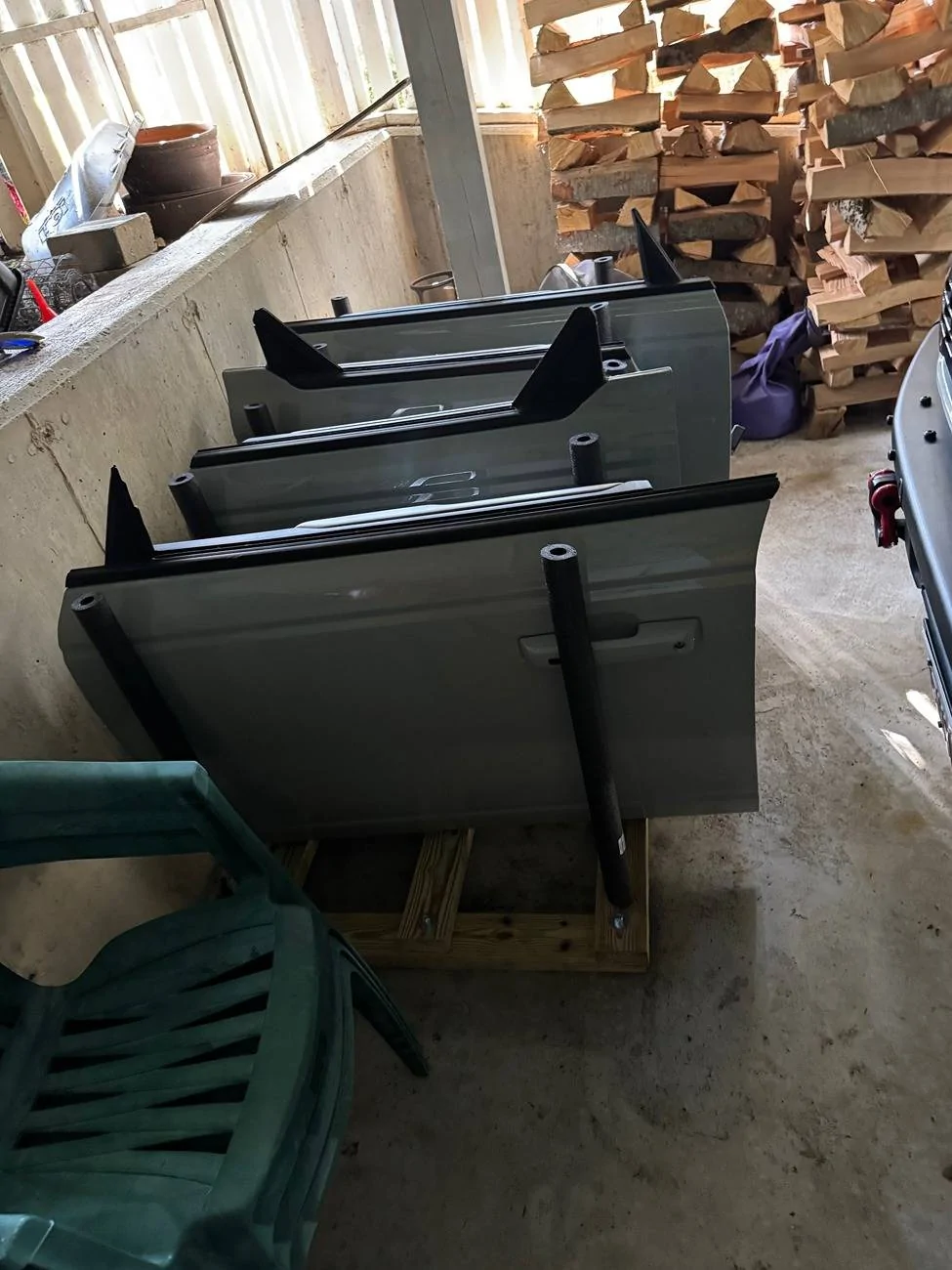

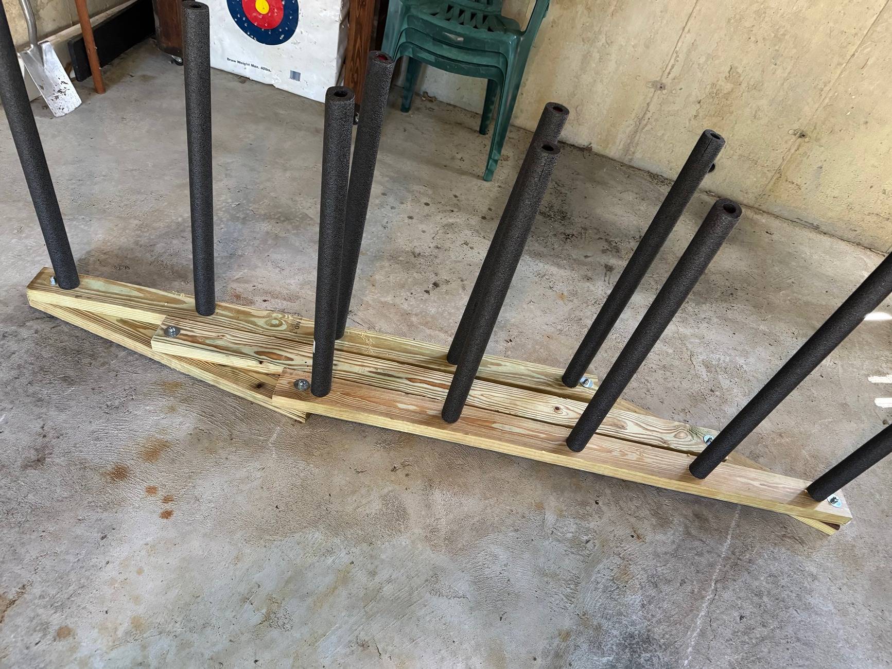

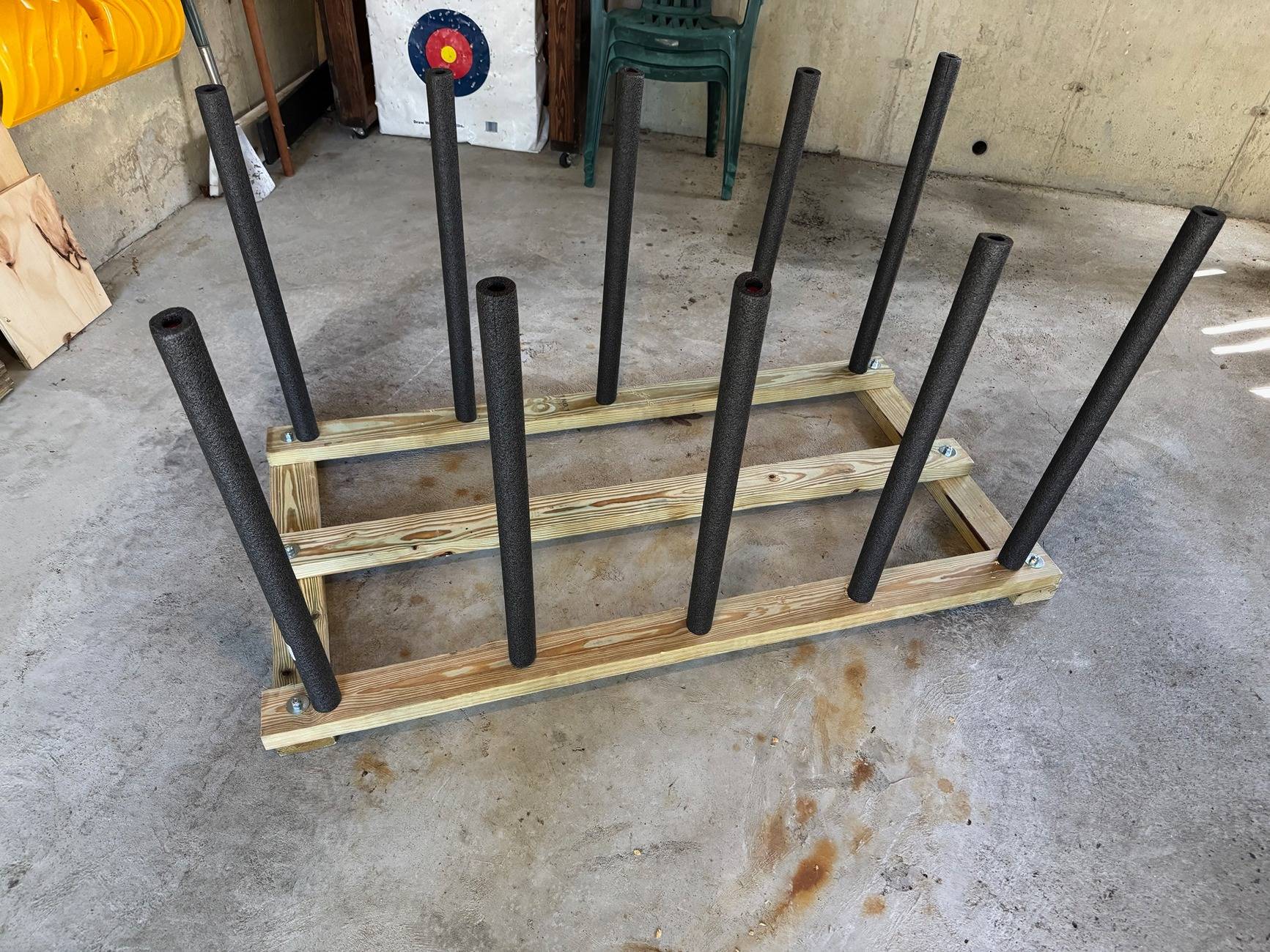

So this is not polished but simple, fast, cheap, and it works.
- 25' of 2x4
- 6 bolts w/ locking nuts
- 12 washers
- 10 30" sections of 1/2" ID steel pipe (w/ threaded ends)
- 5 pieces of pipe insulation
Cut to length, drill holes, insert bolts, screw pipes into place, add foam.

That's awesome. I'll have to make a half length one to store my 2 doors. Thank you.
For your 2door you would not need the center 2x4 (that is only there to support the shorter 2nd row doors). So yours would be much more compact.
