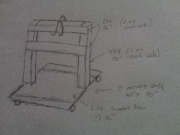

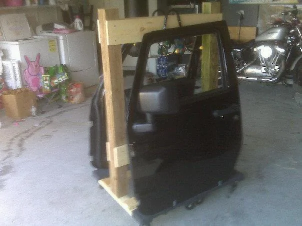

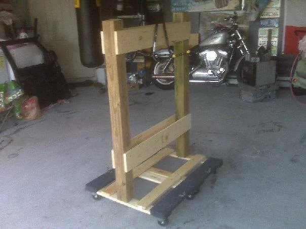

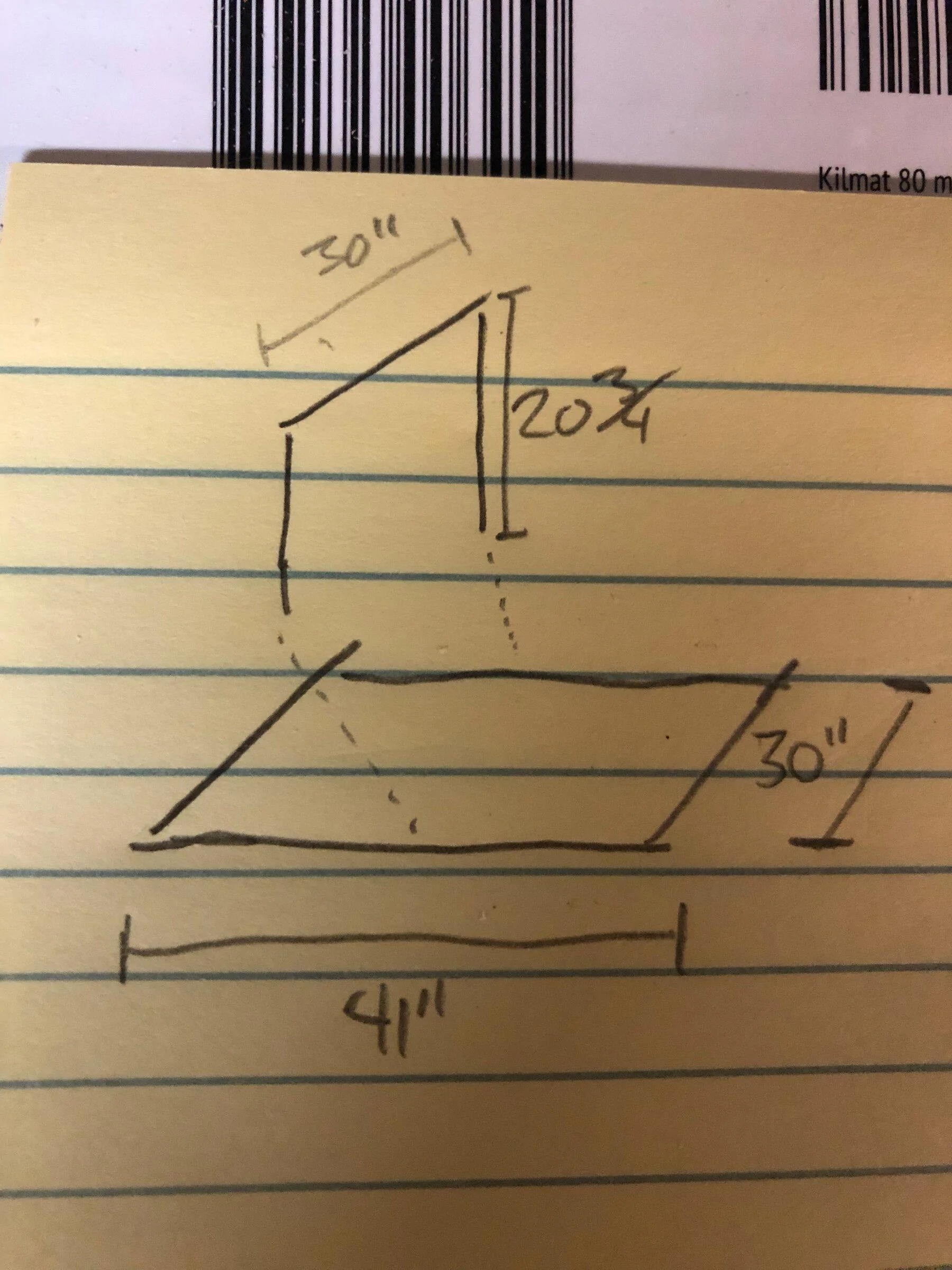

Made this for my Jeep years ago...planning on making another for the bronco. Here’s what it looked like, hope it helps you guys...

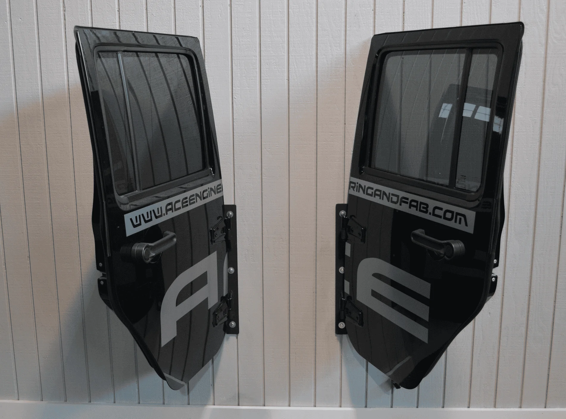

I love these in theory, but are door hinges designed to continously support the weight this way? I imagine the added support of the latch on the handle side helps prevent sag. Could this have long term effects on fit?
Just a thought
On my jeep doors, I actually have the door latch mounted to the wall as well, so they're supported by the 2 door pins and the latch which is how they hang in the jeep. The bigger problem at least with older jeeps is hanging them from the actual window frame which causes cracking of welds down where the frame meets the window seal.

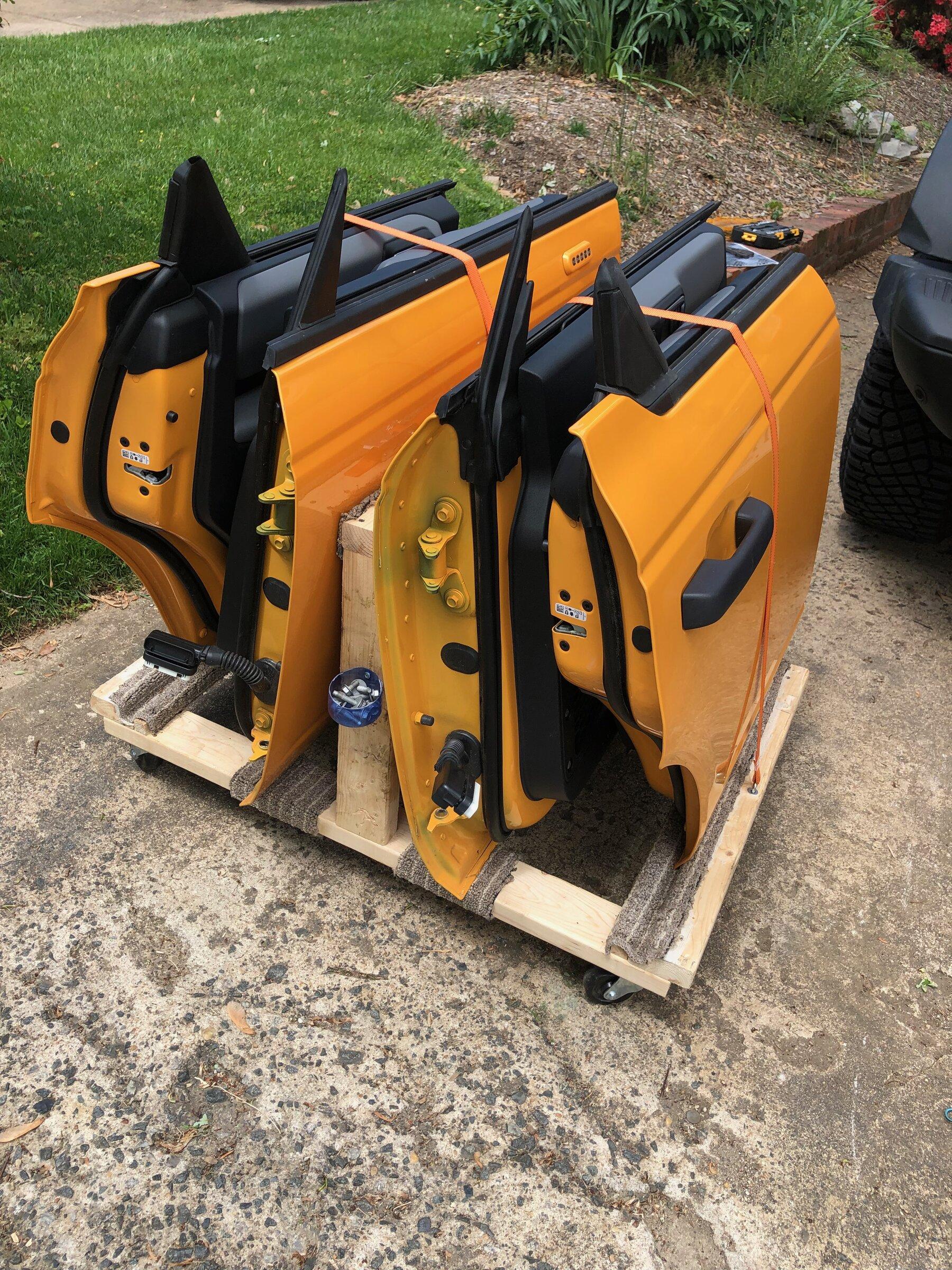

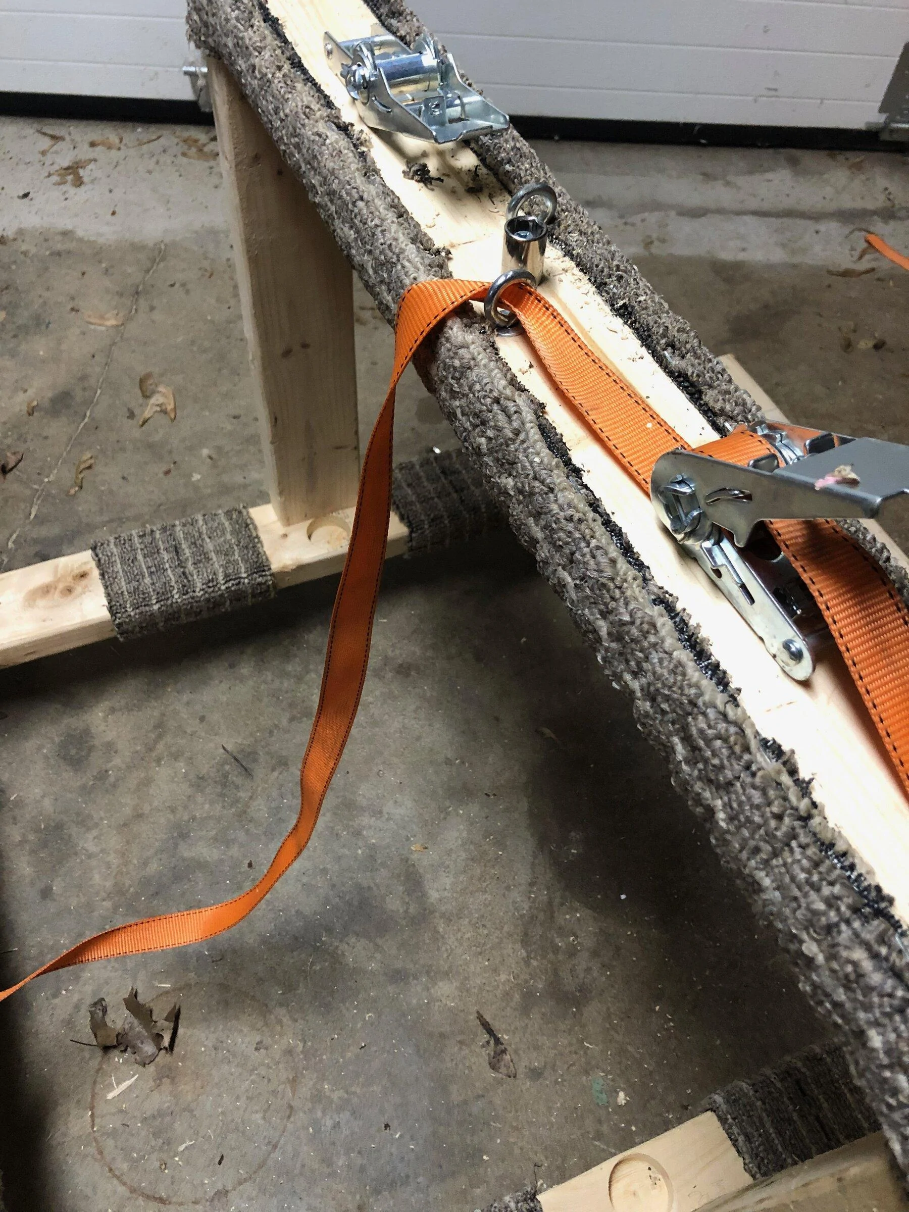

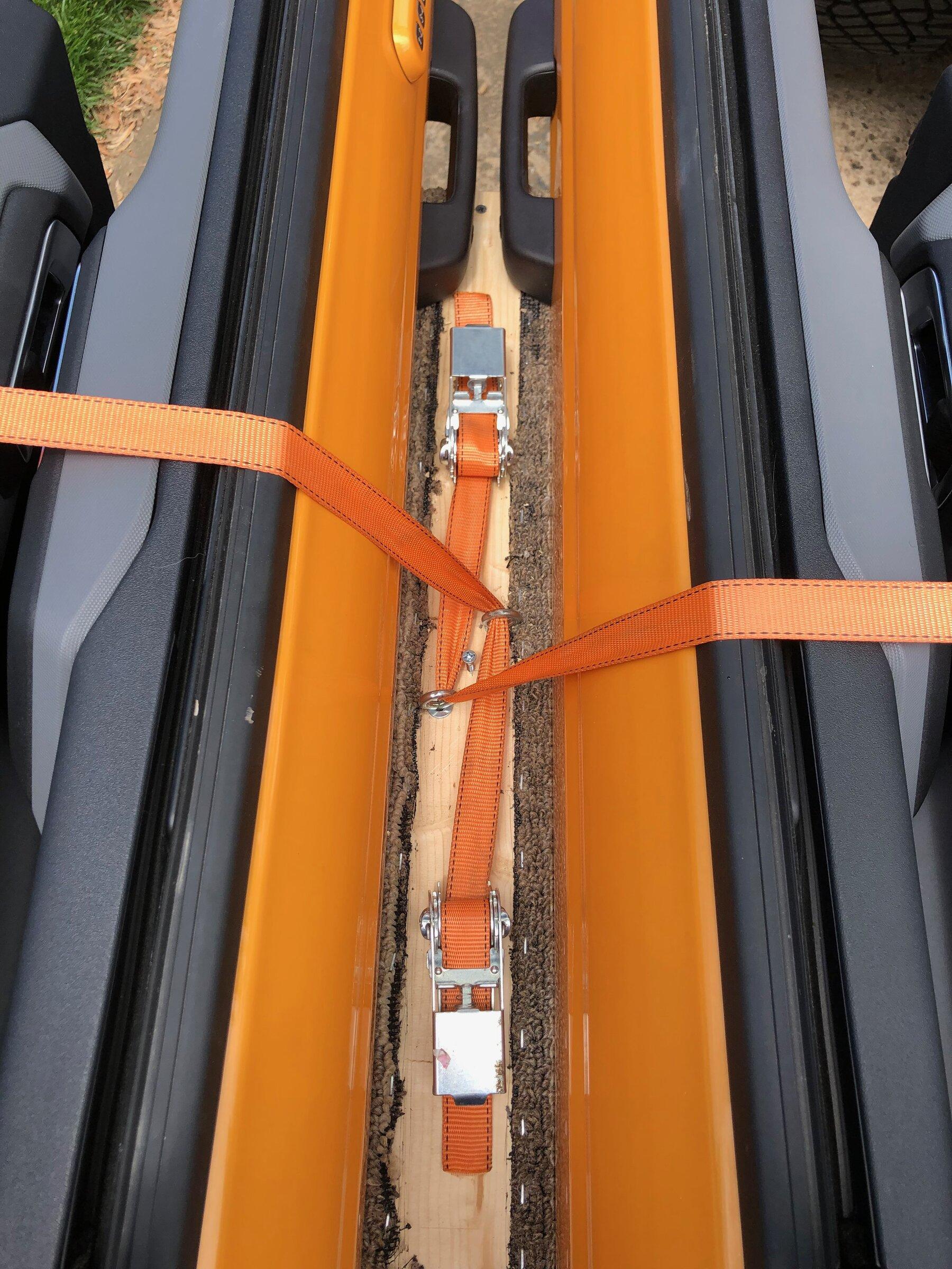

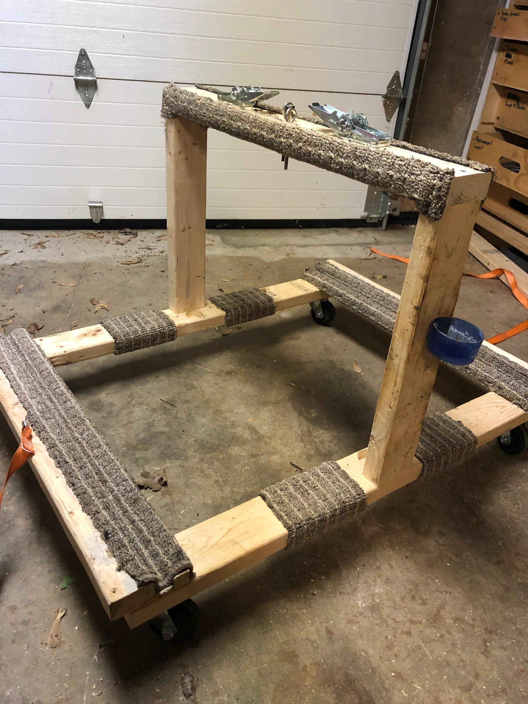

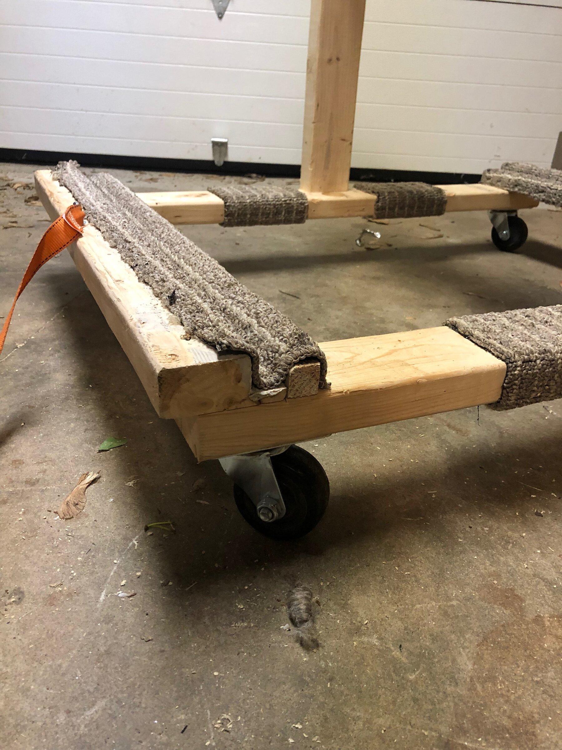

Just came up with this door cart a couple days ago because I felt like I was playing Russian roulette with my paint job every time I took them off. Its very sturdy and easy to push around. I put a couple things on there the jeep guys didn't think about. The ratchet straps are screwed directly to the top 2x4 (the hooks have been removed), so the doors can be held secure without having the metal parts rubbing on the paint. I also cut a grove in the outer 2x4s to hold the rear doors on better. The front doors go on first, paint facing toward the center, then the back doors go on plastic to plastic with the paint facing out.
