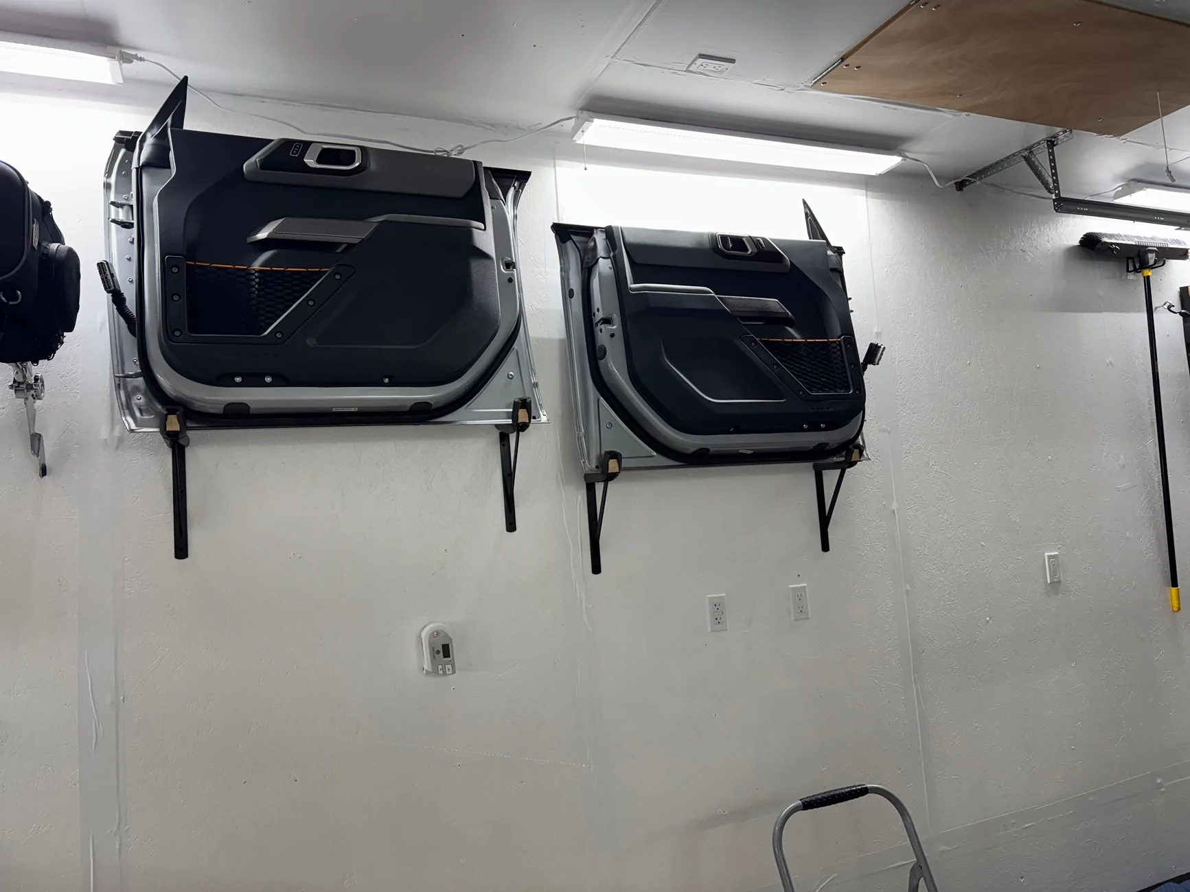

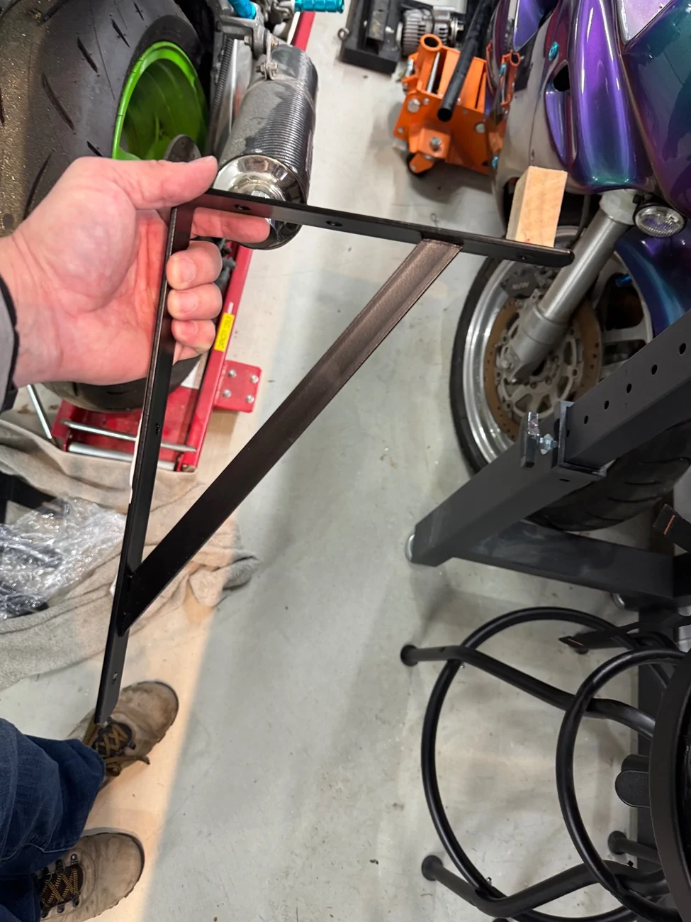

Parts:
8 shelf brackets
1x3/4 strip of wood
Pipe insulation

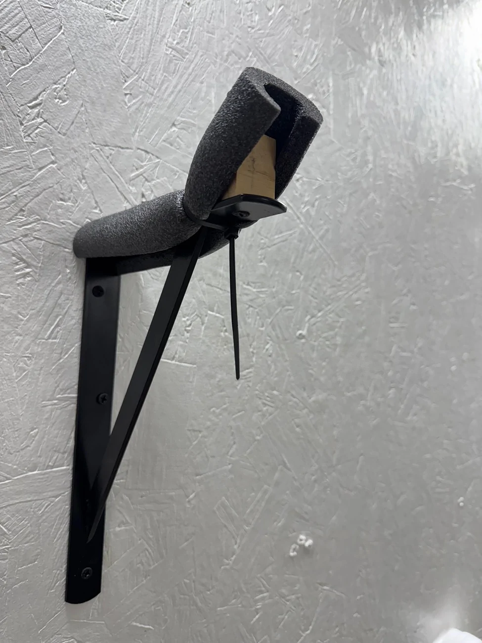

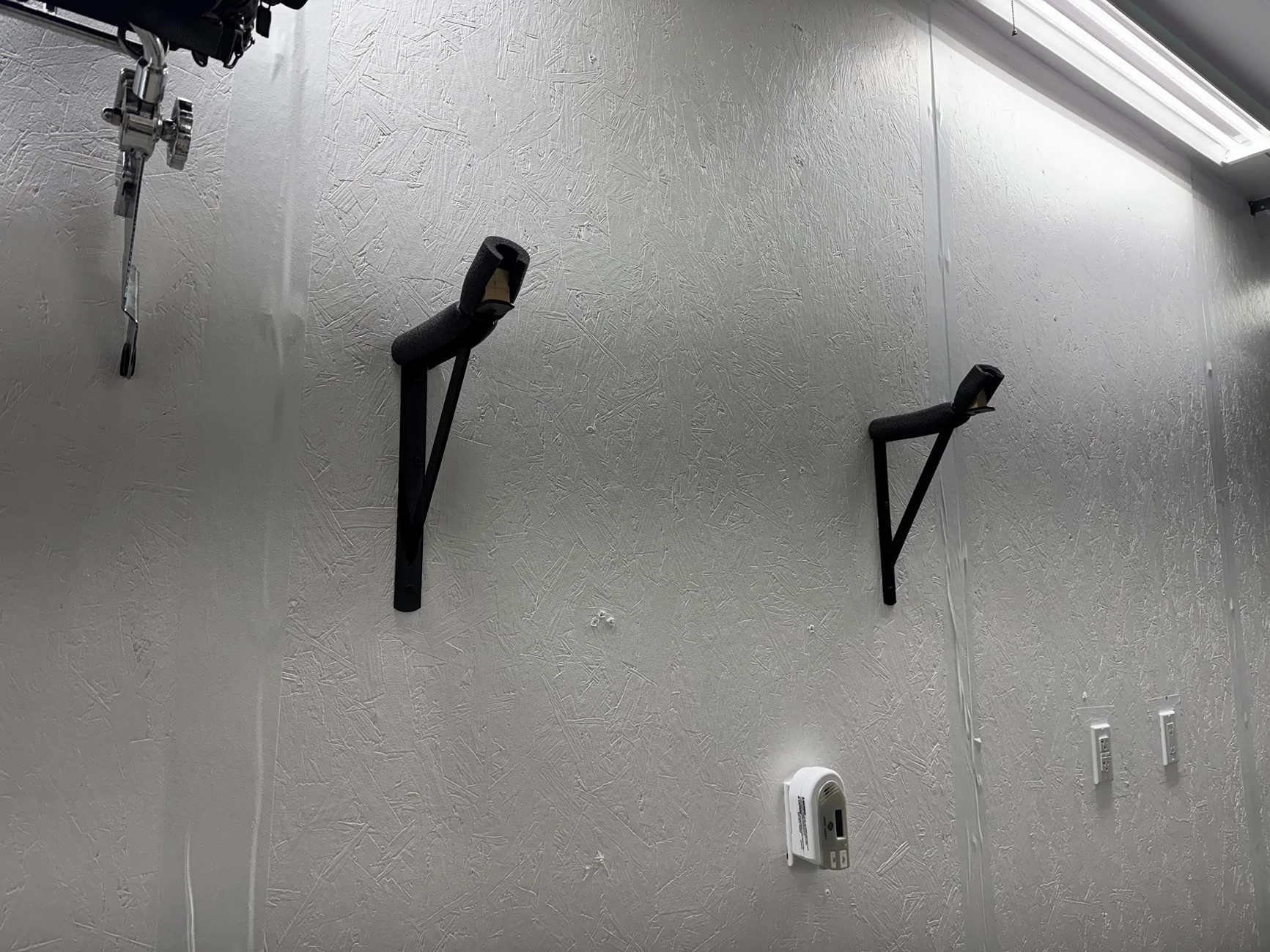

The shelf brackets were the most expensive part, they were around five bucks each at Walmart.

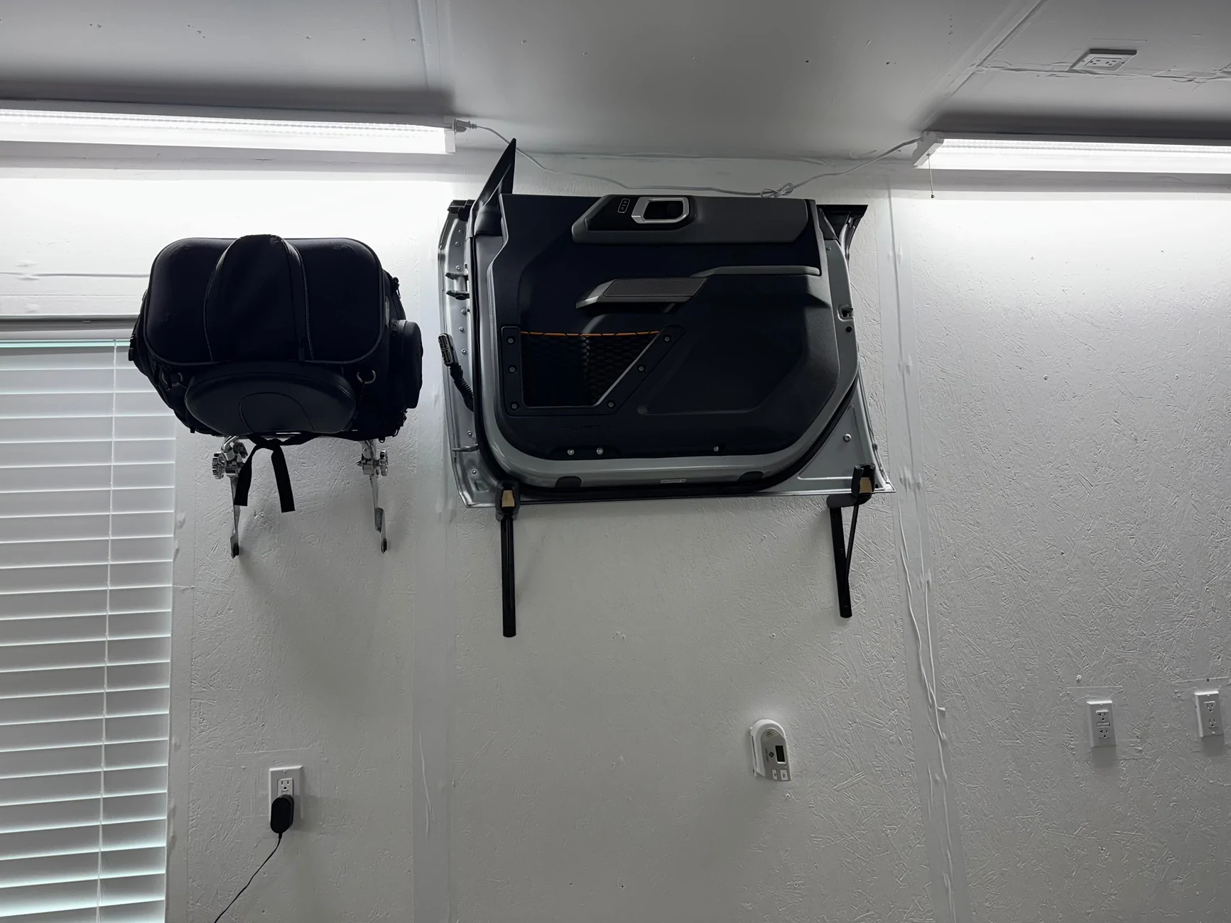

I just put a chunk of wood on the end of each bracket to hold the bottom of the door in place, then mounted the brackets on the wall with the longer part facing down rather than how you would normally mount them for shelves.
Put the pipe insulation over it, with a quick zip tie to hold it in place and done:
Ford Bronco My cheap DIY door storage! IMG_8634

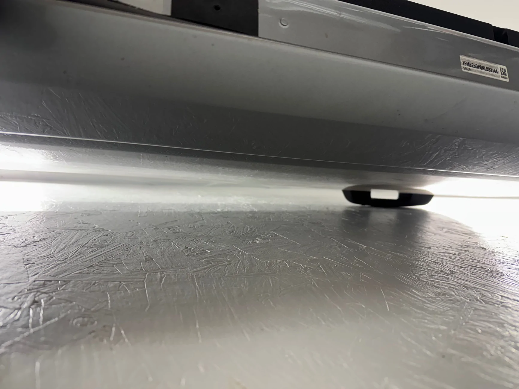

Ford Bronco My cheap DIY door storage! IMG_8635
Ford Bronco My cheap DIY door storage! IMG_8640
Ford Bronco My cheap DIY door storage! IMG_8641
not shown is that I put eye bolts on each side and secured with a strap so they can’t fall forward!

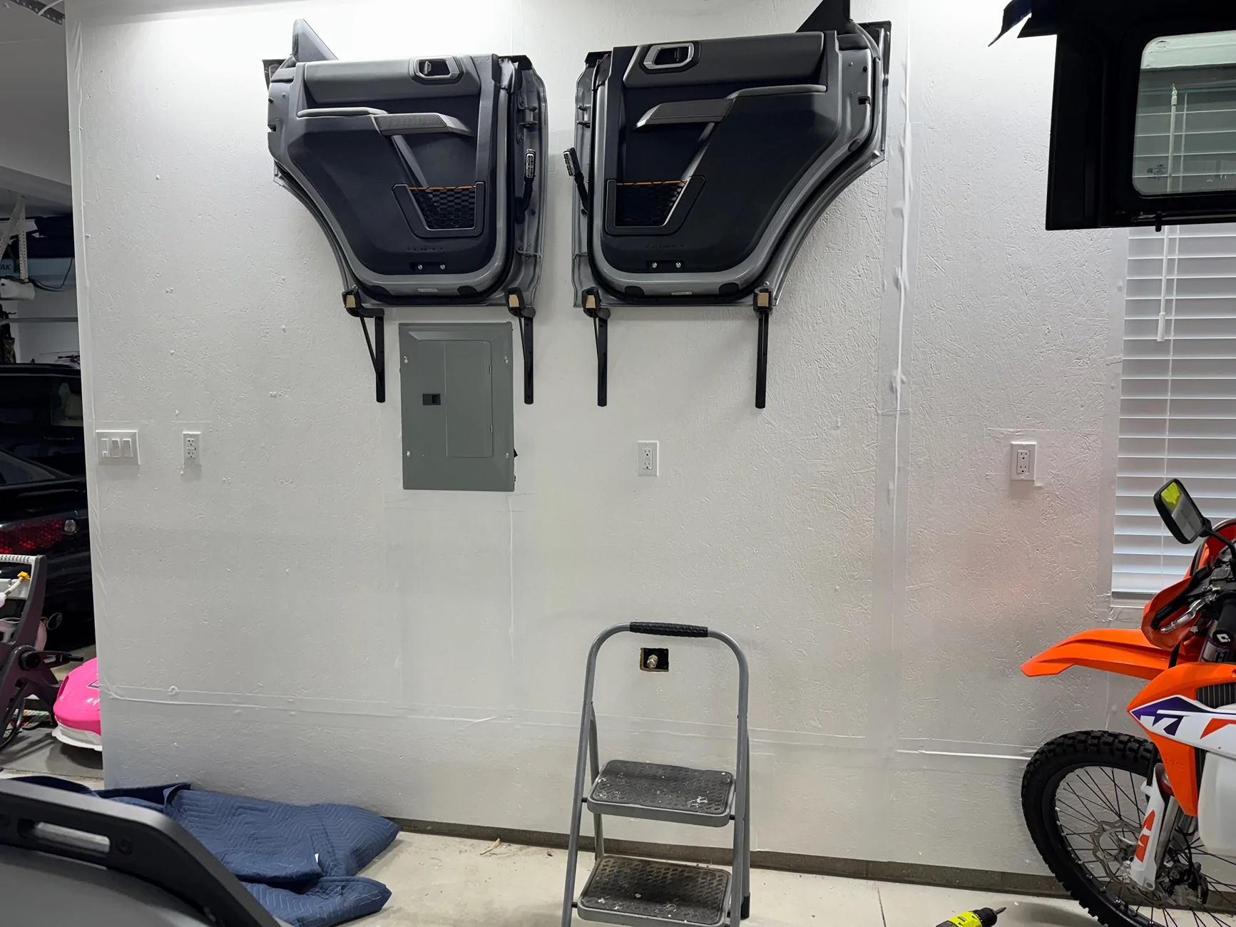

Ford Bronco My cheap DIY door storage! IMG_8637
Ford Bronco My cheap DIY door storage! IMG_8636

I would store them in the padded bags to prevent the wall from scratching the paint.
they aren’t touching the wall - only the handles touch and mine aren’t painted ;)
