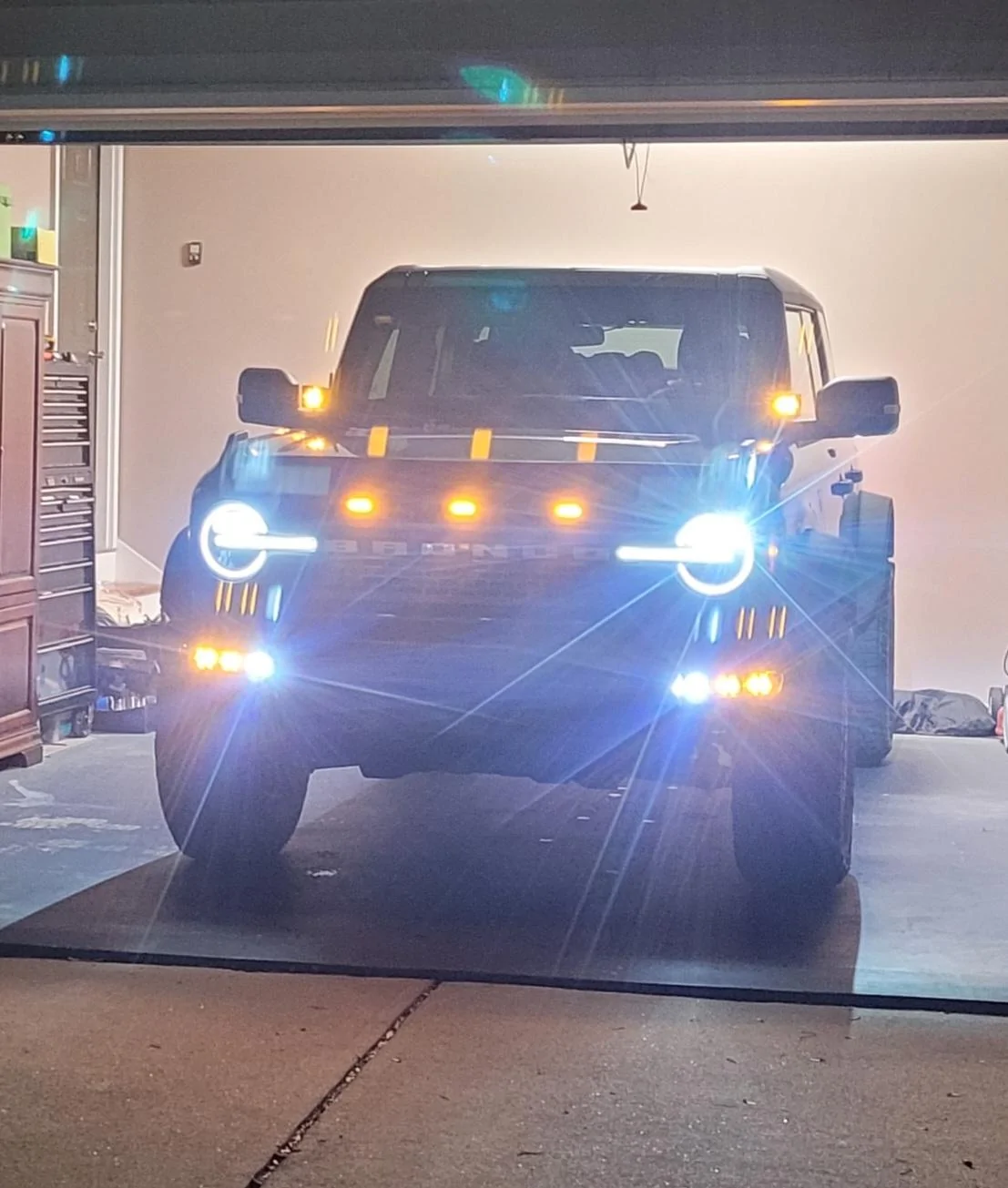

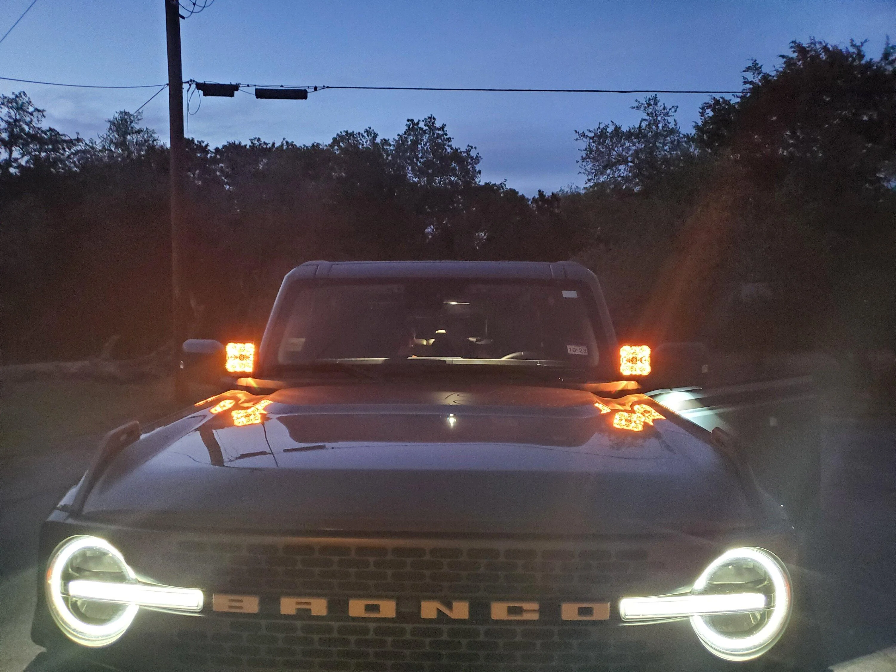

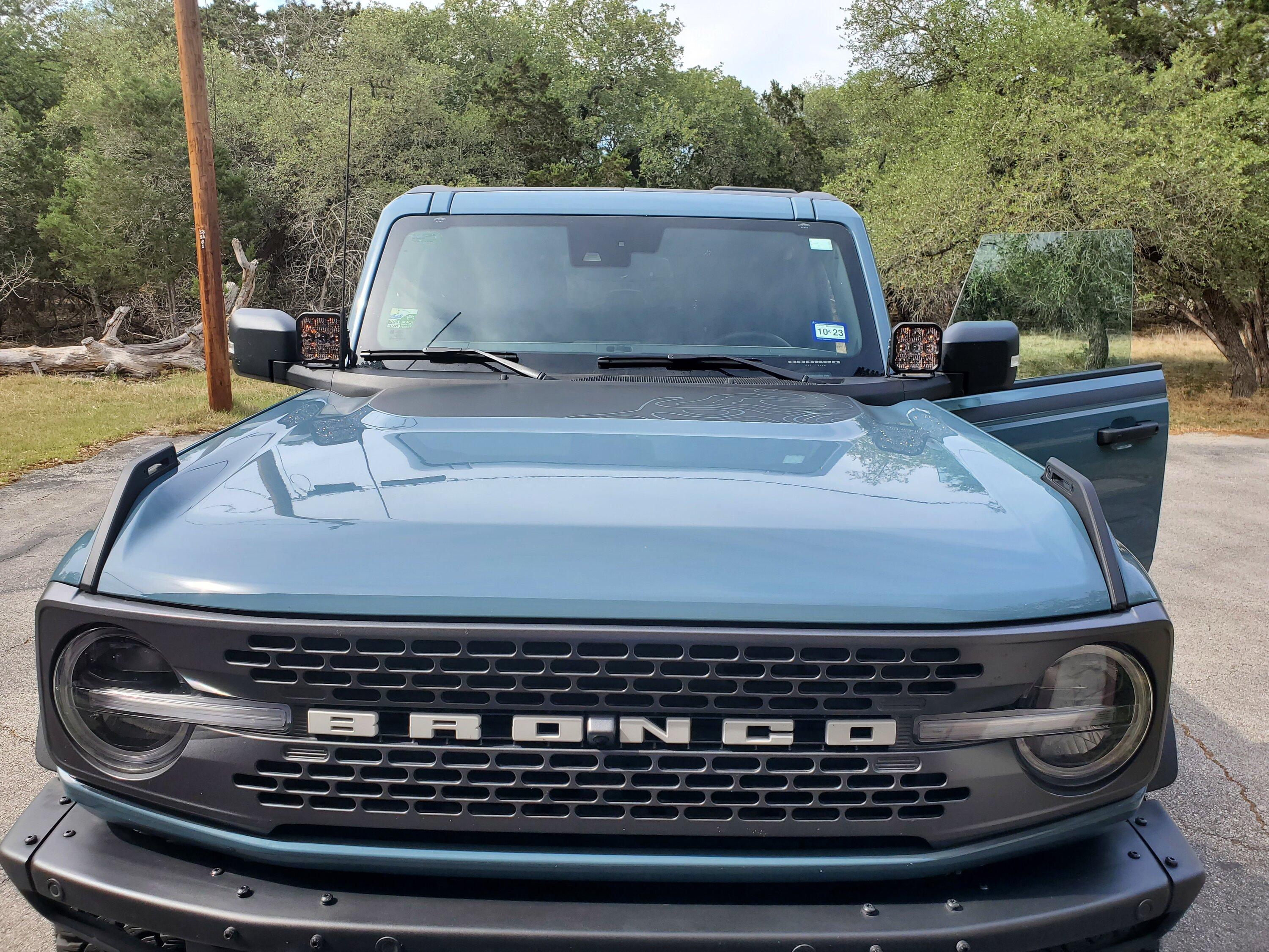

d

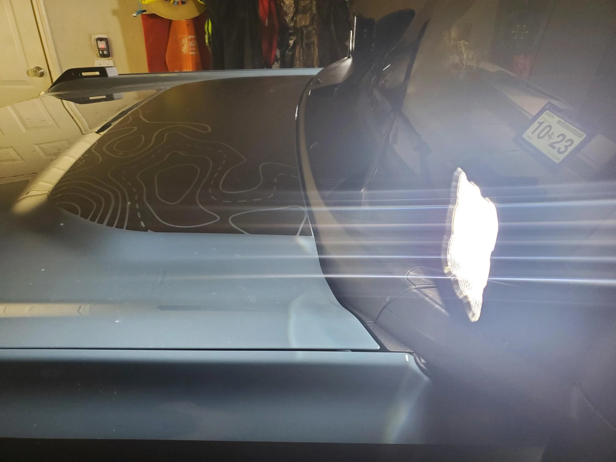

Daytime pic:

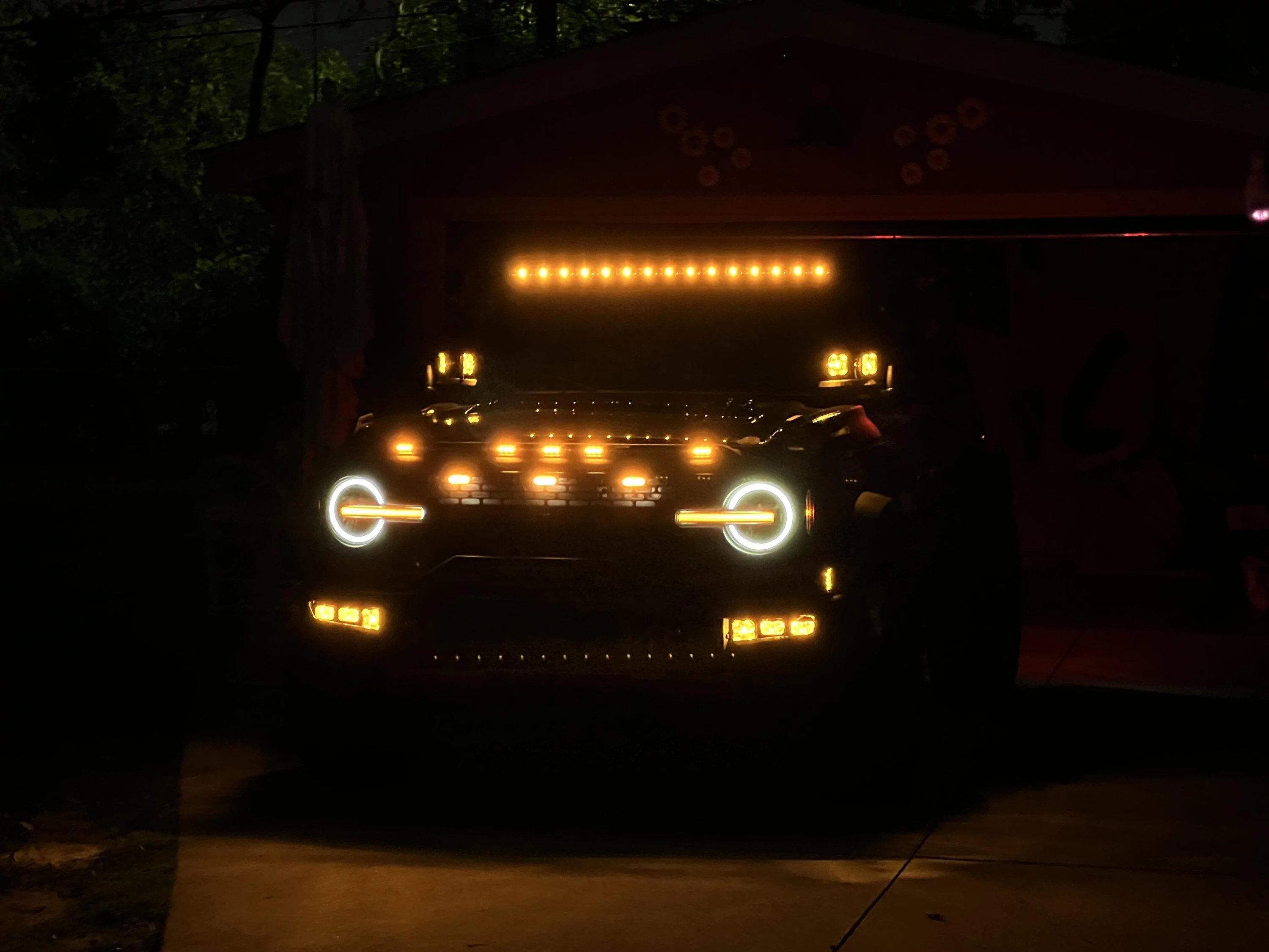

dusk picture with backlit amber on:

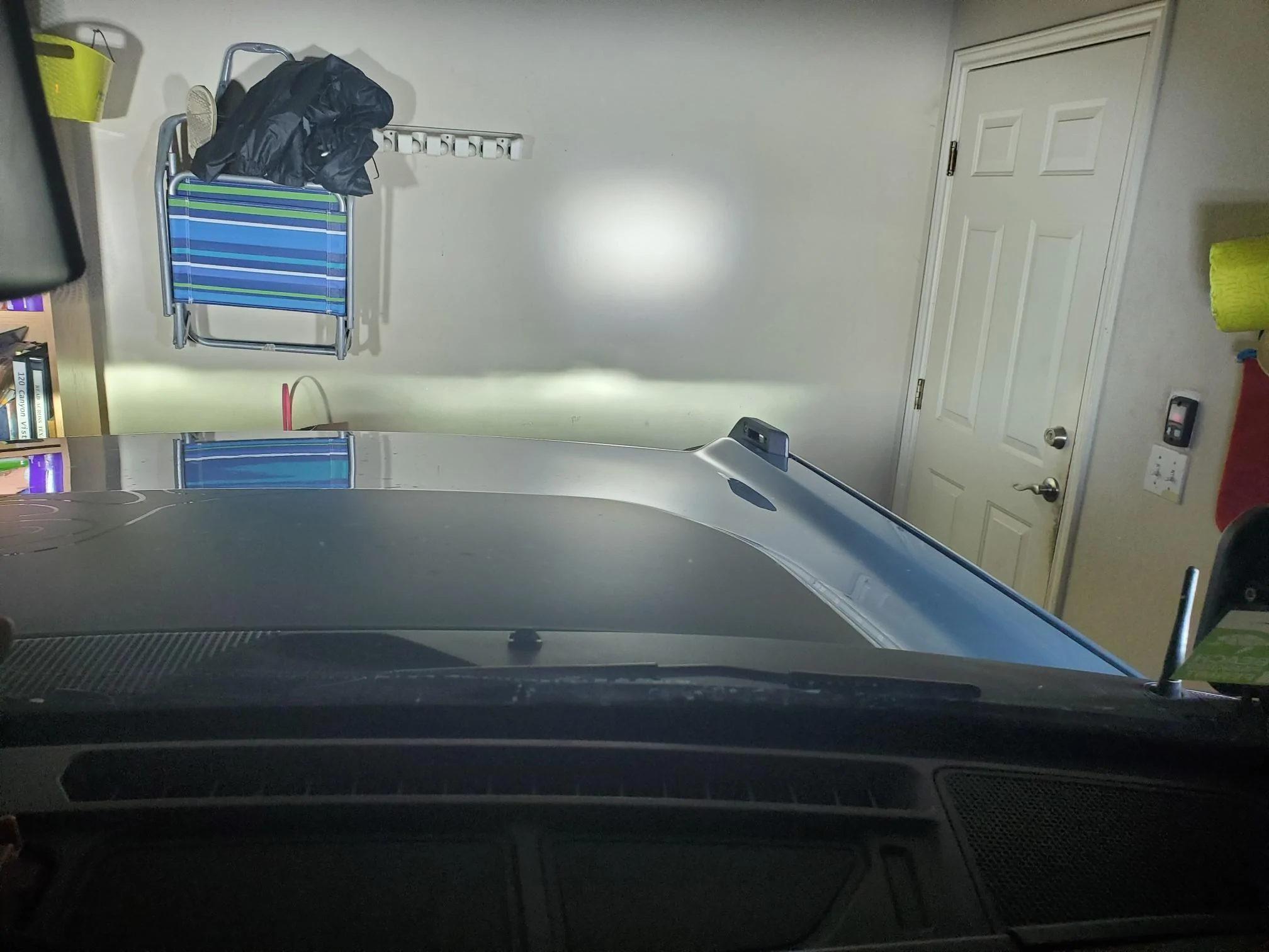

Just took these pictures inside the garage so not best:
I will also add this:
I had the SS3 Pro before these SS5 Sports. Both are the combo pattern and I feel the SS3 might of shined slightly farther (My guess is due to being the Pro) but the SS5 broadcast lighting for up-close (my guess is due to having more LEDs with the SS5). Overall I'm happy with the SS5. Depending on what comes next year with the Laser lights, I might change them out again.

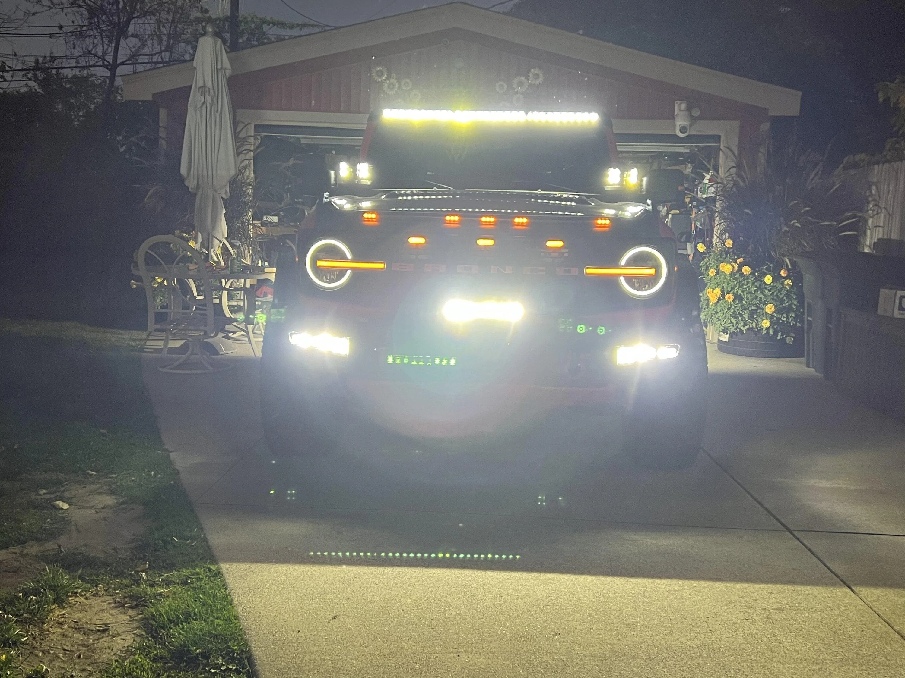

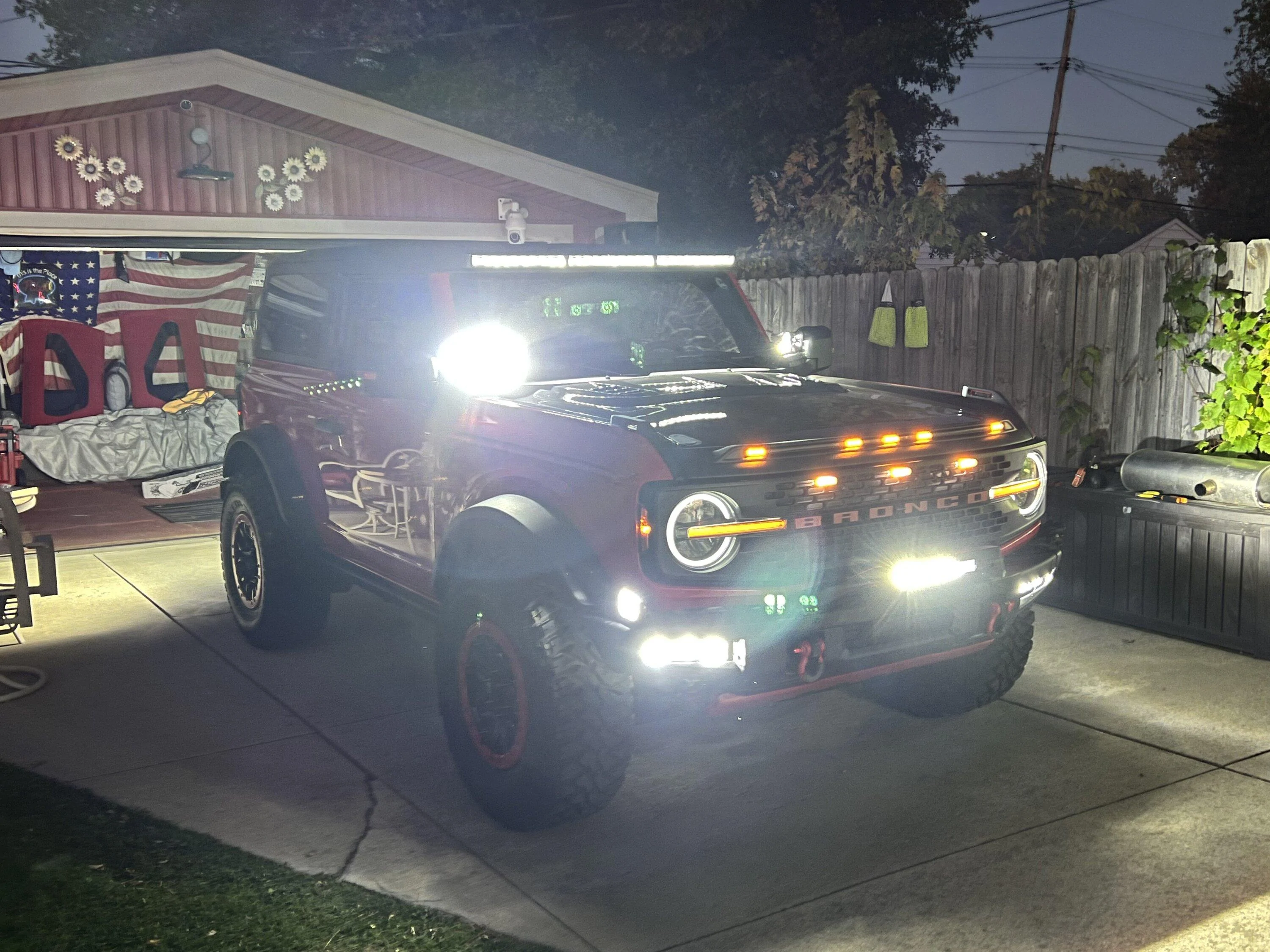

When I had my first set (ss3) I left them a hair loose on the bracket. Just mounted with the existing bolt. That let me reach out to adjust them while using them. Then I just decided to put lights on the whole truck. Now 2 switch flips and I light up a half mile in front and 1/4 mile around the sides.

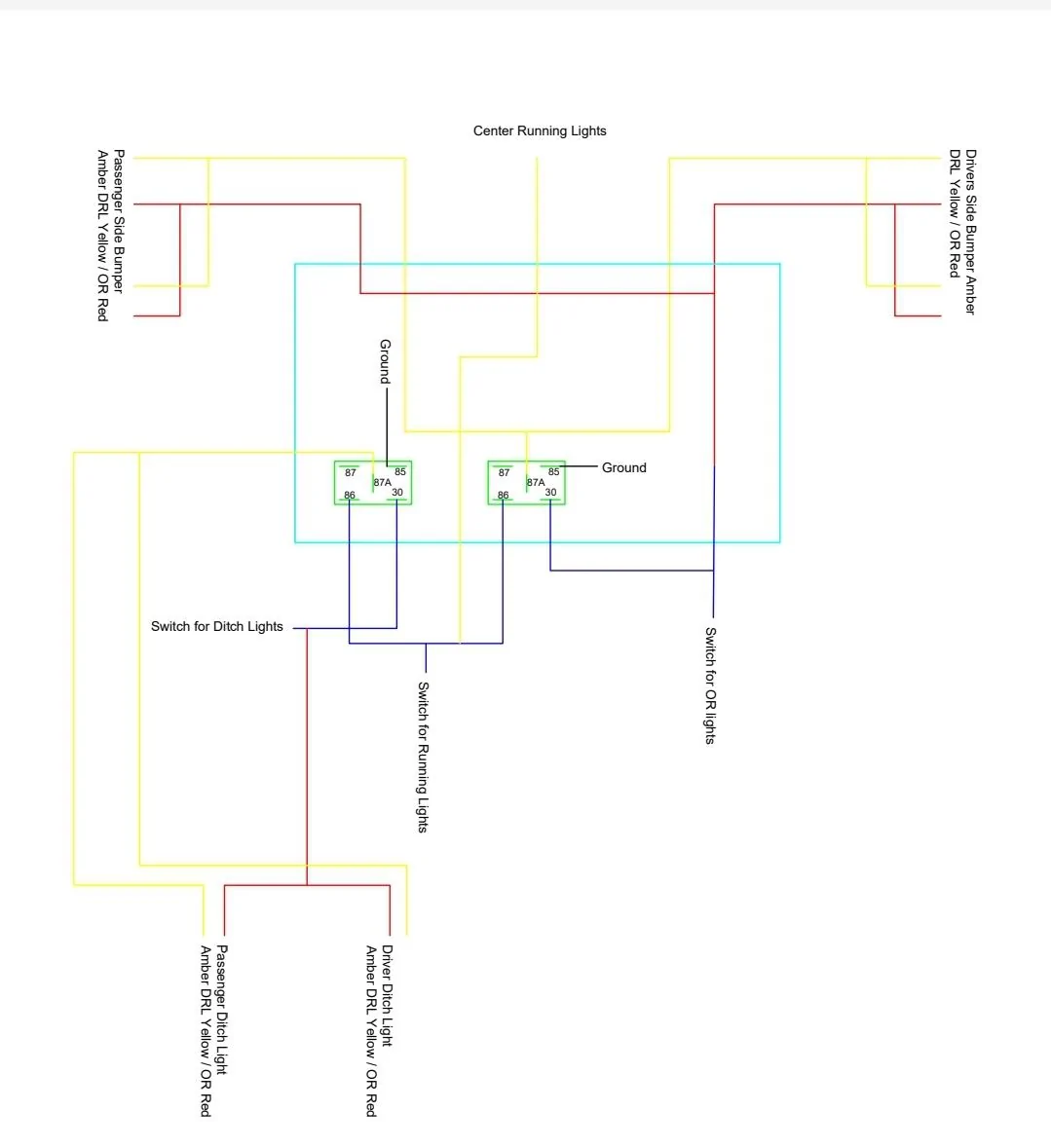

Here is the wiring in order to have the amber drls turn off when off road lights are turned on. Mistakenly swapped labels on 30 and 86 but with that minor change this will do the trick. Used switch 6, 5, 4 and 3.
