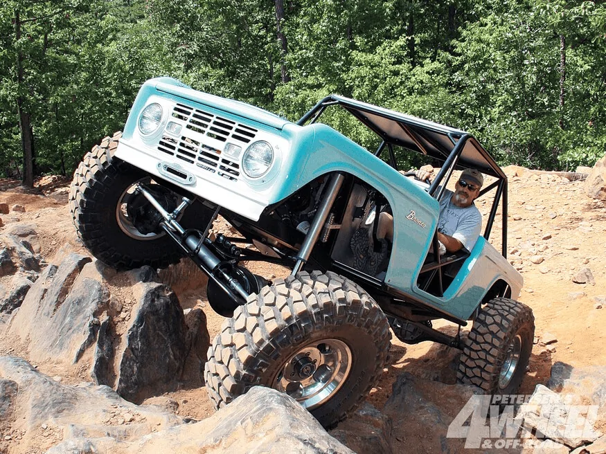

Have you thought of one of these? Skip the bells and whistles and safety features and just worry about wheelin' and rollin'.

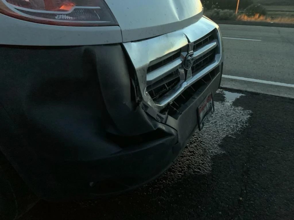

Be careful getting complacent about airbags needing a hard collision to go off. This is my buddy's brand new van. Hit a small deer and sprung ALL of the bags, front and sides, that bumper is the extent of the collision damage.
Just educate yourself on how to re-set the truck so it is operable.
I have wheel my Land Rover hard enough to trip the fuel inertia switch but never poped an air bag.
Another thing to consider is some airbags sensors read the angle of lean not necessarily impact alone. If you are on your side or upside-down in gear your likely have an issue.

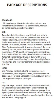

It saddens me to say this, but you (and me) should avoid the MID package. It comes with the Co-Pilot 360 with pre-collision assist, automatic emergency braking and lane-keeping system. None of those items need to be on a vehicle that goes off-road. I don't trust the systems enough or even know if they can be disabled 100%, so I'd prefer not to have them at all.
Yea, but then the winch screws all that up anyway since it blocks cameras and censors... The packages are a disaster. Should have been à la carte.
All that stuff is waisted on someone like me. I will never use it.
