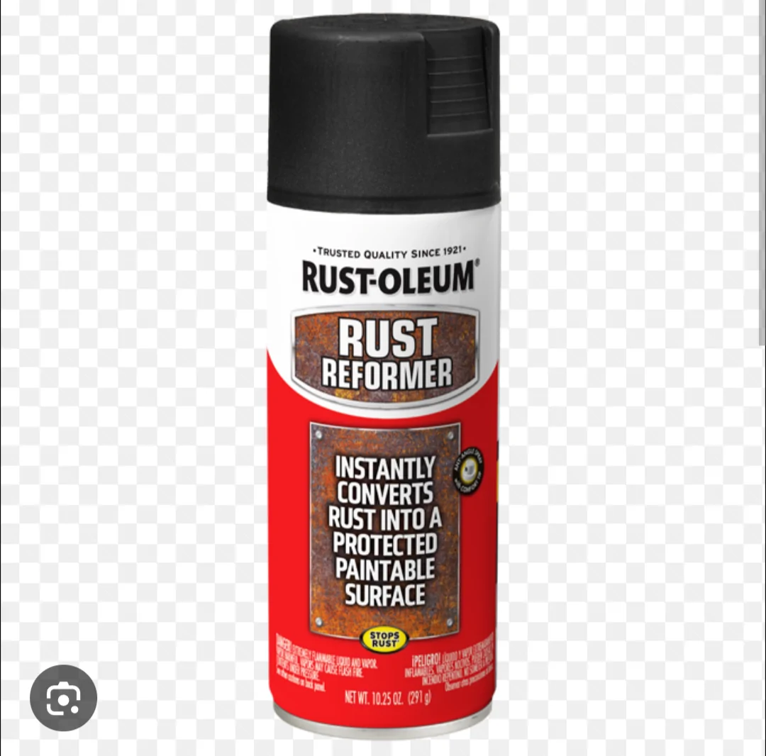

I agree with most here, Ive bent, scratched, even mangled my skids, I do take them off from time to time to clean the inside of dirt and give the rusted parts a little spray of this (don't care if the color matches perfectly)
Ford Bronco Dinged up bash plates -- how to prevent rust Screenshot_20260604-104251
