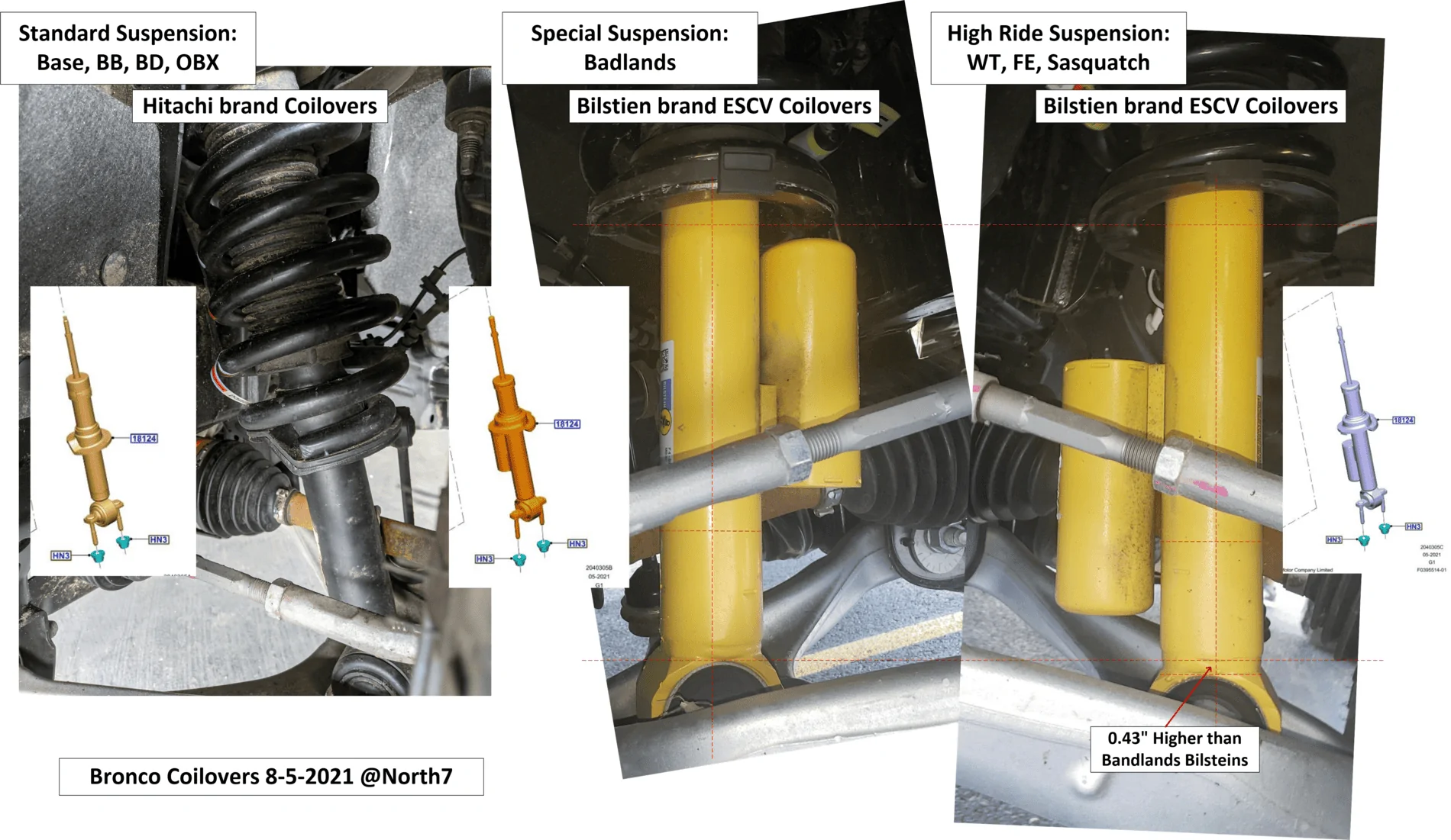

Hum so with the Sasquatch badlands your pretty much just getting tires, rims, spacer kit, and Sasquatch sticker. The Sasquatch sticker I say if it was bigger would be an extra 1k to price.

And, 4mm built in bump stops internal to the Sasquatch Bilstein shocks to limit articulation and not rub with the 35" tires.

.... and it's not a spacer kit... the shocks are actually longer... and you get the wider fender flares... and the factory warranty....
I've said it before and I'll say it again:
SASing the BL is financially sensible if you like the components that come with it.
If you think you're going to want to lift it further, put different gears in it, change out wheels or tires, etc etc etc... you're probably better off buying the trim you want for the other package items, and forgoing the factory SAS in favor of doing it however you want aftermarket.

The wheels themselves are different if you are planning on keeping them.
Non Squatch BL has 17x8 with +55 offset
Squatched BL gets 17x8.5 with +30 offset
Possible rubbing issues aside, keep in mind most 35x12.5 tires call for 8.5 rim width if you care about such things. Shell out $3k and upgrade the wheels and tires, slam in a spacer lift and you are ready.

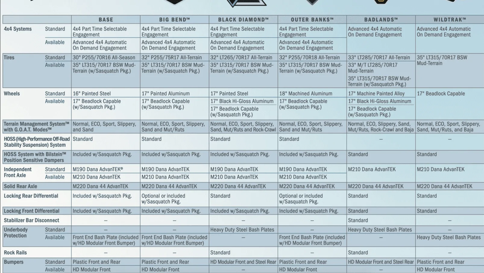

I'm looking at the table below and it seems to me that the HOSS suspension would be the same one included in the Squatch package available to all models.
So, If I just order the 10 speed with the 4.46 with the Badlands, I can assume that adding 35s would make it have the same ride height as the Squatch and that they would clear exactly the same. (crash bars removed) Different fenders shouldn't matter at all.
I would replace the stock tires from the Badlands anyways.
Has this been discussed? I couldn't find it.
The difference in final gear ratio, as I figured it is: Squatch (4.7) would be 67.8 and the 4.46 would end up at 64.3. To me that's not enough to justify the Squatch package. Badlands comes with lockers already.
The difference is 2495 bucks. I know that includes the beadlocks and 35s.
