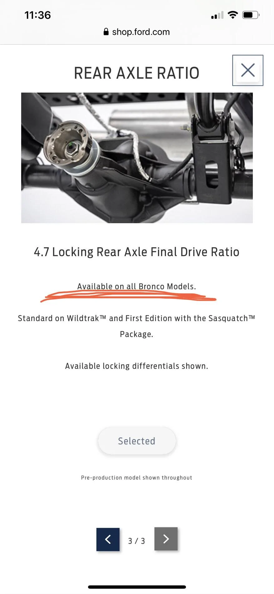

LMAO...I just showed you it doesn’t. Unless it’s a glitch in the B&P
It doesn't do that for me on the laptop. Can't explain the difference. Bug maybe? Don't know.
Musicalfisherman
Daryl
Aug 7, 2020
113
333
Wow that’s funny. It works for me on the phone and the desktop. I hope it’s not a bug cause I’d like the 4.7!
I'm not in that models price range so I haven't been building that model. It could be a "cache thing" I suppose...
