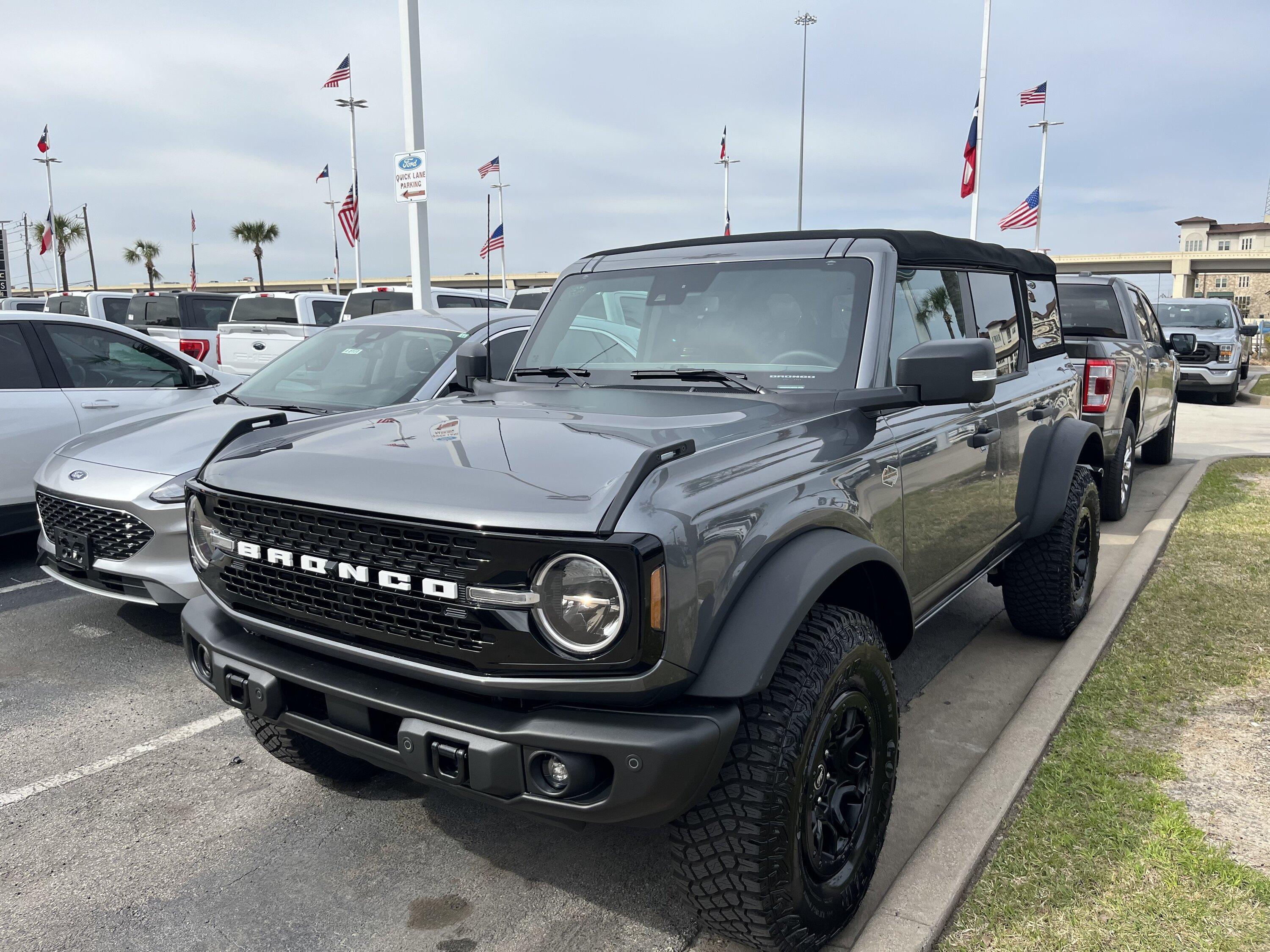

I used this list and many other checklist items to inspect my 2023 Wildtrak today. Very helpful. All checked out EXCEPT the rear heating duct issue. So it stays at the dealer for now while they fix it, then I will take delivery. And they tried yanking me around on incentives and certificates, so this gives me time to verify with Ford central.
The paint job was not great but that is the Ford world today, I’ll get it corrected and clear coated. To all: check everything before driving off the lot!

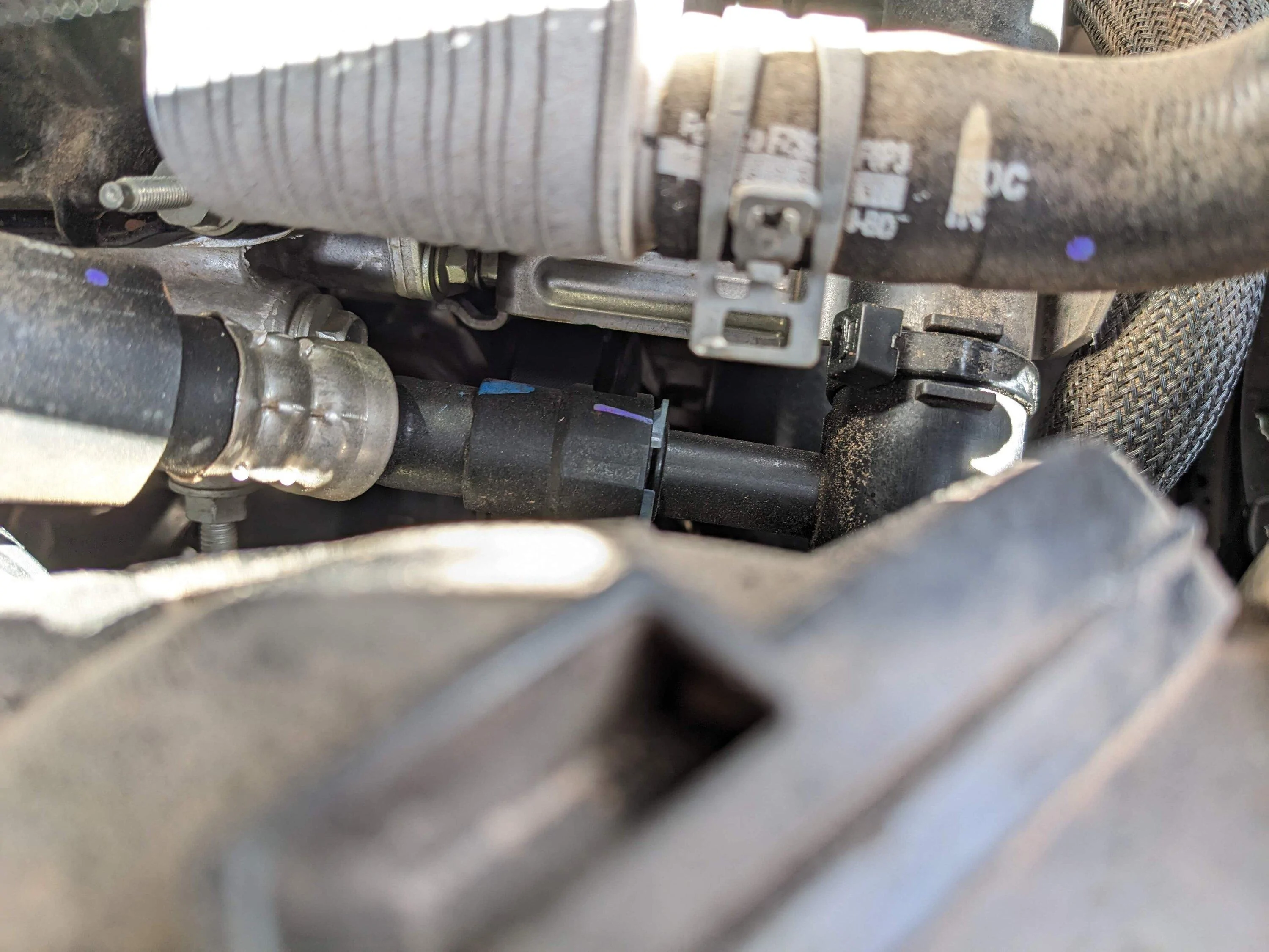

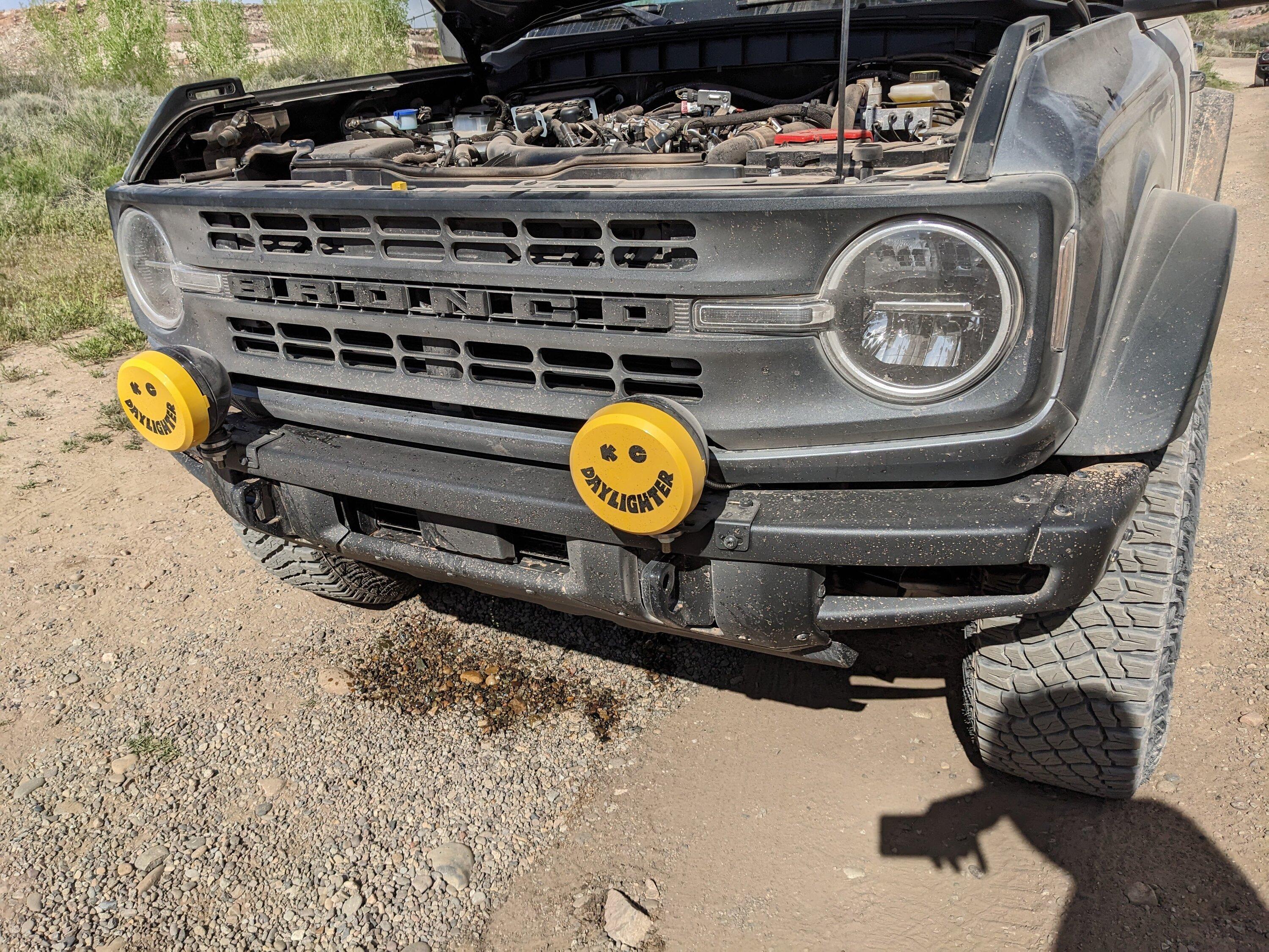

I discovered a new item to check last week in Moab. The quick disconnect on the passenger side beside the oil cooler was not fully engaged. This was at about 1400 miles. I popped it back on and it seems fine now after adding half a gallon of water.
