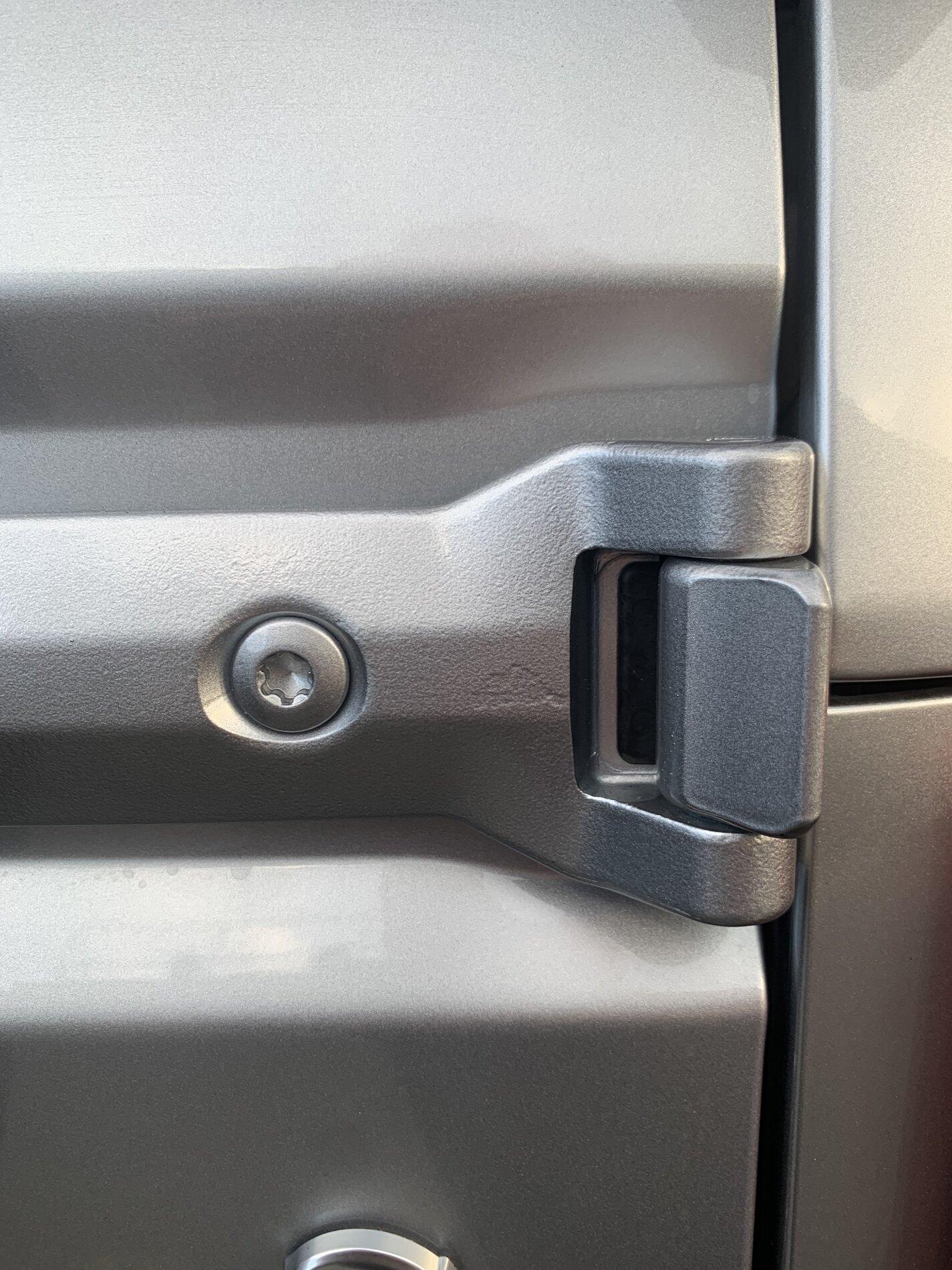

The hinges on my tailgate have poor finish work. They’re going in for repainting:
Ford Bronco Delivery Inspection Checklist. 162194B7-7A8C-4E09-AAB2-929AFBAB2983

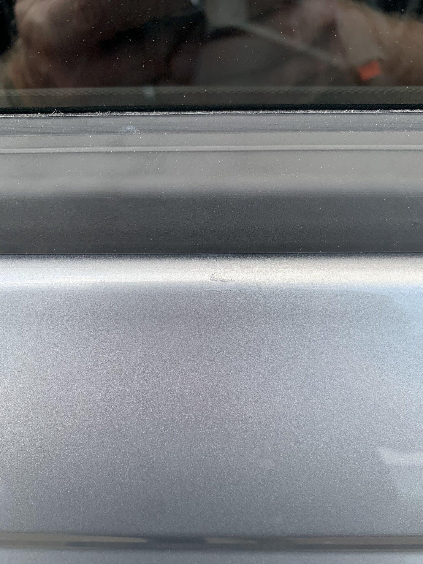

I also had a few spots where it appears sand or dust is under the paint/clear coat:
Ford Bronco Delivery Inspection Checklist. CBA13D25-7103-442E-AB0E-ED162FE1C481

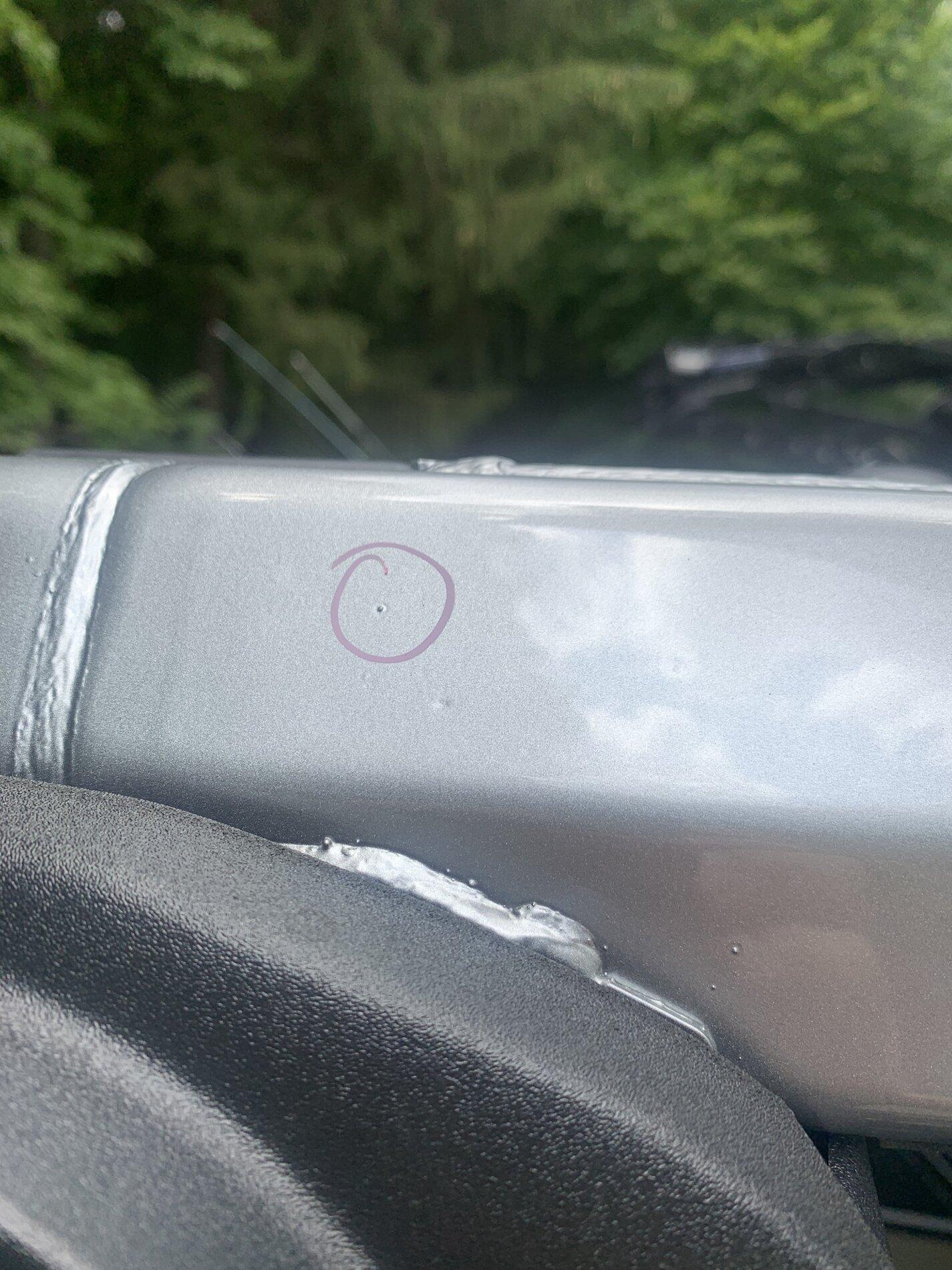

This one was actually factory circles and not fixed before delivery:
Ford Bronco Delivery Inspection Checklist. 0A6047FF-61A4-421B-B8F6-62BD043C295F

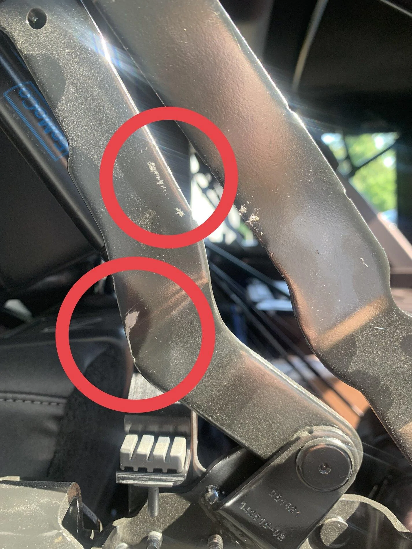

I don’t have roll bar rubbing - but, the soft top hardware itself is showing signs of rubbing down to bare metal:
Ford Bronco Delivery Inspection Checklist. A6E26866-16DE-49FB-B792-C224DD331B74

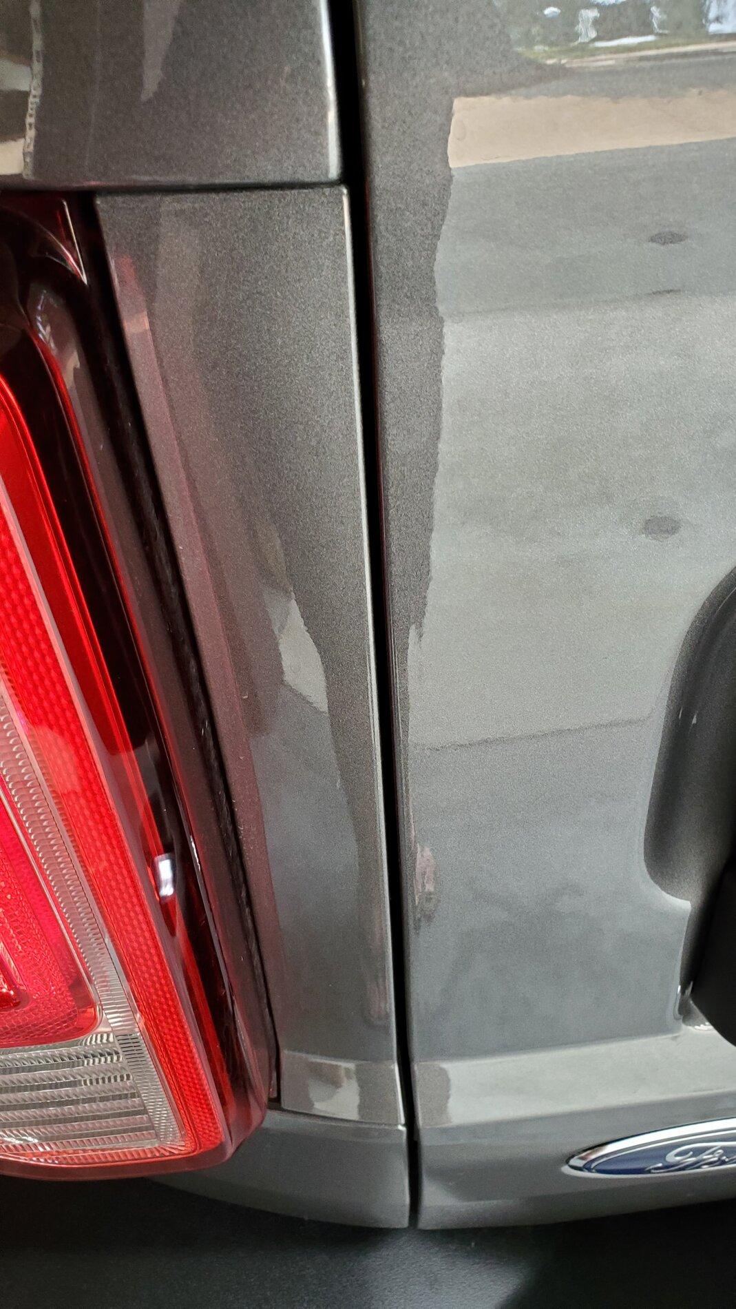

The filler panel between the driver's side tail light and the tailgate was improperly installed and the tailgate closed over the top of it. Tailgate paint was chipped on the inside edge, and the panel was damaged. The dealer has ordered a new panel and will paint to match and replace it as soon as it comes in. They will repair the paint chip at the same time. The attached picture is after the panel was reinstalled. The alignment is improved but not correct and the dealer is still replacing it.
Ford Bronco Delivery Inspection Checklist. 20210827_103203
