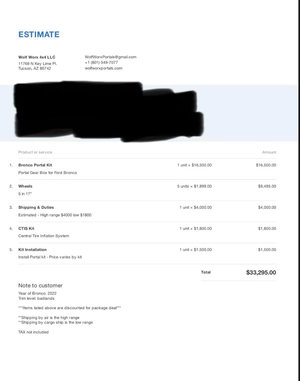

Here is a quote for your “3k” portals
So about $18k but that was for the Bronco and my point was that portals for the Bronco seemed much more expensive than portals for other vehicles.
It's ok, really. To portal or not to portal...welcome to 1st world problems :)
So part of the cost of the Bronco portals is
1)new larger brake rotors (had to go larger to clear the portal housing. Fronts are off a toyota and rears are custom made.
2) replaces front knuckle. Werewolf and Tibus bolt on to the existing knuckle the end result is almost an inch and a half wider per side than the 74 weld.
3) new rear axle shafts. Hardened 35 (or 32??) spline.
The Tibus (last pricing I saw) are $25 grand through BB... They are nice and I think provide another inch of lift but I prefer the 4 gear straight cut design of 74 weld to the 3 gear helical of Tibus.... I believe the Werewolfs are cast iron and use a 4 gear straight cut (Tibus used to be cast iron but I have been told that they are now Aluminum).
Oh and yes the were wolfs can be outfitted with a central tire inflation/deflation system so you can air down/up without leaving the vehicle. (at additional price and I think you have to use their wheels... they wheels are nice at a +60 offset to help width.)
