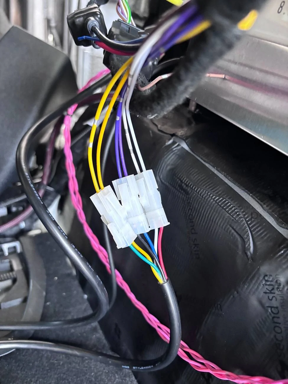

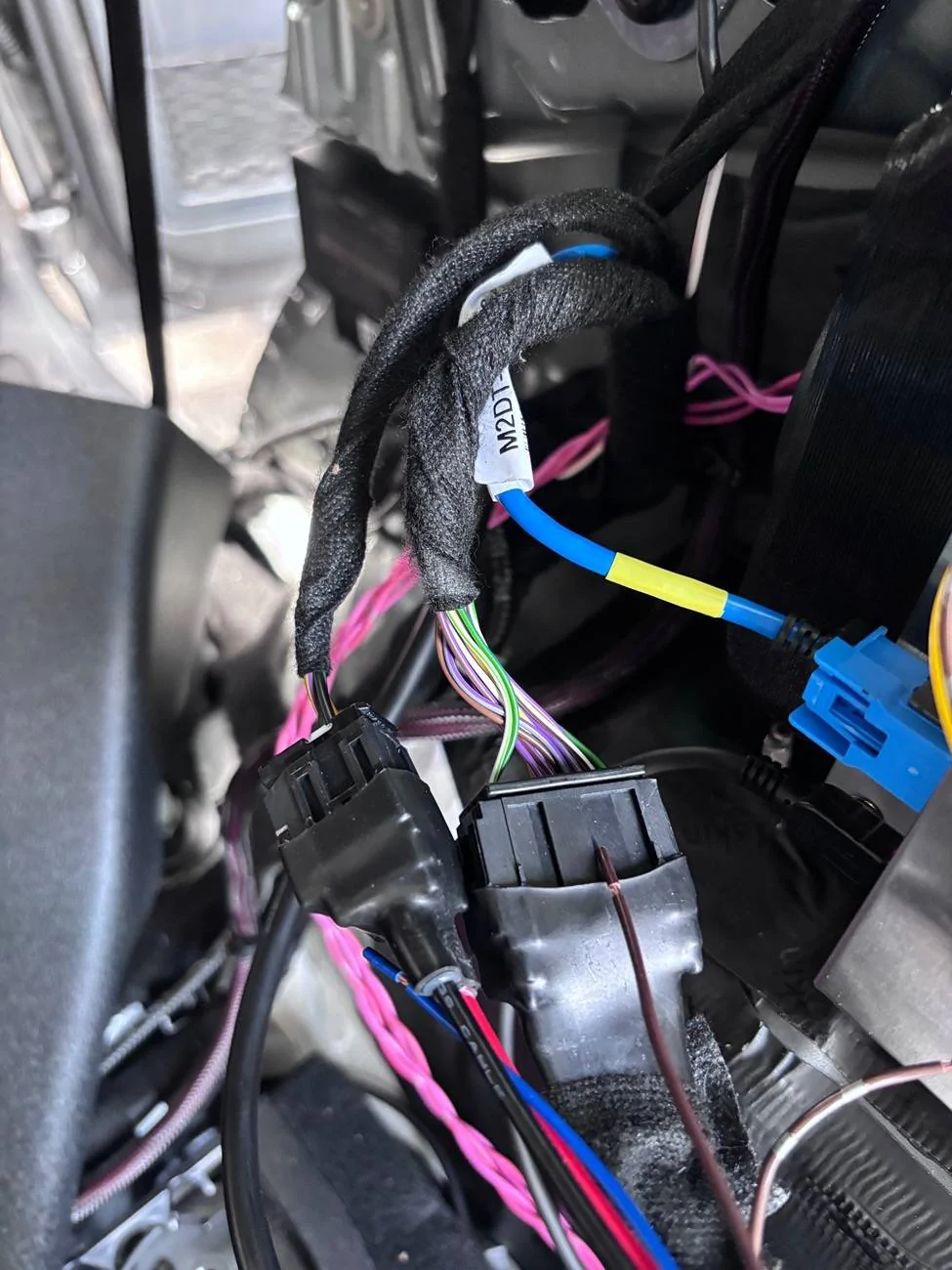

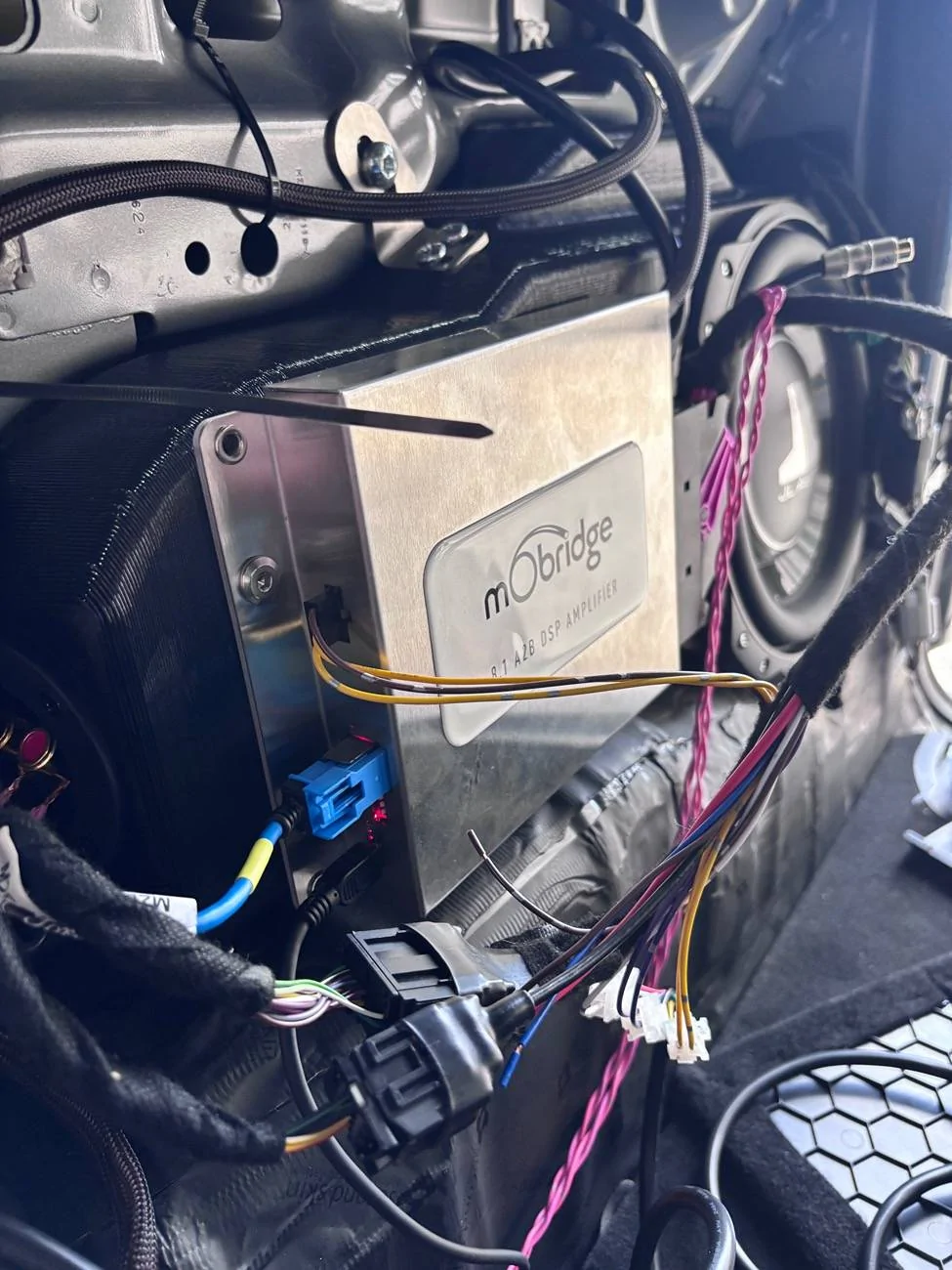

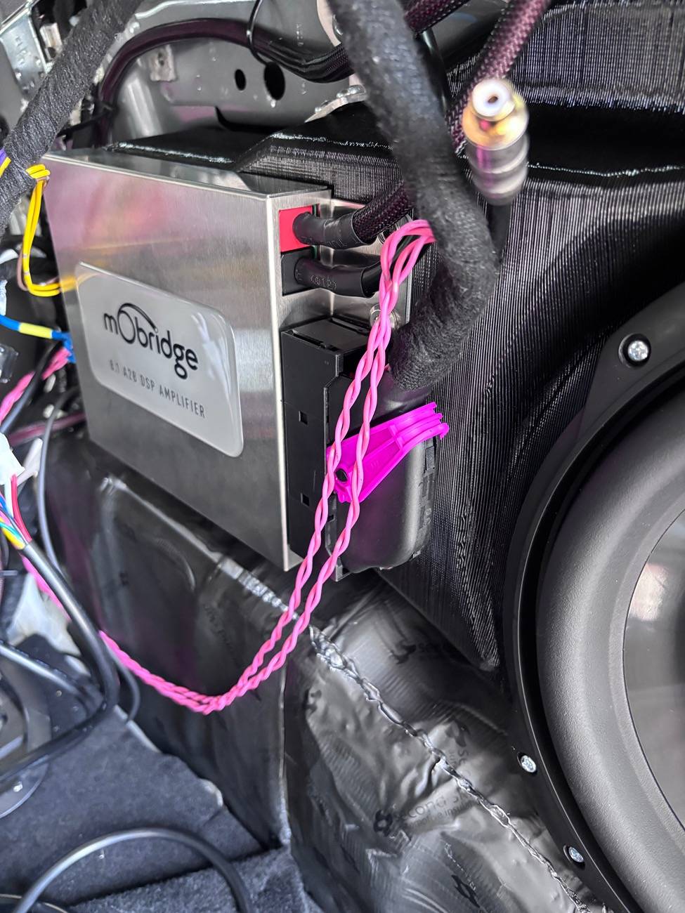

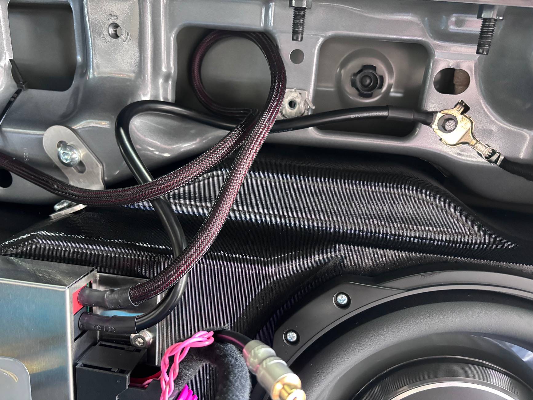

Thank you all. Here are some pics of the amp. For the harness, I have it in the far right side replacing the black connector.

That 4 pin connector that plugs into our amp is CAN from the factory connector. Not possible to wire internally
Flick dipswitch 3 up
