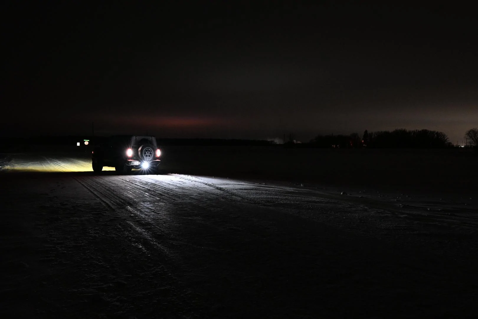

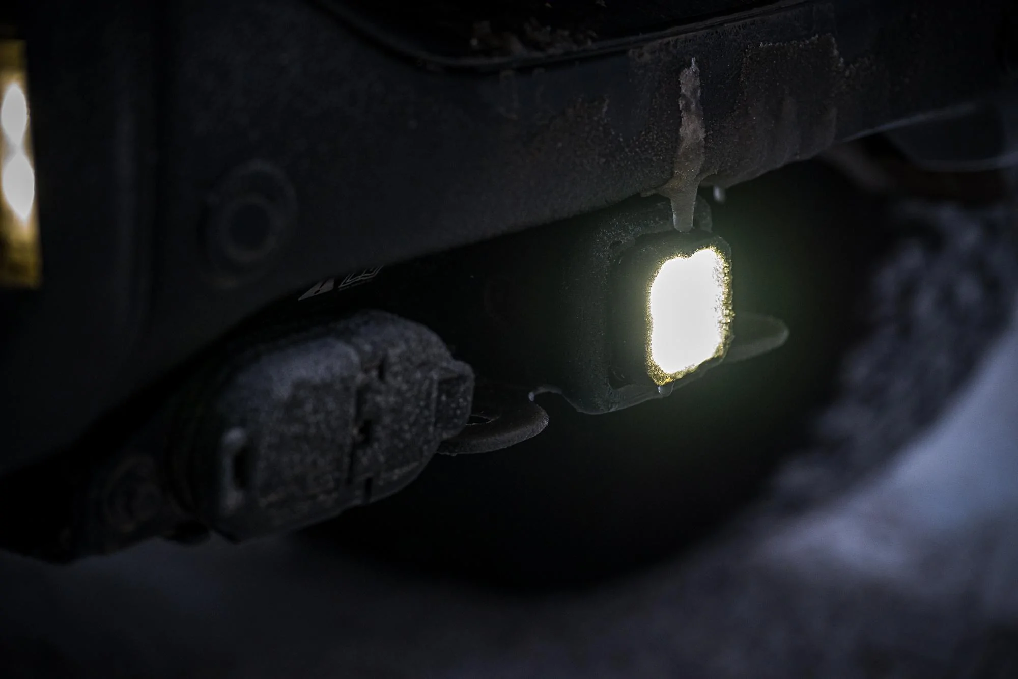

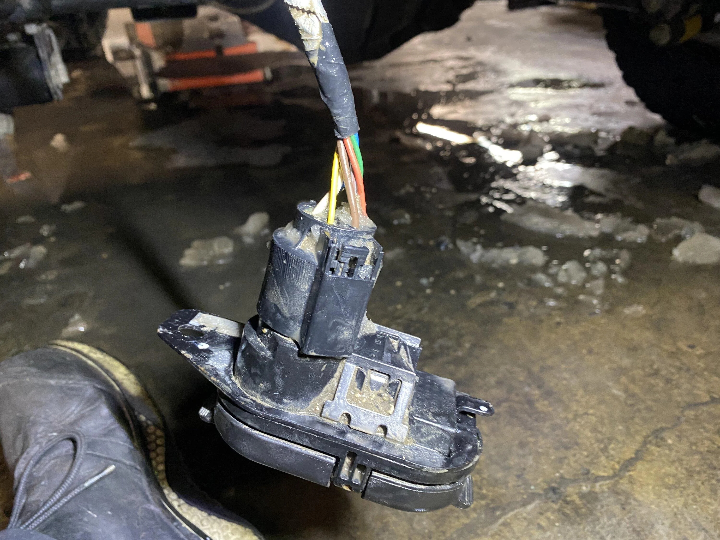

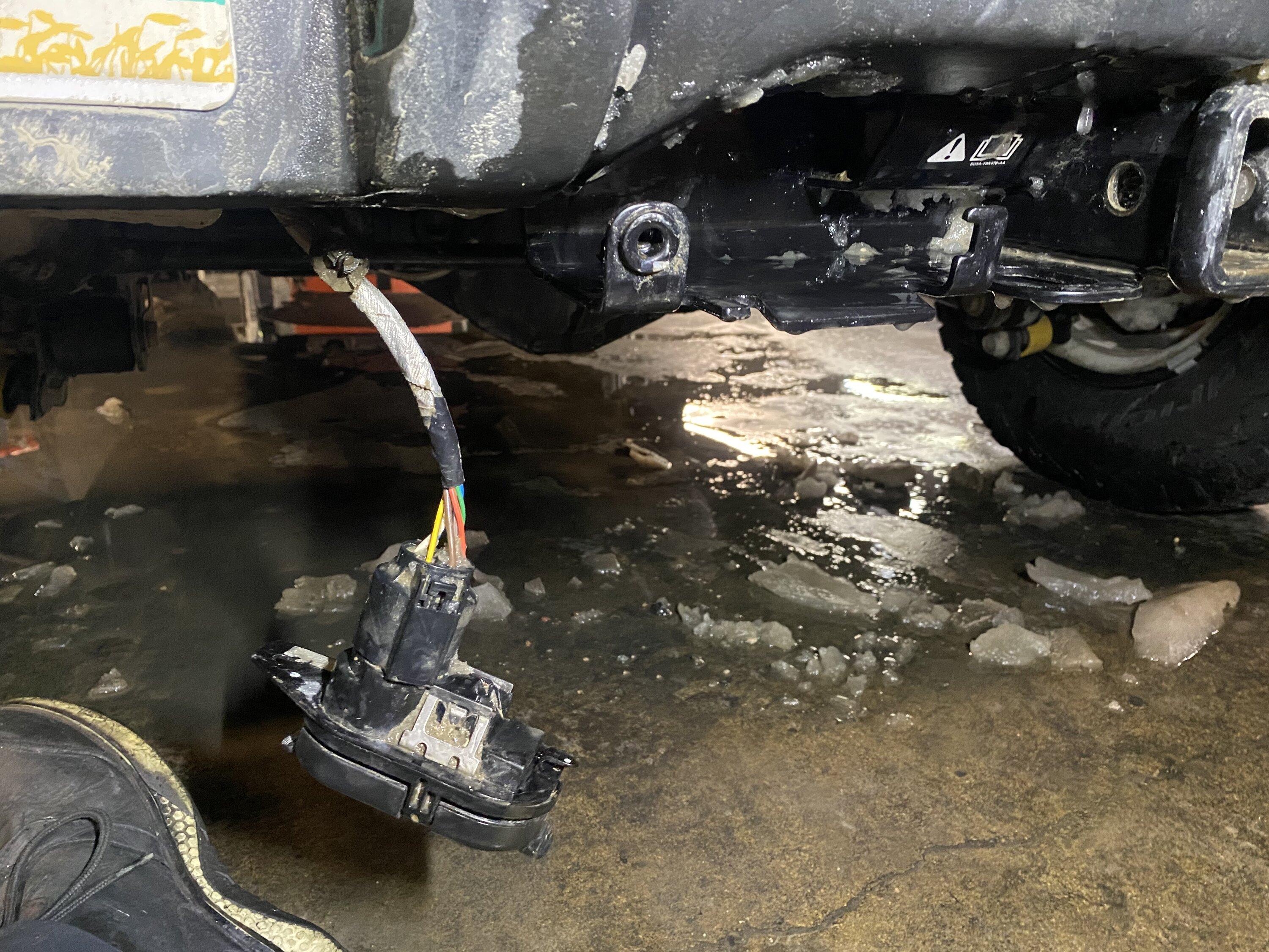

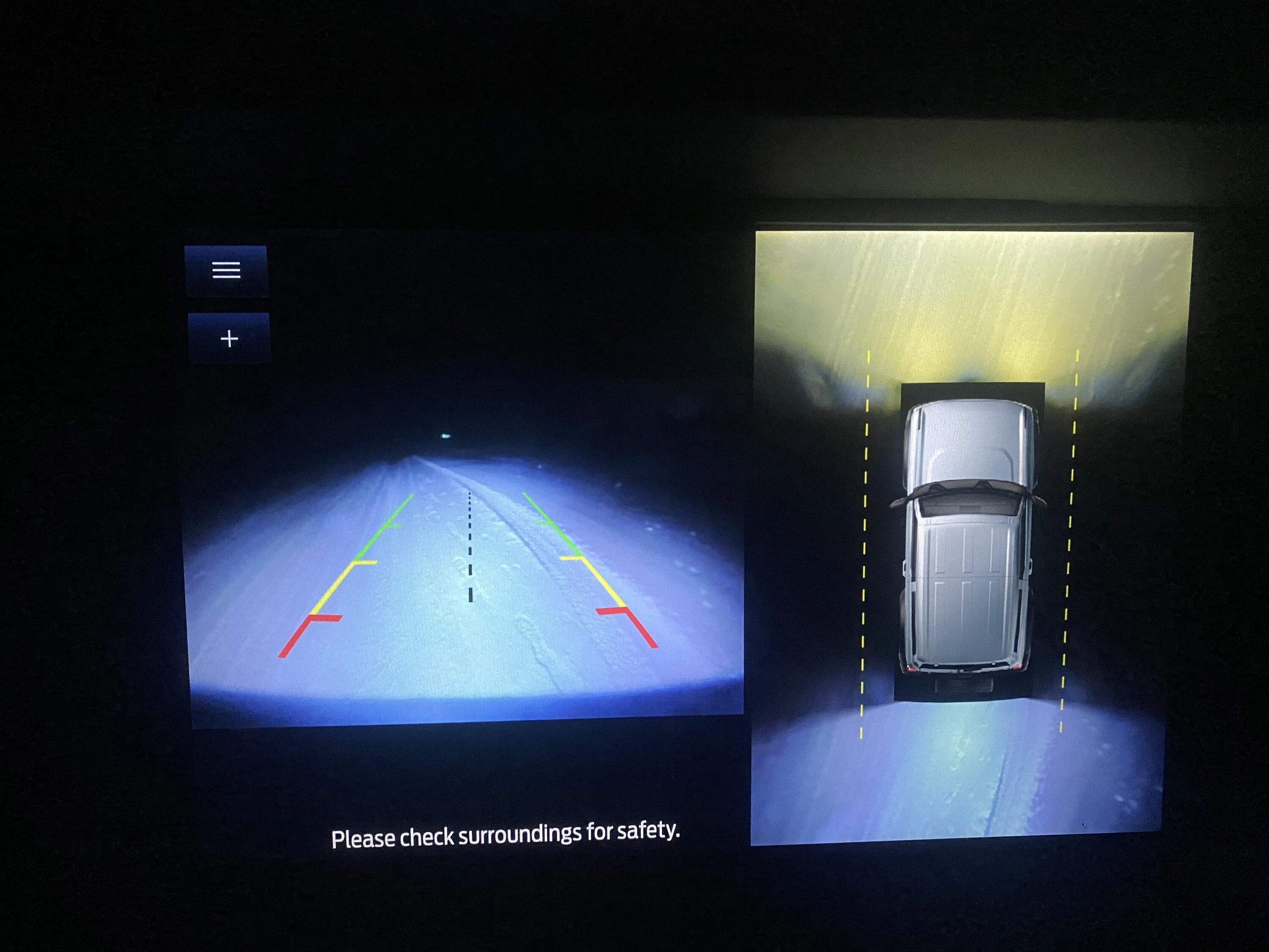

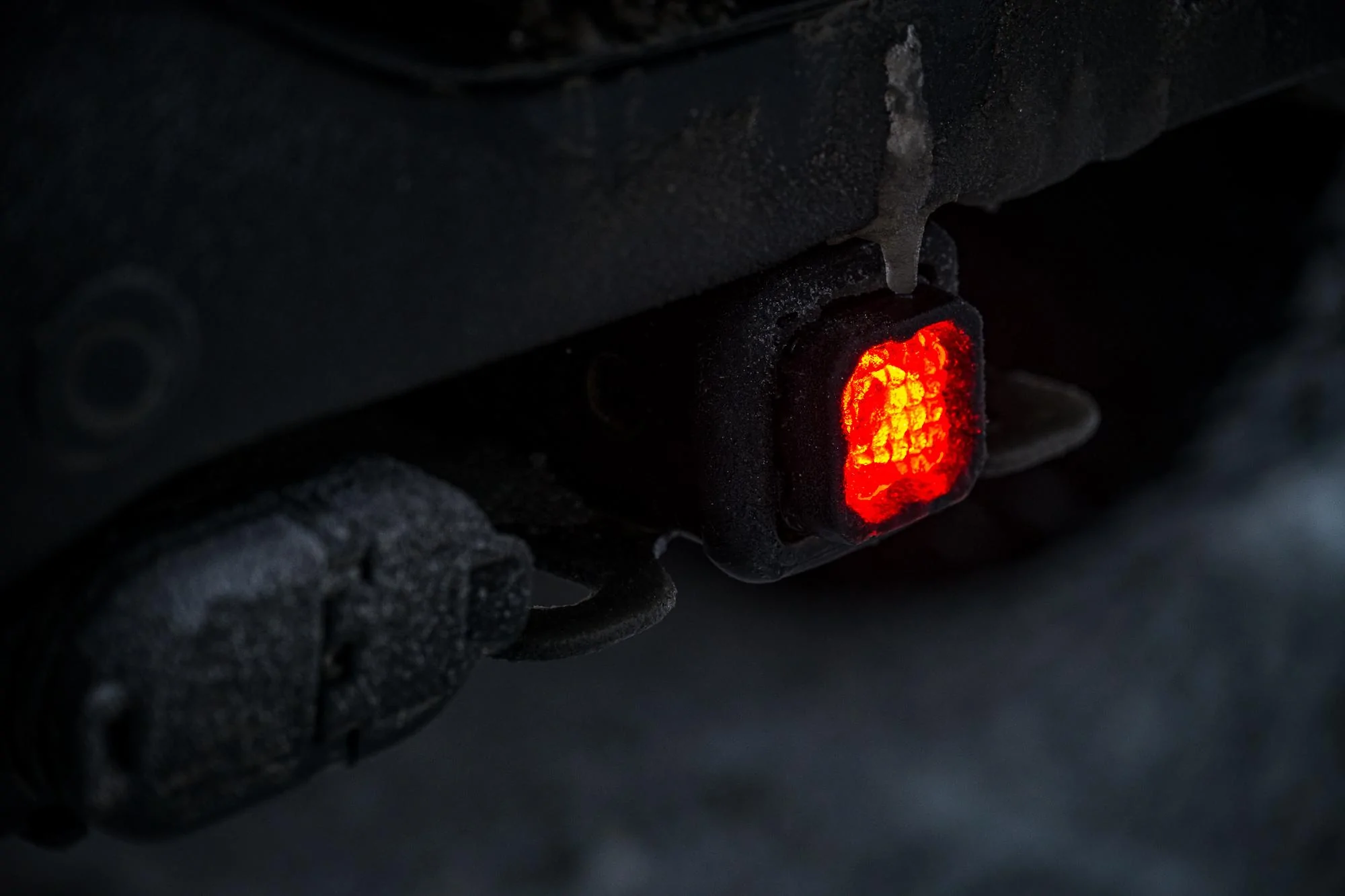

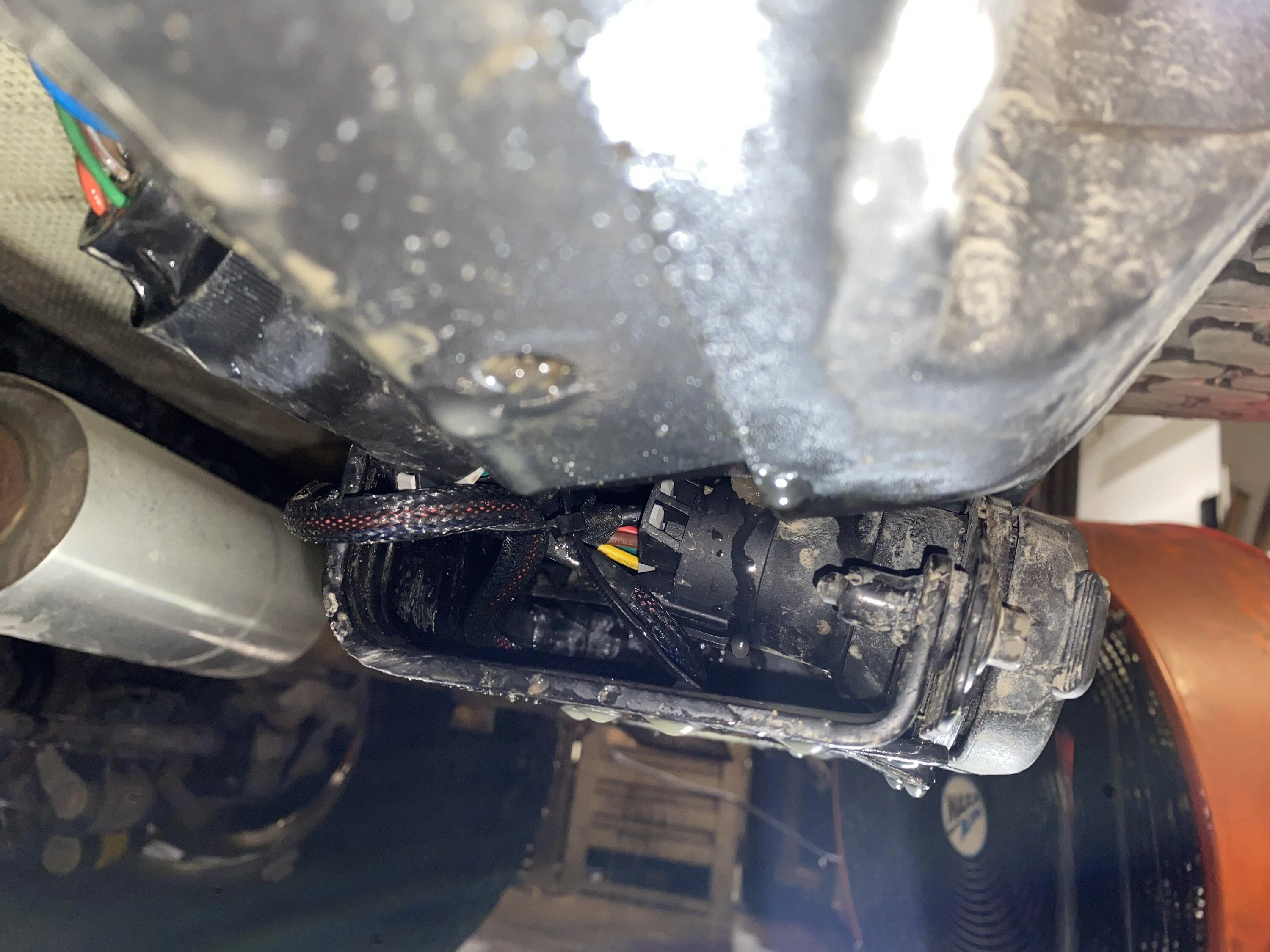

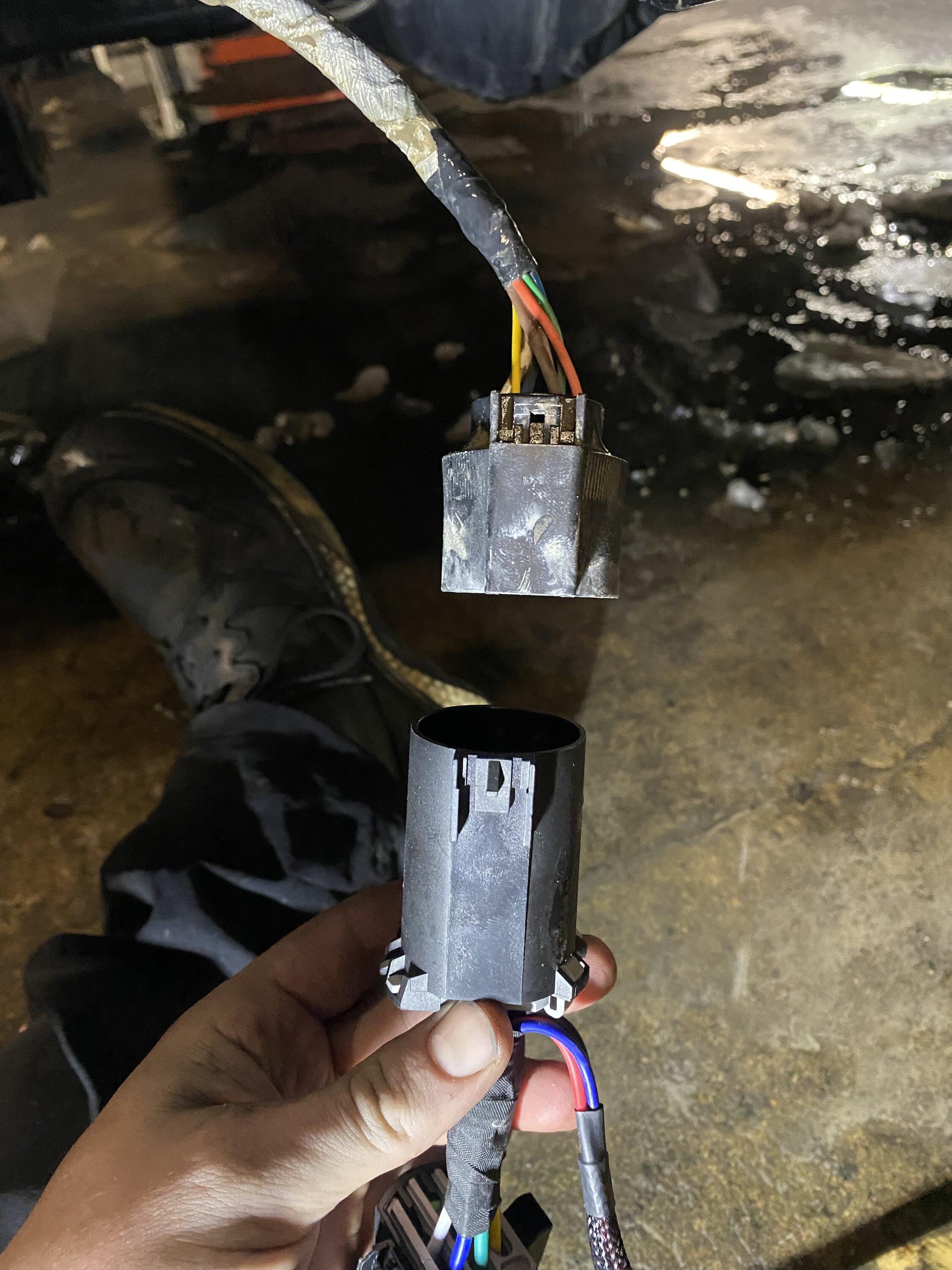

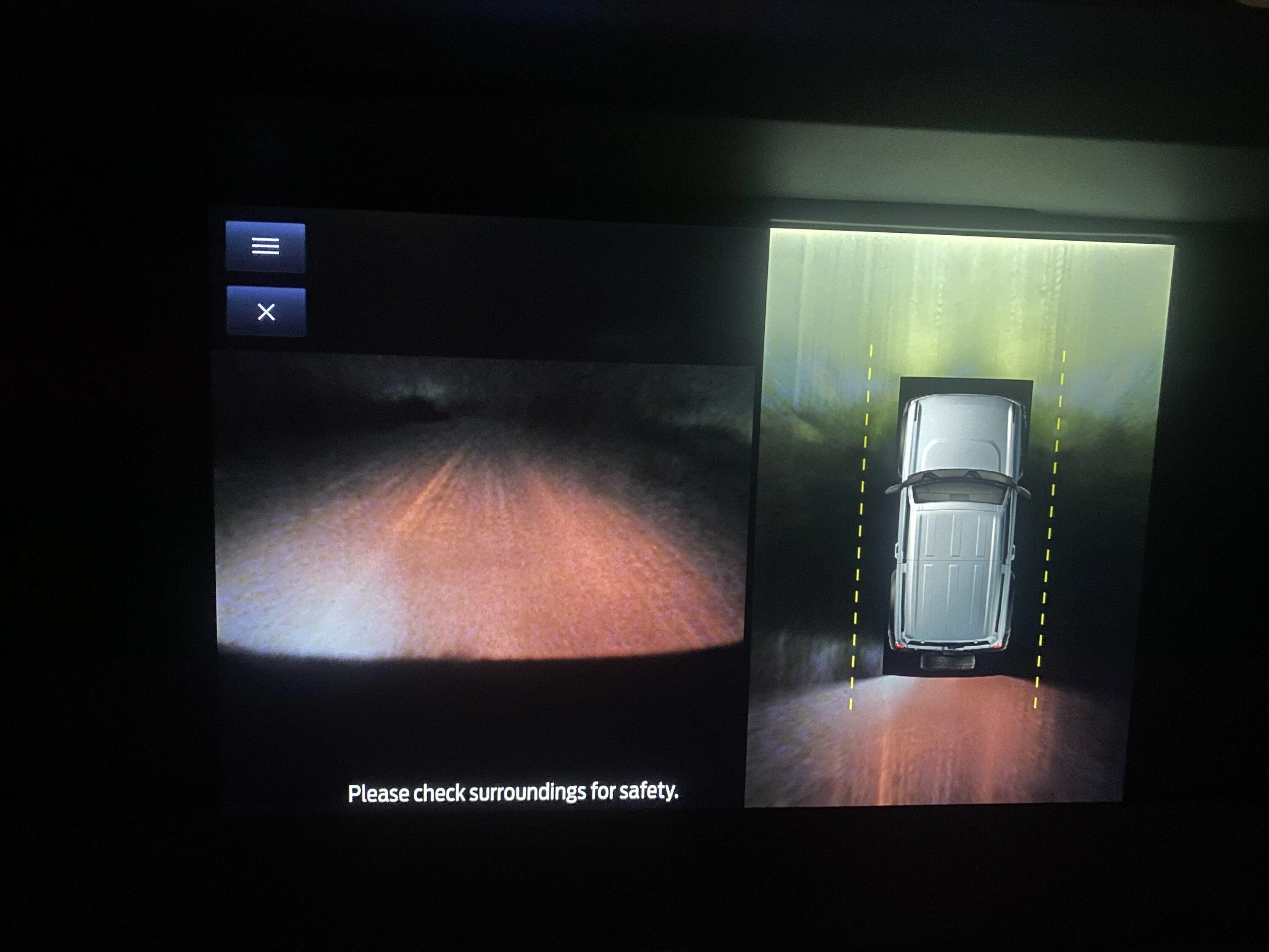

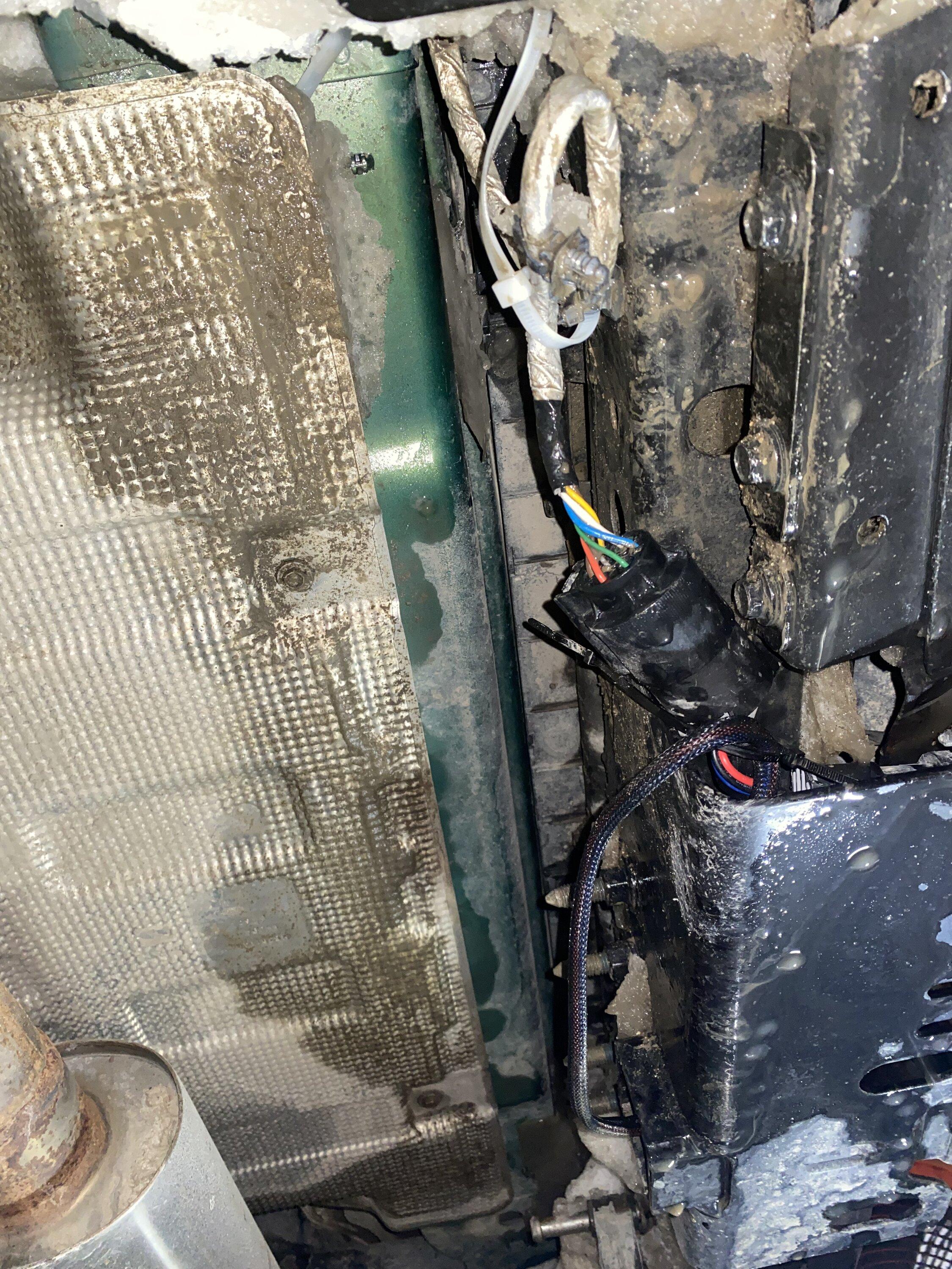

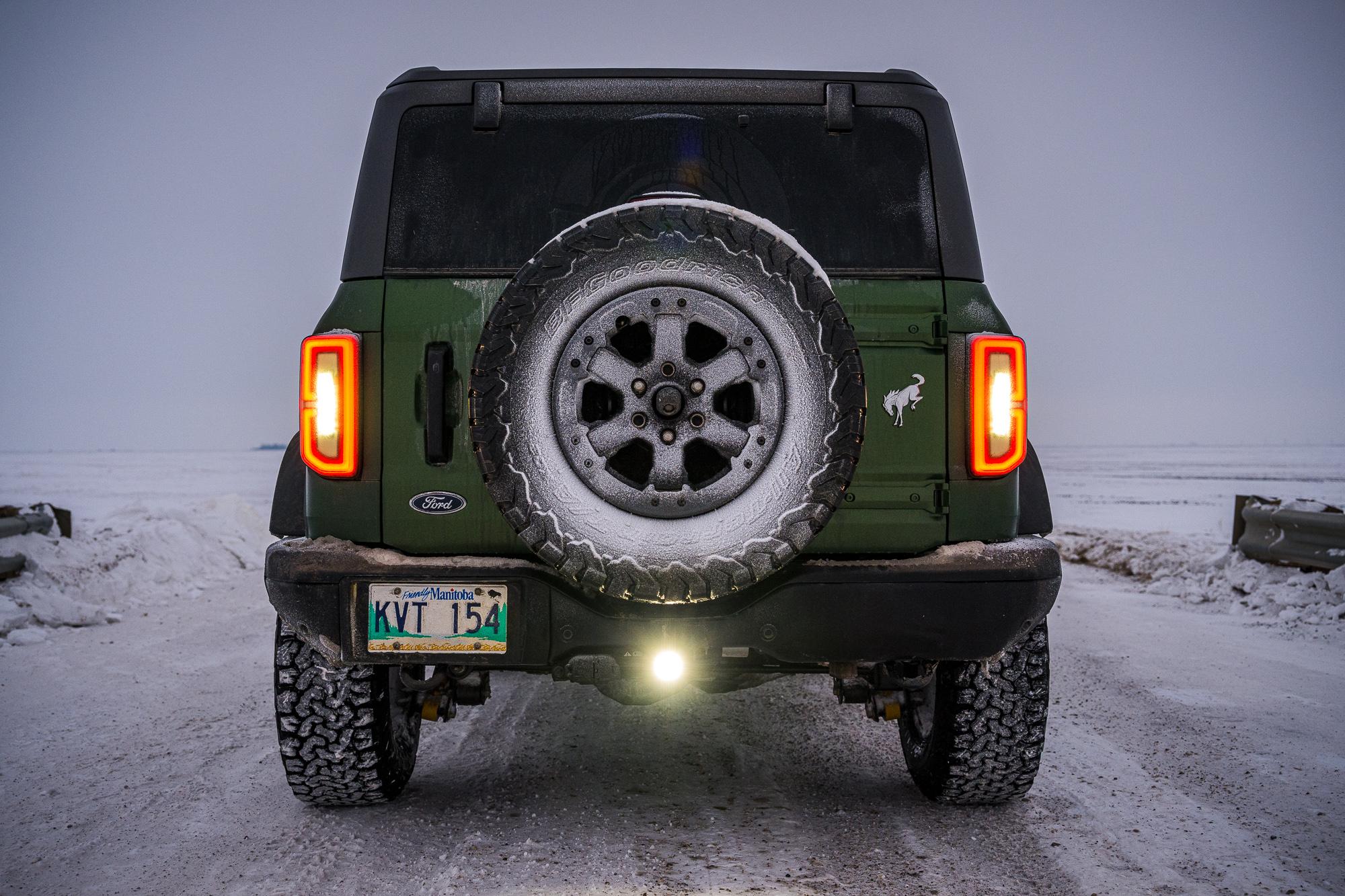

Got the HitchPod a couple days back. The rig required a few hours to thaw before I could access the 7 Pin wiring harness. Nevertheless, it fit, and works as expected! A 10MM to remove the 7/4 Connector, pull the closest factory retaining xmastree plug/ziptie thing out, and add the inline harness. Zip tie it all up as you'd like.

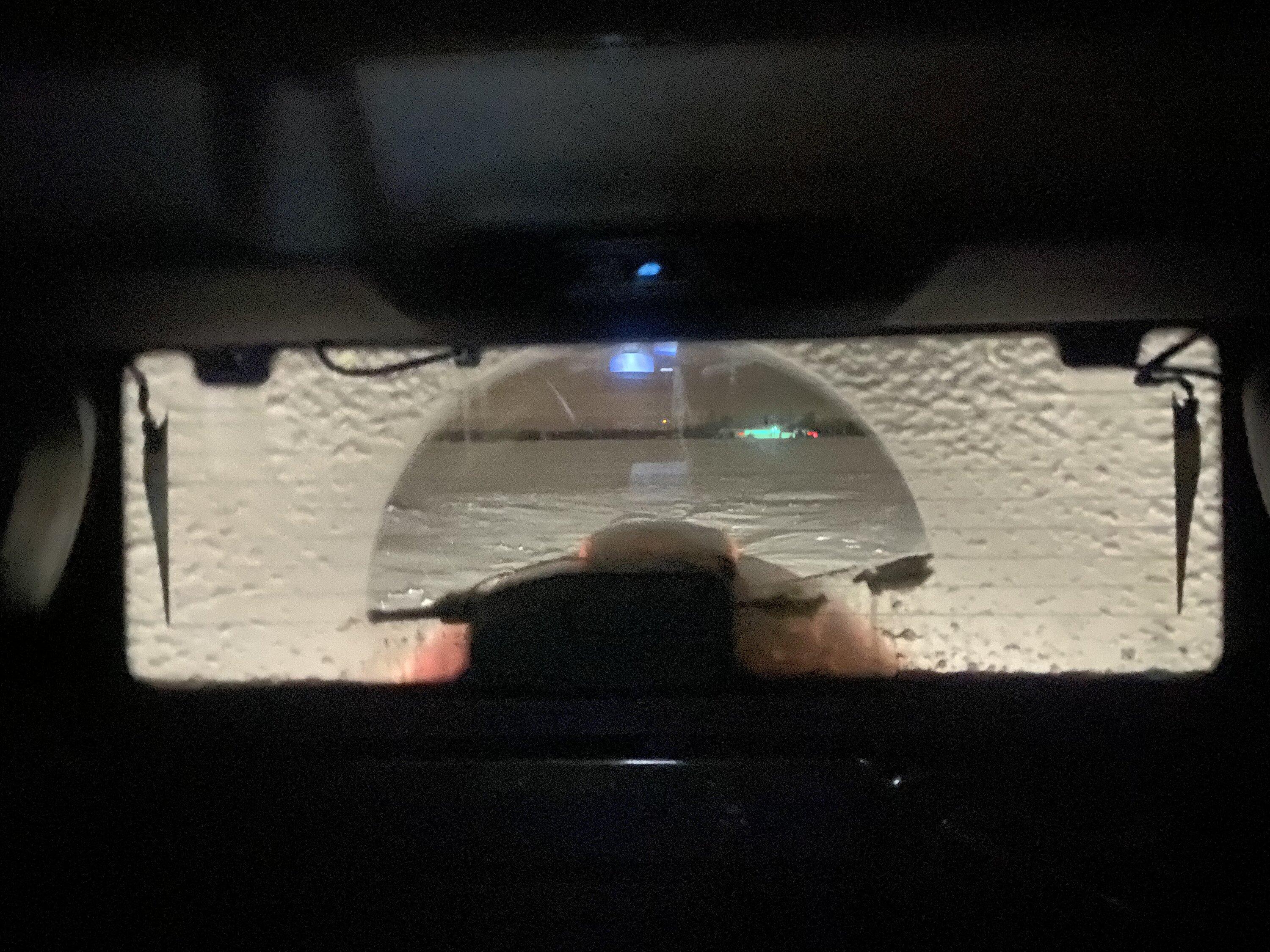

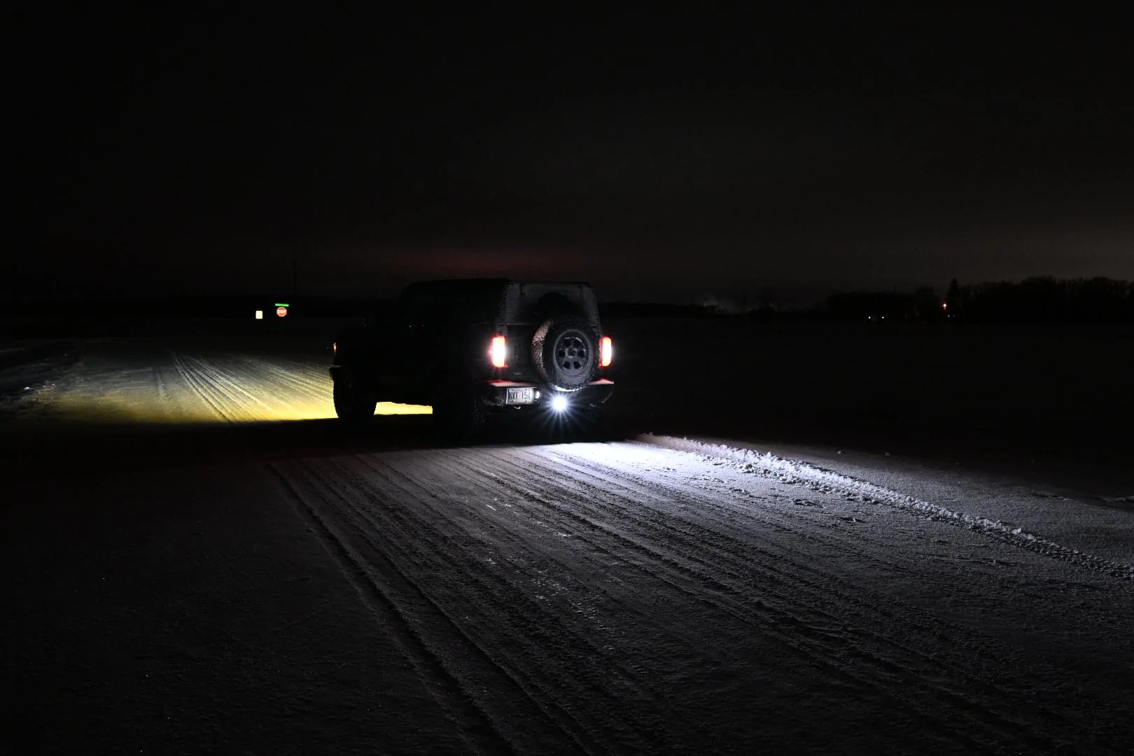

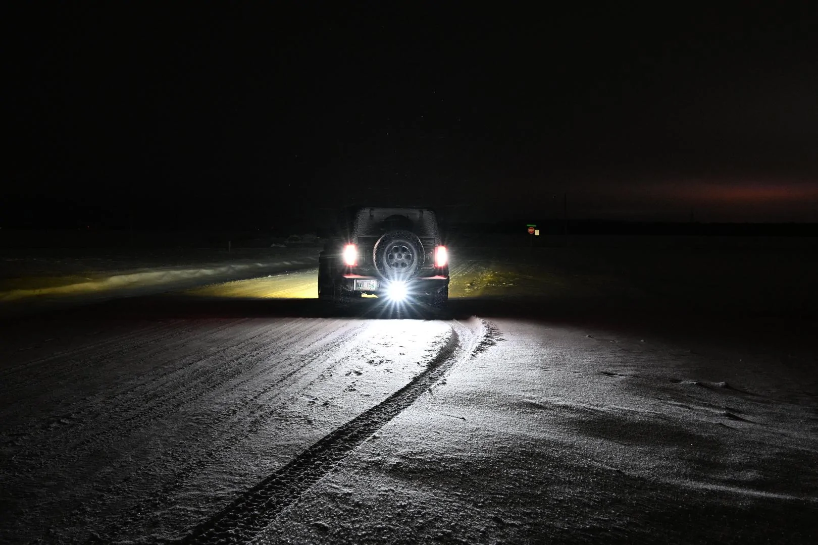

For $100, its a great lil mod that is all benefit with a decent amount of output (~1000Lumens). The flood pattern is nice and soft; it doesn't overwhelm the backup camera
Ill take some night shots and update soon.

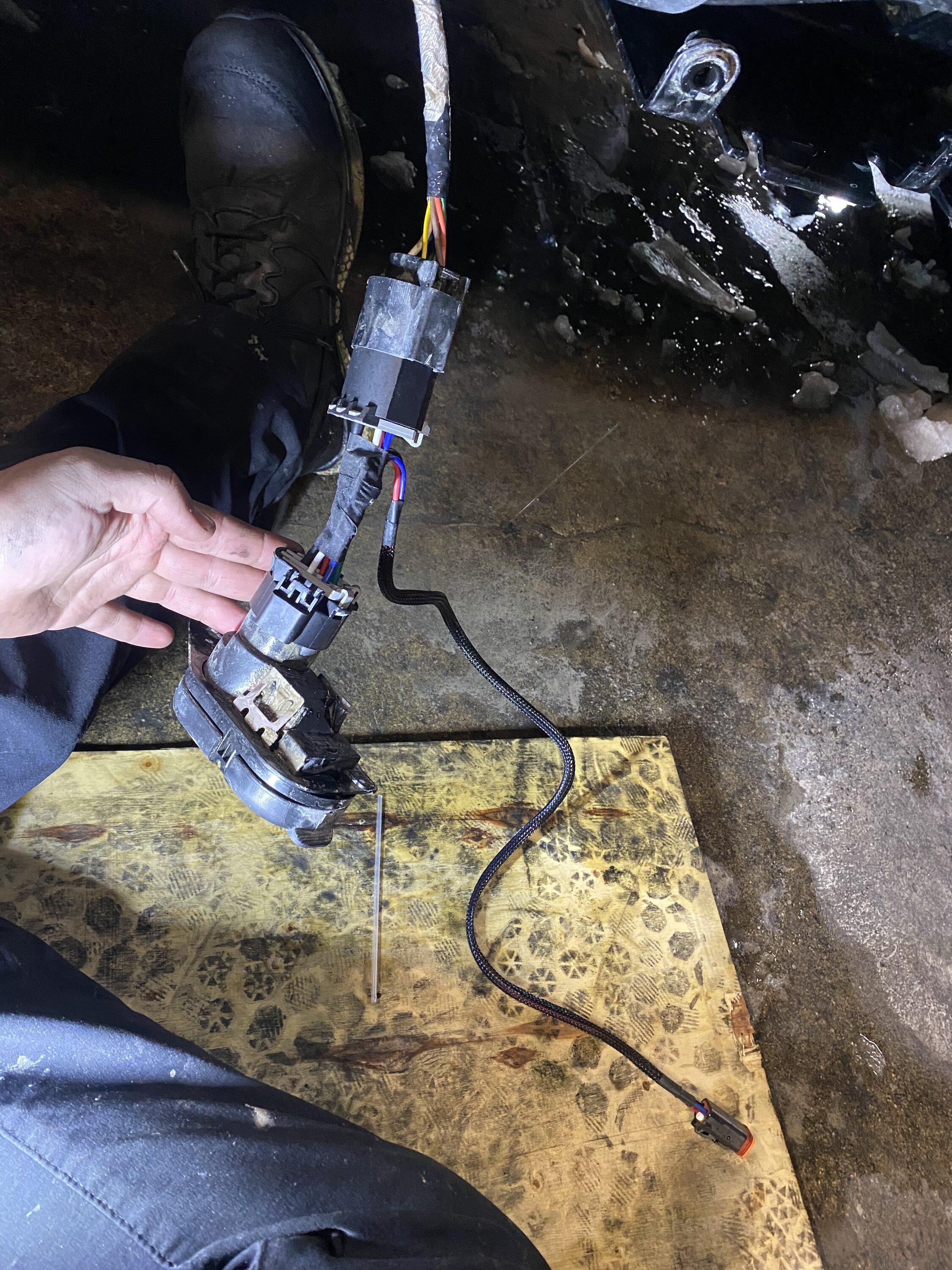

@4x4TruckLEDs.com Thanks for the Resistor Clipping Mod. Got a bit of shop time in today and that method worked as explained. Now the light functions perfectly as expected

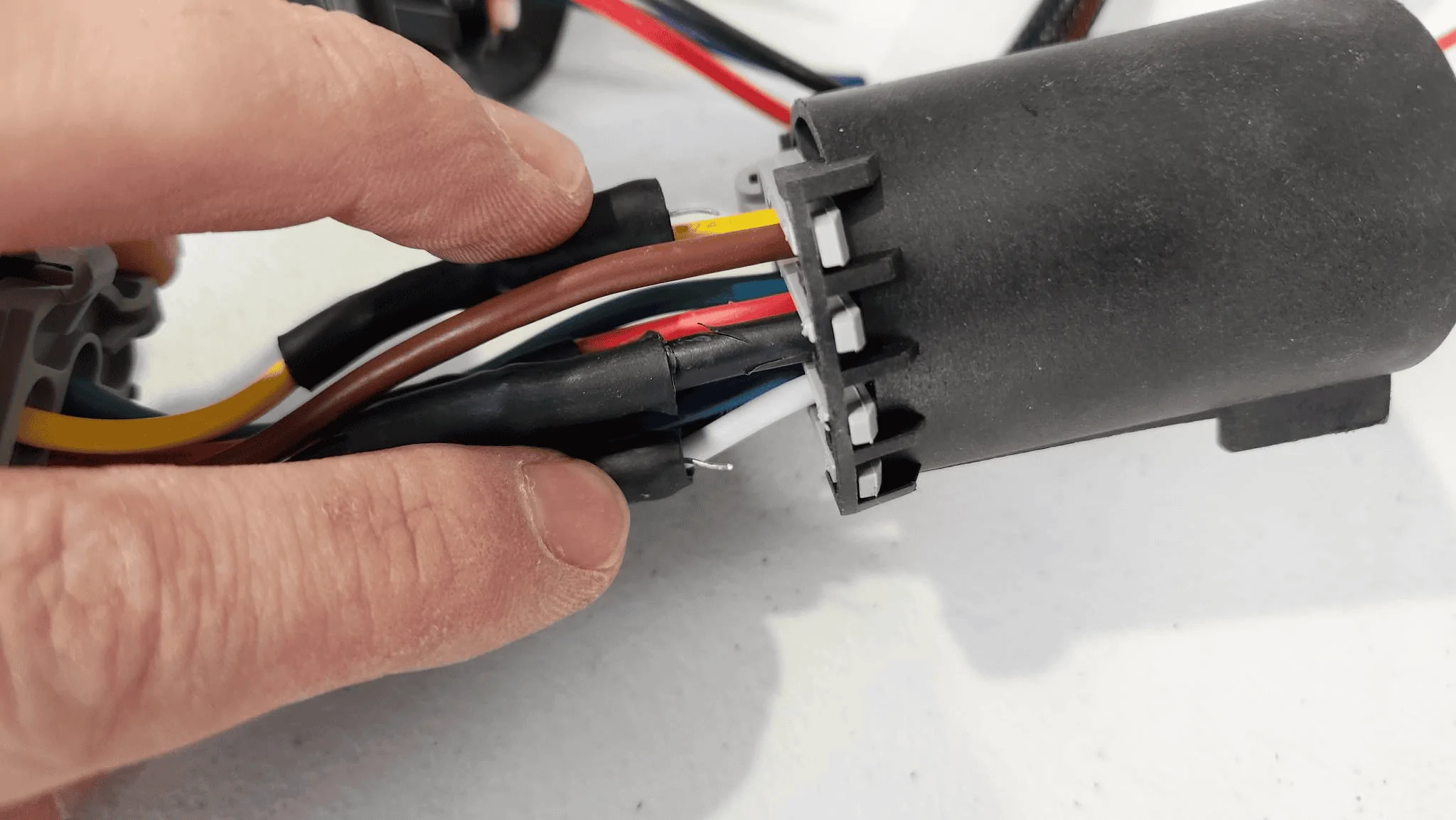

if you received a C1 hitchpod and it didn't ship from us THIS WEEK then you need to make a fix on your hitchpod. ALL hitchpods sold by us as of THIS WEEK and ALL C1R hitchpods sold from us (ever) work properly.
BUT C1 hitchpods that you got LAST week or earlier need to make the following fix:
1) Remove the black tape on the trailer harness
2) There are 2 resistors. One resistor goes from BLACK to YELLOW and the 2nd resistor goes from BLACK to WHITE. Look for these
3) CUT the resistor wire (it's the exposed metal wire). I recommend cutting it FLUSH with the resistor/wire.
4) Re-tape your harness
That's it.
Basically Diode Dynamics installed 2 resistors on the harness which don't work on Ford vehicles, as the Ford trucks think a trailer is connected and will disable your cross-traffic alert system.
If you don't do this the Hitch Pod WILL still work, but your cross-traffic alert system will get disabled. So simply cut those 2 resistors and it'll fix the issue.
We tested this in-house AND Diode Dynamics tested this in-house also (they provided us the instructions to test on some additional Ford trucks like a Lightning).
Here is one of those resistors shown with the wire still sticking off (cut it flush)
So I just cut the small piece of wire that sticks out?
