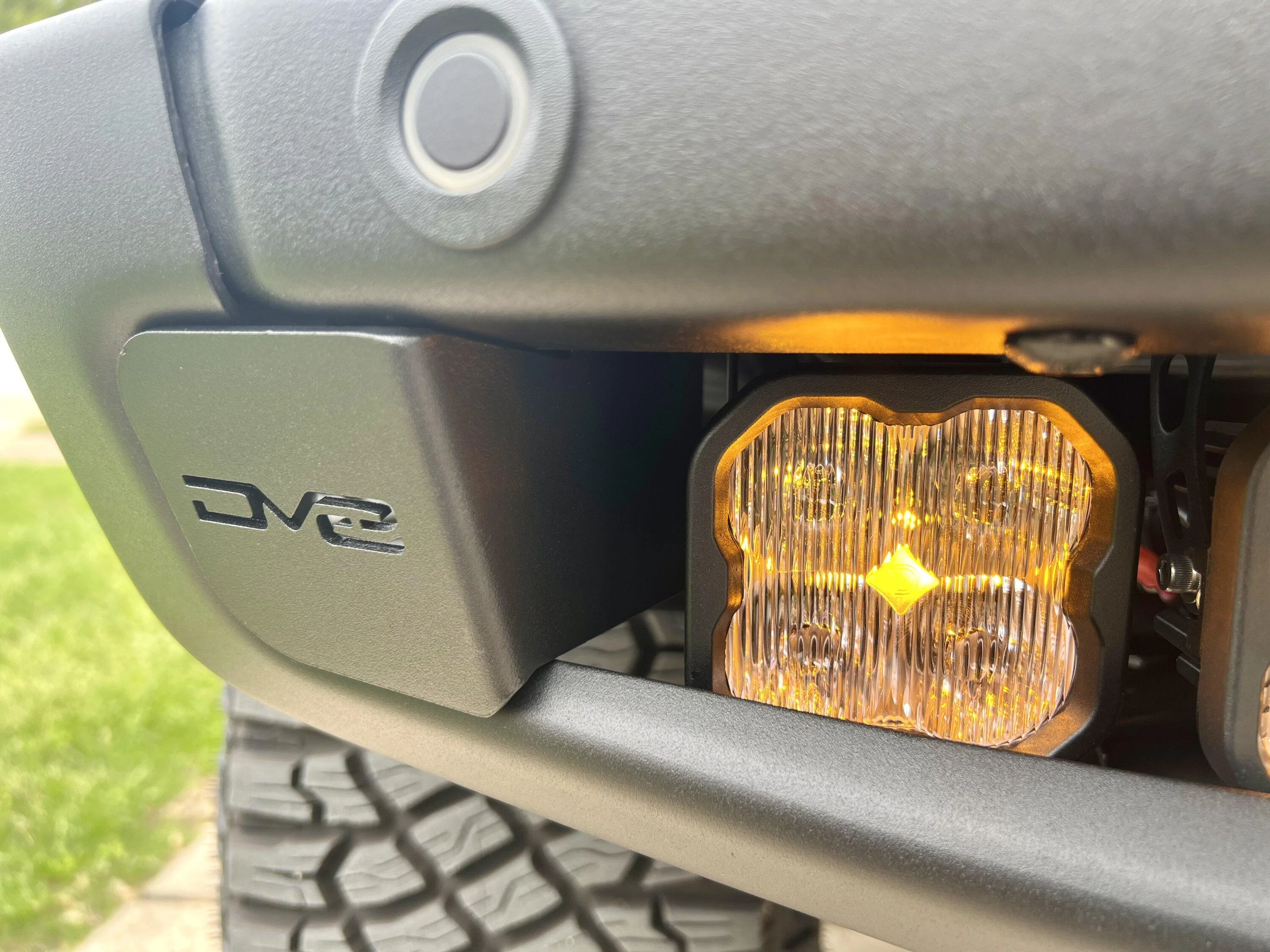

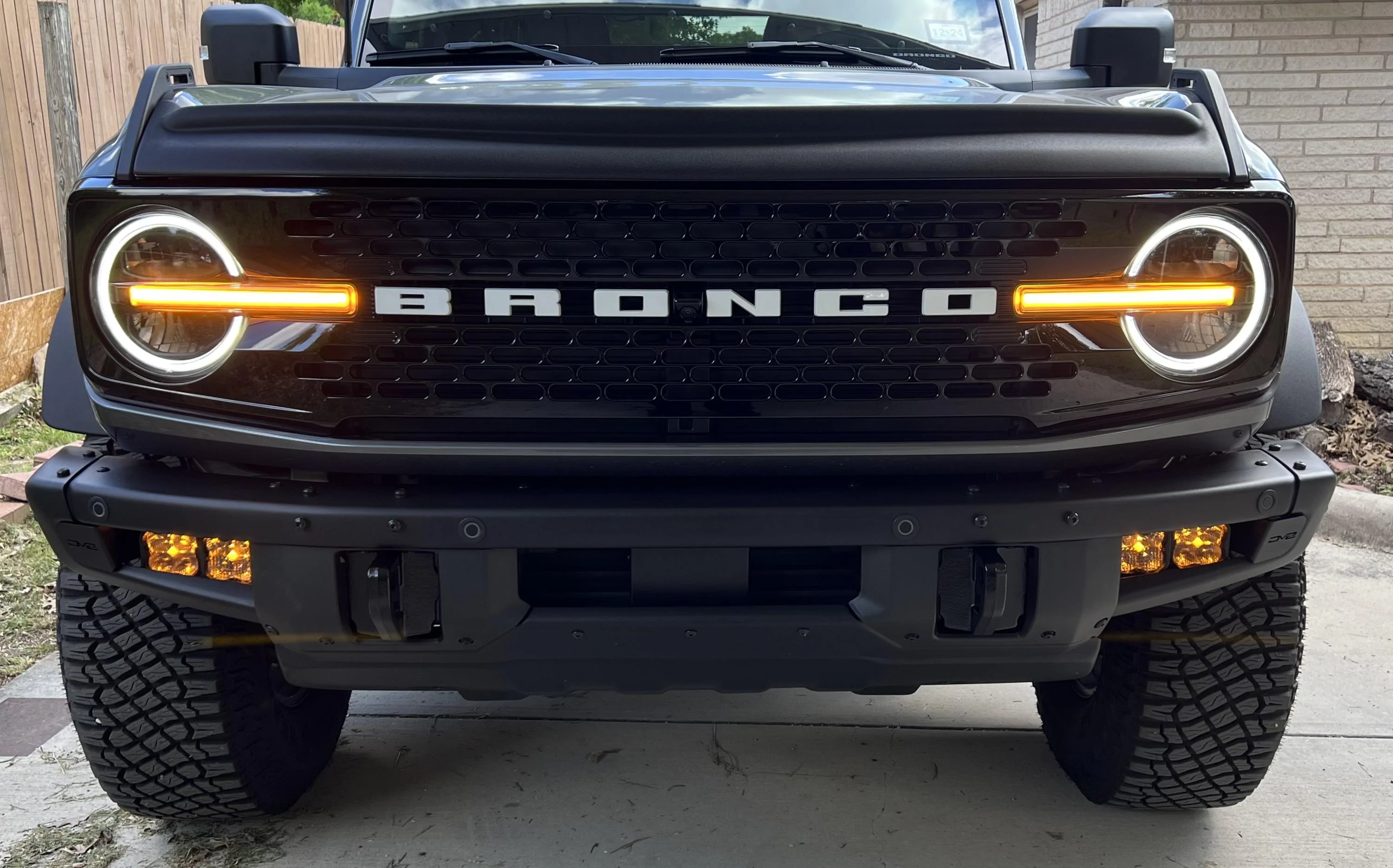

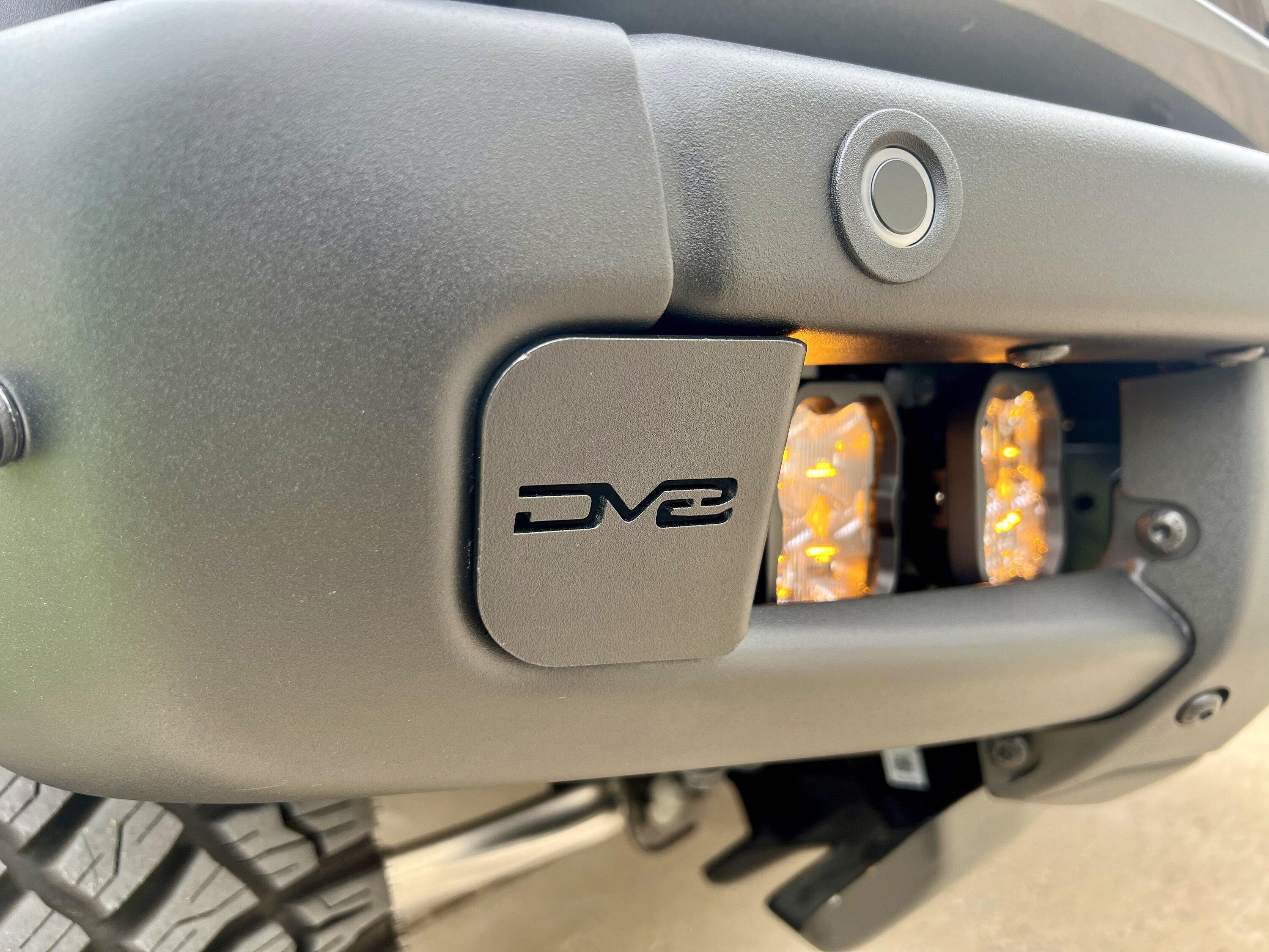

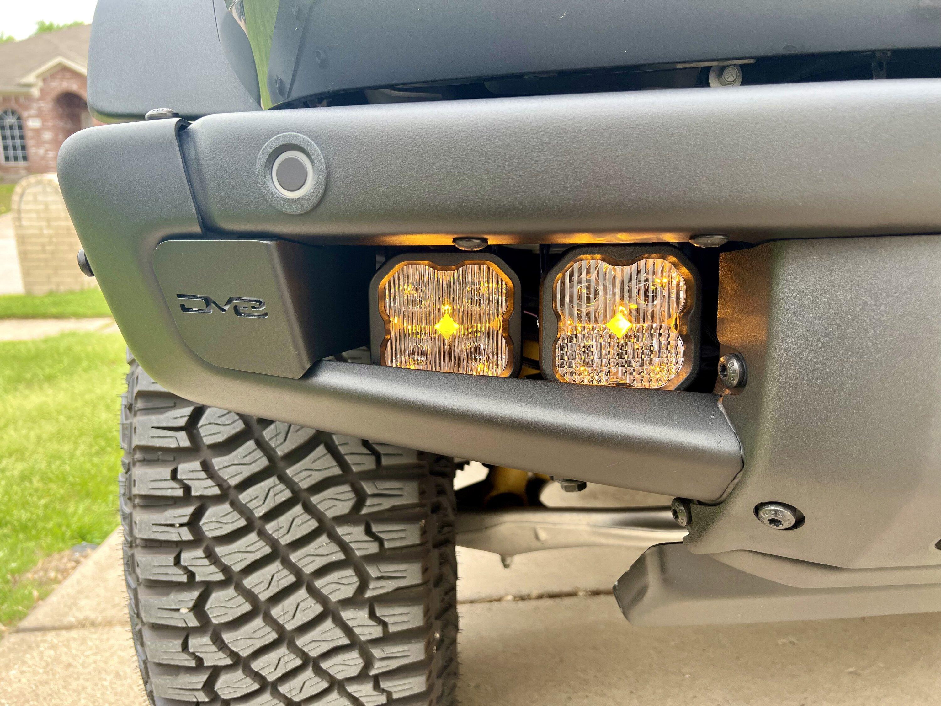

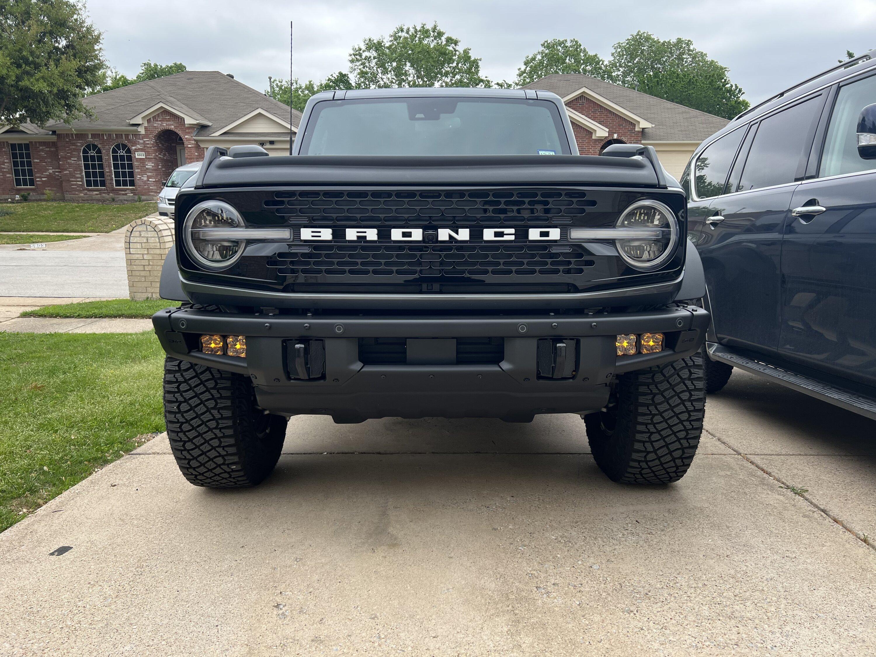

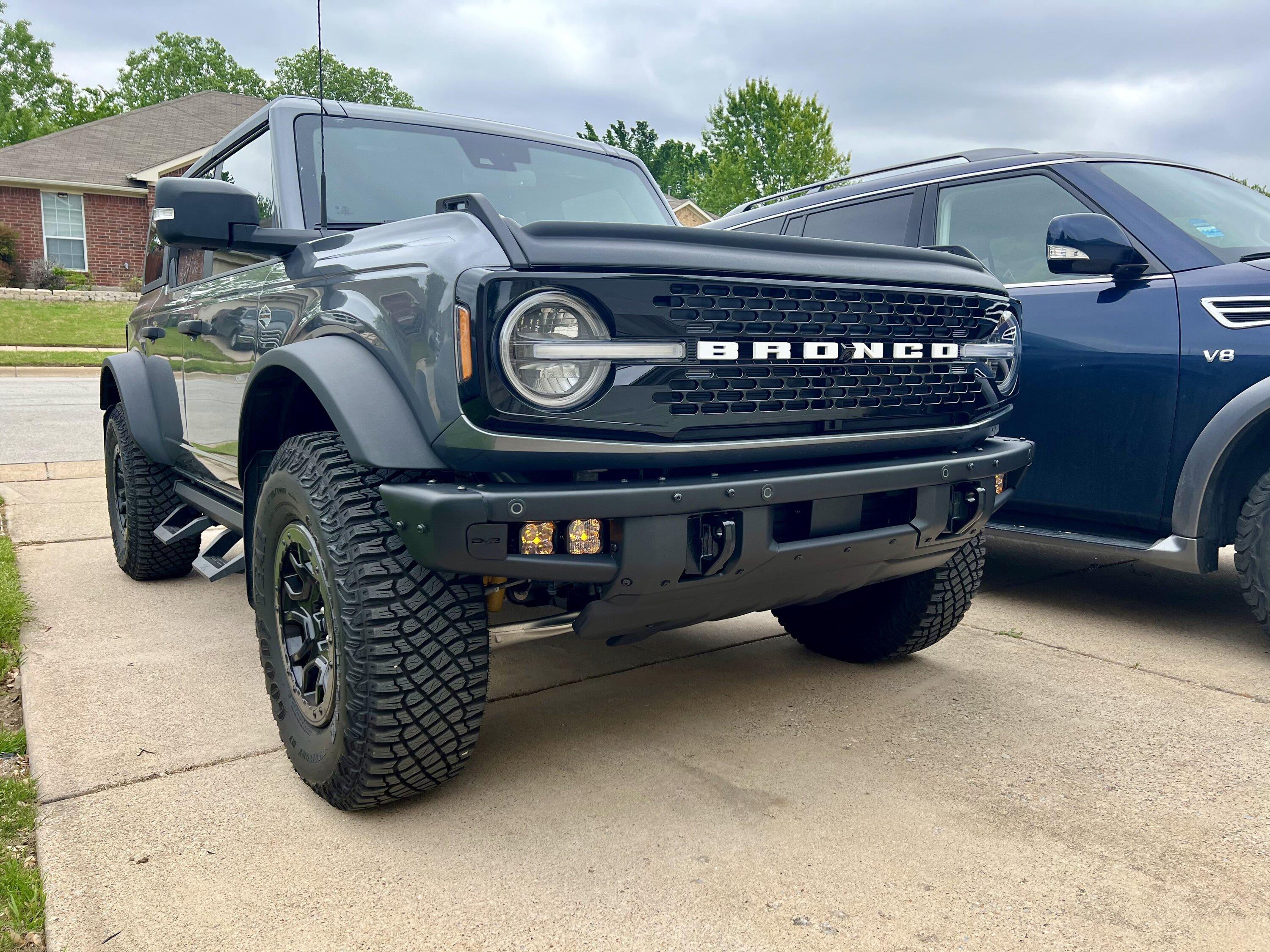

Finally finished up the install and I’m pretty happy with how they came out. Have been wanting fogs but not really liking how the three lights look crammed in there. I really like the look of 2 lights in the pocket but again didn’t see anything that caught my eye. But then ran across the dual fog light brackets from DV8 Offroad that’ll hold two 3” pods so I jumped all over it. Running one SS3 Pro with the SAE fog lens and the other is also a SS3 Pro with the combo lens. The pictures don’t do the amber backlight justice. It’s a deep rich amber, matches the DRLs pretty good I think. Anyway just another option for those wanting to run duals.

Ok finally got them all aimed where I wanted. Took a while to find a dark field but we finally found one. Super pleased with both the fog pattern and combo. Ditch lights are gonna be next. Just need to decide if I want the Pros or Max!
