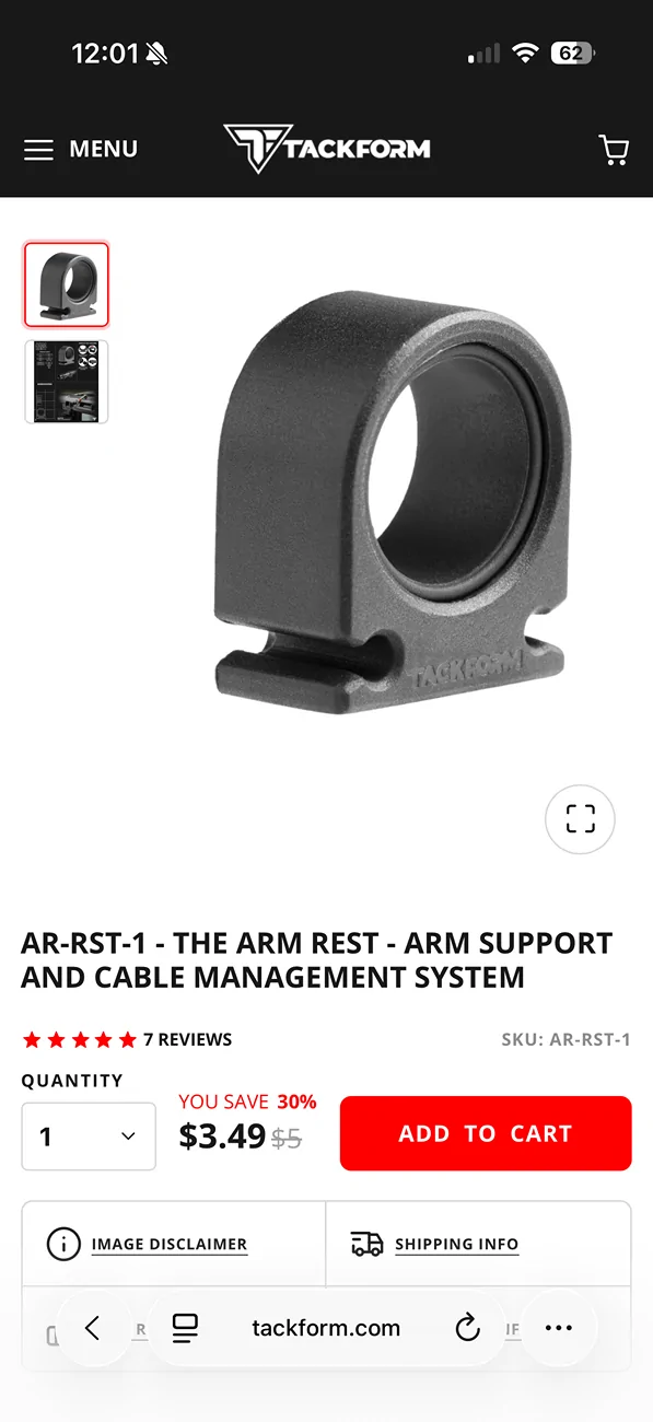

If there isn’t a way to tighten up the dashboard itself, I might try using these.
https://www.tackform.com/products/ar-rst1-the-arm-rest-arm-support-and-cable-management-system
Ford Bronco Dashboard vibration/movement mitigation for BYOD rail IMG_2475

that looks great, let us know how it works out. Thats basically what i did with some scraps.
I had a buddy design me something similar and print it out if PLA, but because it’s a hard surface, it didn’t help. I’m hoping because these are rubber it’ll help isolate.
