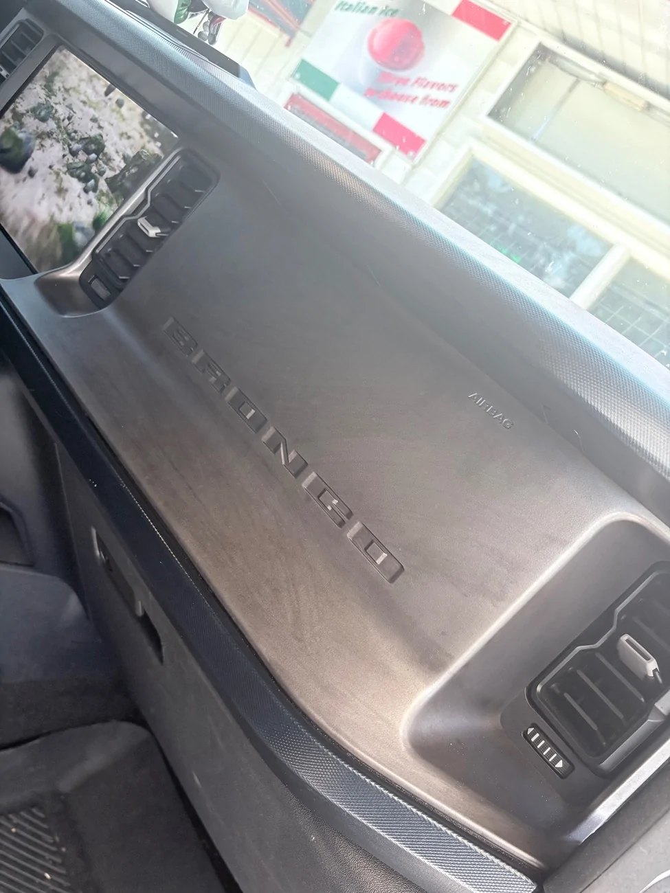

had the sun beat my interior cleaner into the plastic on my dash anyone have any remedies on how to blend it or remove it ?

The damage to your IP is likely permanent as a result of a chemical reaction of the cleaner and the heat. You can try blending it, but will likely have to replace it.

that's what i figured just didn't know if anyone ran into the same issue i think i basically tried every thing to get it off lmao and i bought it a few months ago id have to check the updates

Not that it does you any good right now, but for others reading, it is best to test detailing products on inconspicuous components. Apply to an applicator and not spray directly on the surface.
There have been instances where air fresheners have melted the interior plastics.

In another vehicle, I reduced the appearance of this with a heat gun and iso alcohol
Can't say if it was the same plastics or cleaner as you used. I have never tried it on my Bronco.

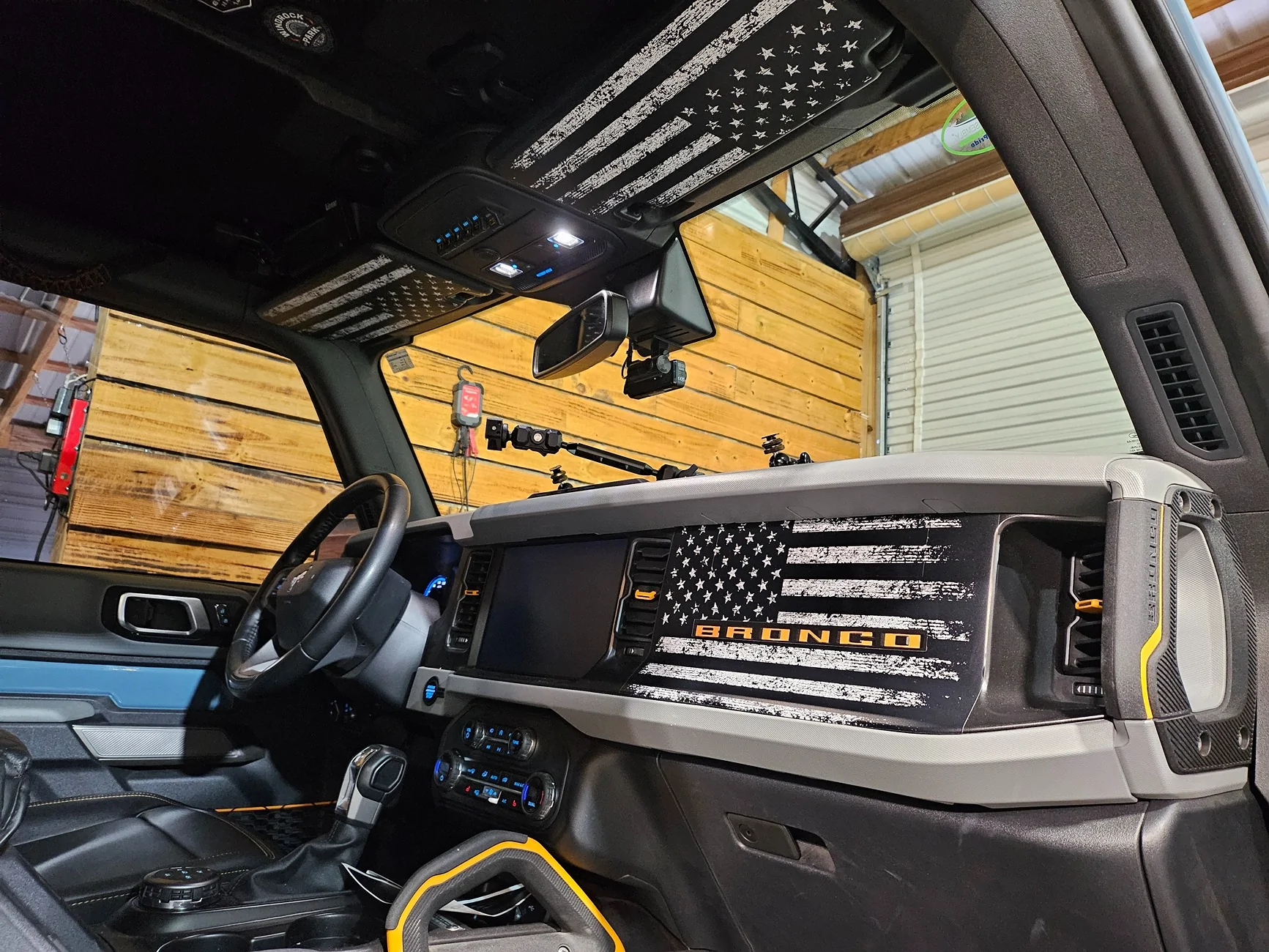

There are several companies that make vinyl overlays for that area. Just another option rather than replacement. I went with a flag style .

yeah forsure that looks good ! i was debating on it just for the fact of my dash is grey and with a black overlay i feel would look a bit funky urs is black so u could probably barely tell its a overlay it looks good !

Mild soap and water on a damp washcloth, clean damp cloth to rinse. Dry it, then use 303 aerospace cleaner as directed, then 303 aerospace protectant as directed (with damp cloth, then immediately wipe off with “clean” damp cloth)
May or may not work, but I’ve gotten scratches out this way on our Bronco dash.
I’m not brave enough for a heat gun on those plastics, large risk of me messing something up worse.
