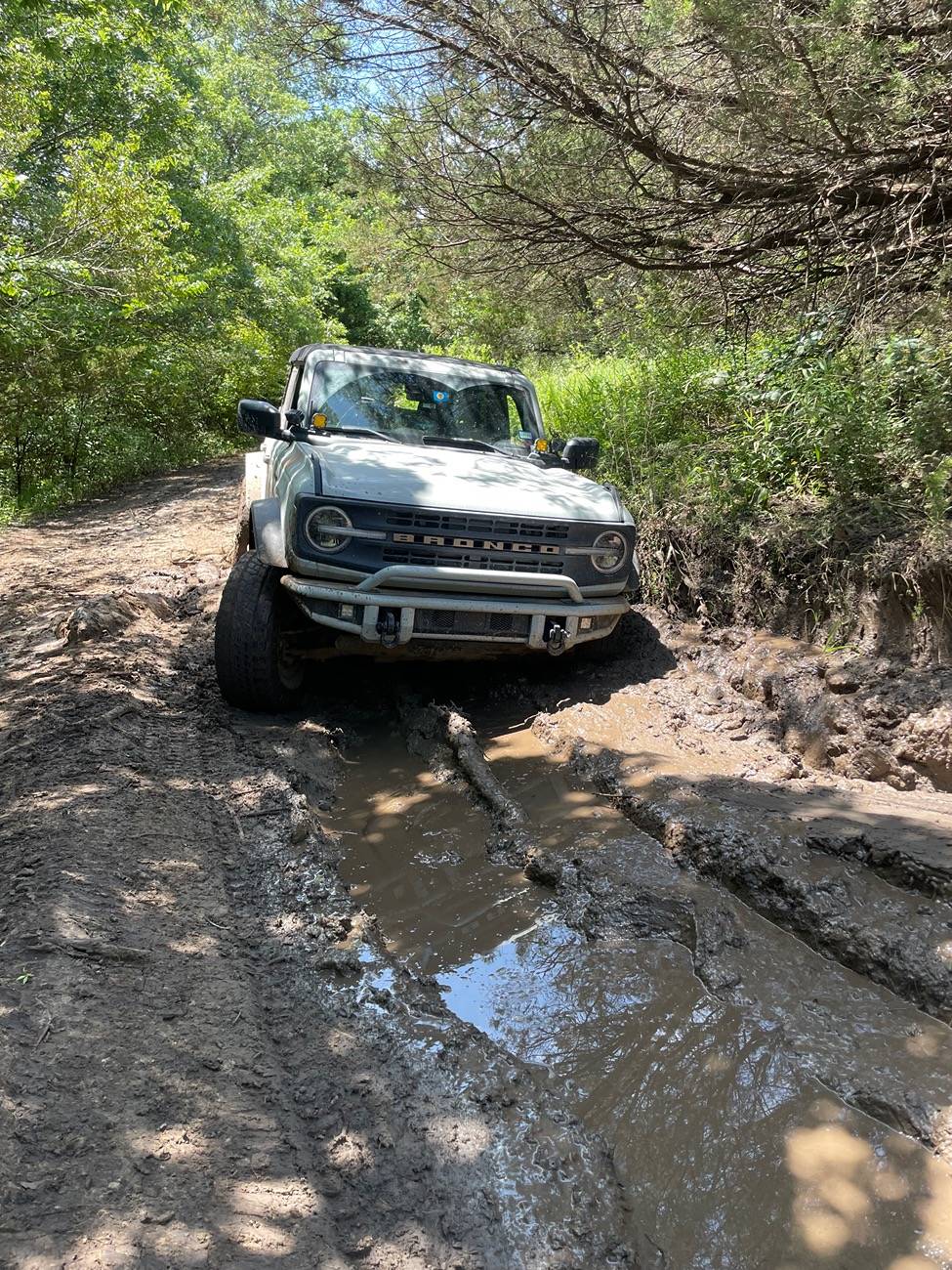

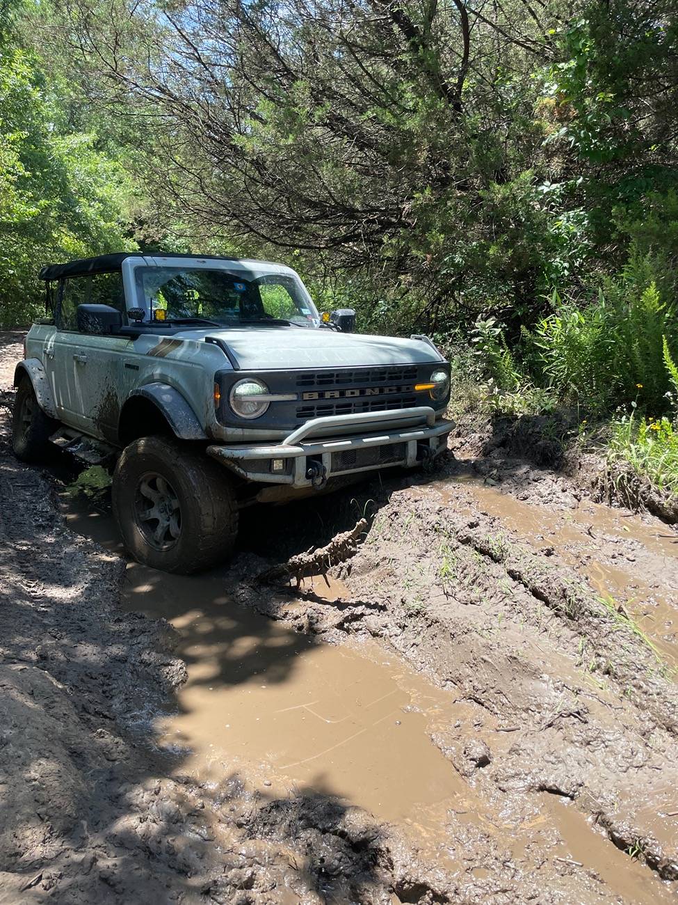

So funny story- was out wheeling this past weekend and got it stuck in a deep mud rut and exact same thing as you- ABS, traction control, collision assist and GOAT modes- exact same 4 systems- all down.
well with no 4x4 I had to call for recovery. Learning something new every time😂

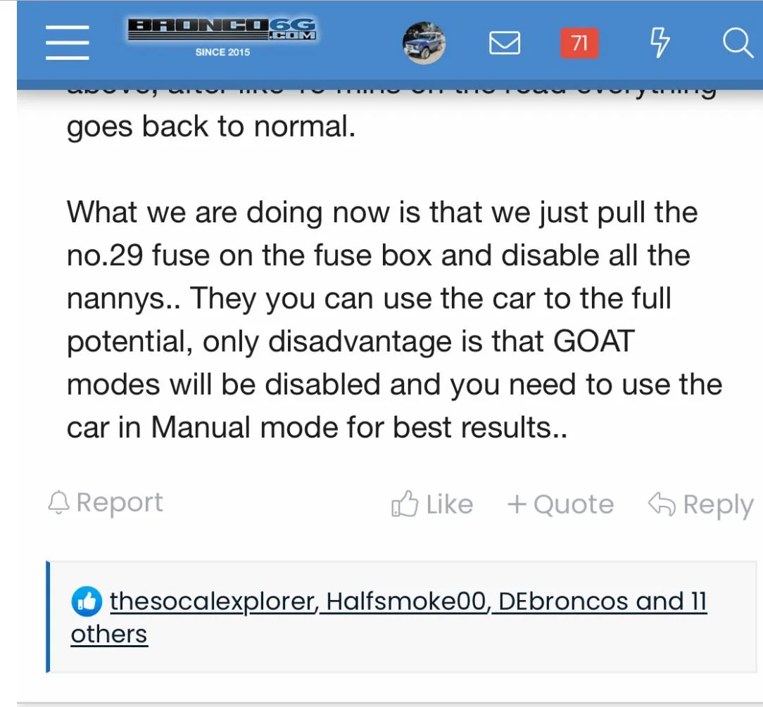

Remember fuse 29.
