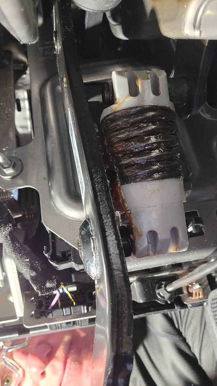

The dealer couldn't fix it, so I took a look and noticed that I could feel the creaking when touching the clutch spring attaching points. This is the spring I am referring to (shown looking toward back of the vehicle). It's attached to the clutch pedal. The white plastic parts is where I could feel it when making it creak.
Ford Bronco Creaky Clutch Pedal possible fix 20250605_101905

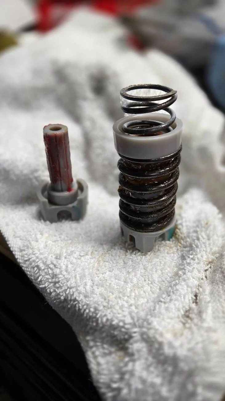

I removed the spring and could feel the stiction in the spring when compressing it slowly.
This video shows how to remove the spring assembly (note: I did NOT change to the Steeda spring). The removal starts about 1 minute in:
I pulled the 2 halves apart. There was grease on it, so I thought I would clean it and put on new different grease.
Ford Bronco Creaky Clutch Pedal possible fix 20250605_103718
I used red wheel bearing grease that I had. It was:
https://www.valvolineglobal.com/en/multi-purpose-grease/
I put it back together and it was smooth with no creak. I think the pedal effort even felt lighter (I did NOT change the spring)
As mentioned above, I found that this grease is not recommended for plastics, so maybe there's something out there that's ok for plastic, but better than the factory grease.
I'll try to remember to post an update after I have spent more time with it.

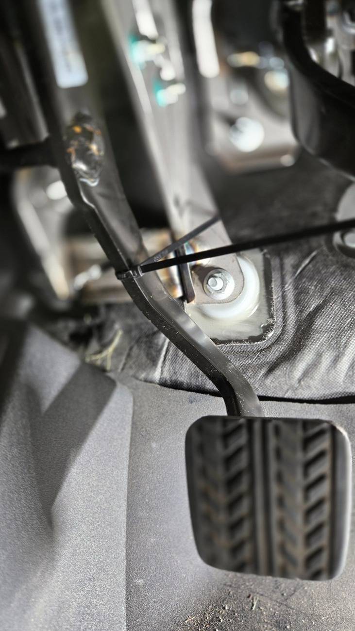

  • I used a regular pair of needle nose pliers to remove the C clip. But I heeded the warnings in other threads and comments to cover the area behind and around the clutch assembly so that the clip didn't accidentally disappear behind any trim pieces. I stuffed paper towels into every nook and cranny I could see. This saved me from having to disassemble the trim not just once, but twice. That little clip can EASILY get lost if you don't take precautions.
  • The zip tie tip to hold the clutch pedal back was genius. There's not a lot of room in the footwell to work. Don't try to hold the pedal in with a stick. You'll likely just knock it loose, and you don't want the pedal suddenly coming free with your hands stuck up in there.
  • Again, the footwell space is very small and dark. Get lots of light in there.
  • Did I mention there's no space to work in there? If you're a large person, tall, or not very flexible, don't bother trying to do this yourself. Seriously. It is not easy getting the reassembled spring back into place.
  • Wear gloves to protect your fingers. Springs under compression can easily cause busted knuckles and injuries.
