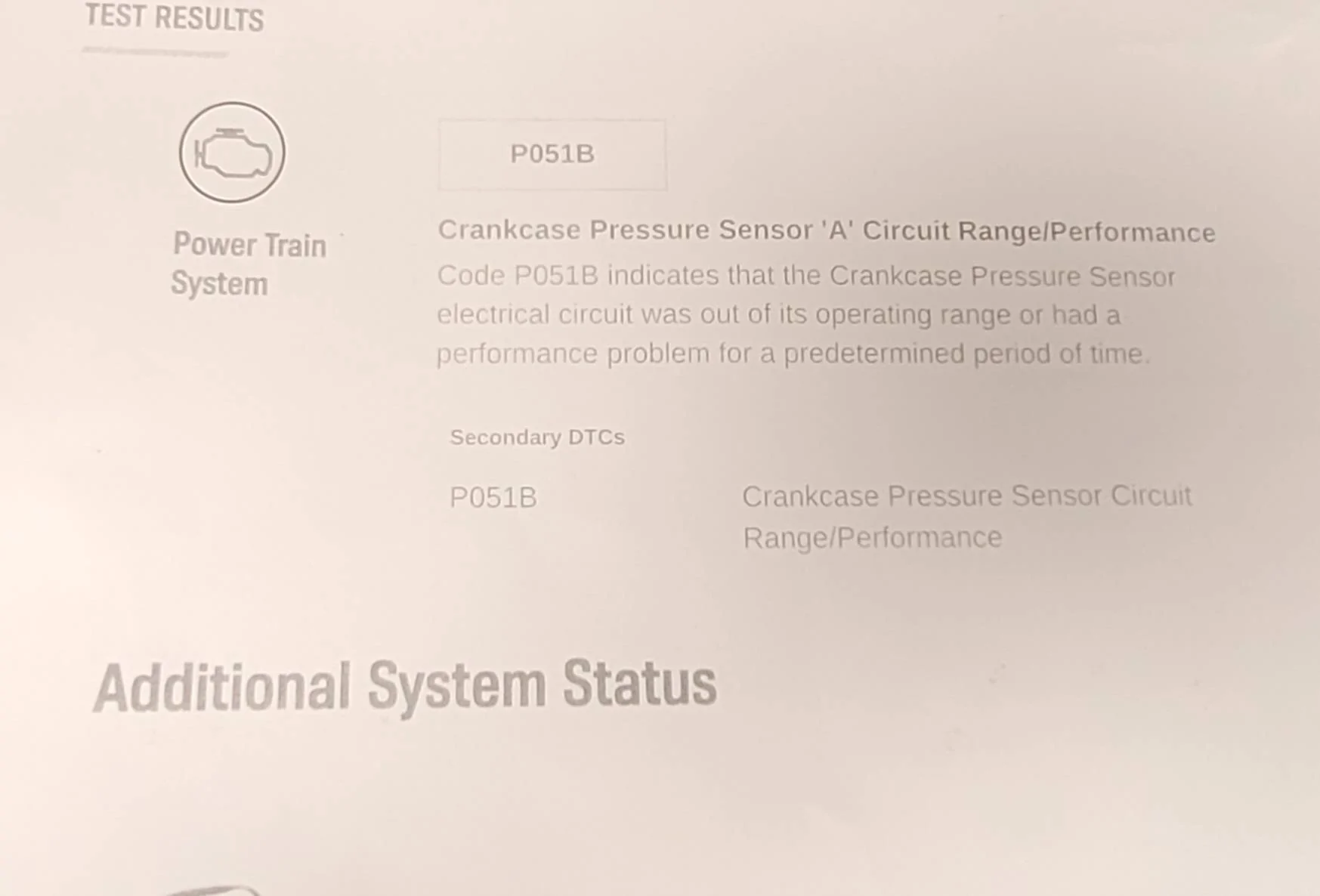

Did you received a Crankcase Pressure warning like I did?
Ford Bronco Crankcase Overpressure 20240913_094456

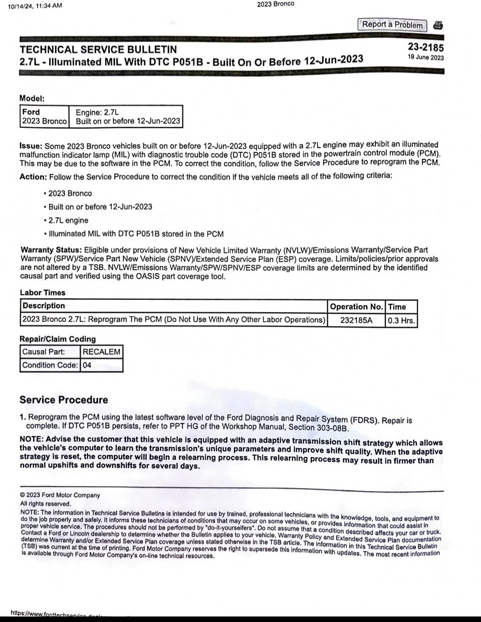

I have that code stored in my connected vehicle data (P051B), never had the CEL for it but it pops up there. There is a TSB for a reprogram. TSB 23-2185 for .3 to reprogram.

Dealer flashed the PCM due to a TSB related to misfire codes and CEL cleared and engine runs smoothly again. Injen gear under the hood and all.
Ford Bronco Crankcase Overpressure IMG_0002

Yet the truck was in the dealer 2 weeks, and I was told everything it needed two new injectors, a couple of coils after days of them driving and diagnosing to find nothing. Then this TSB was discovered, they executed it and problem fixed.
