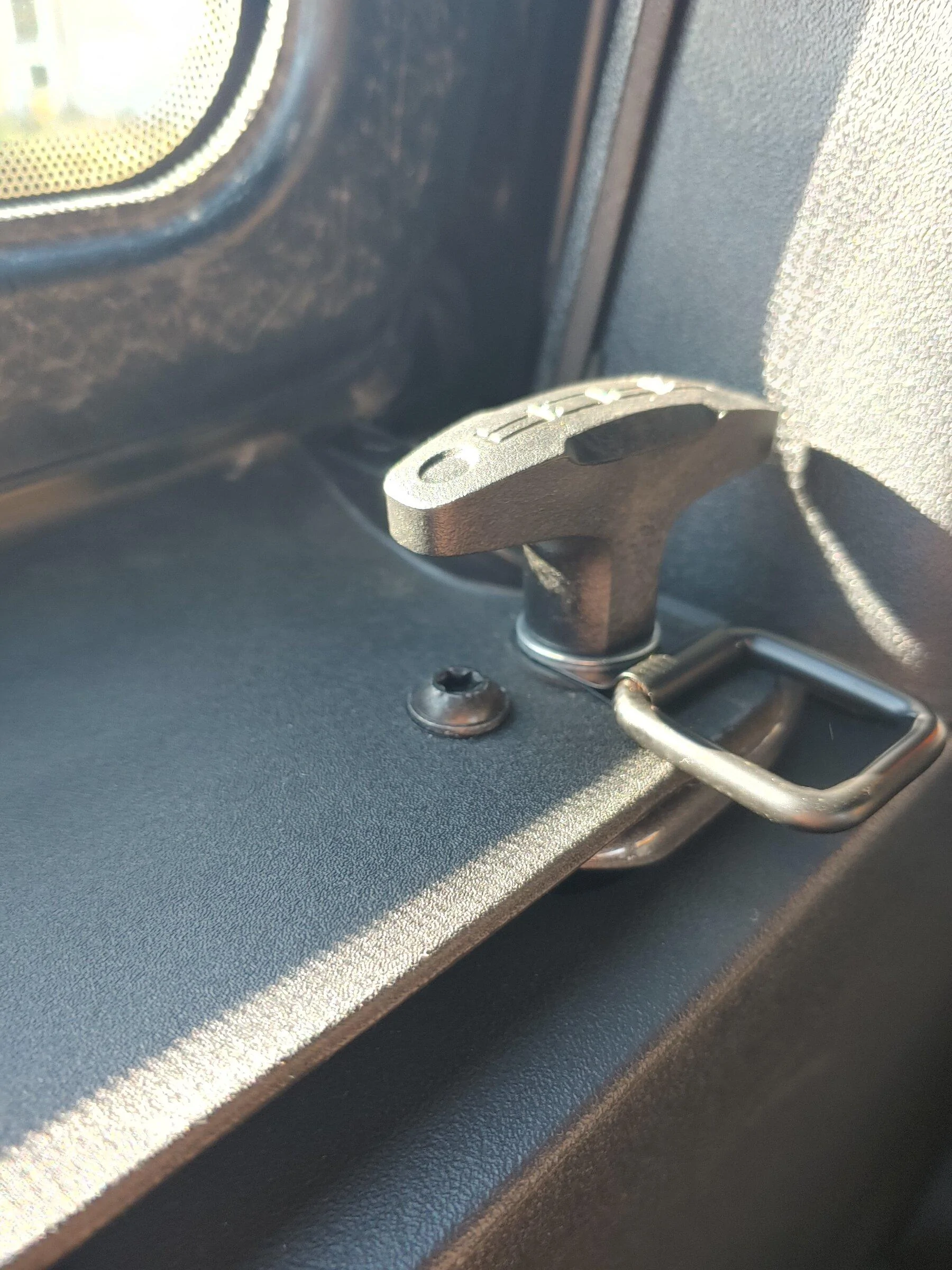

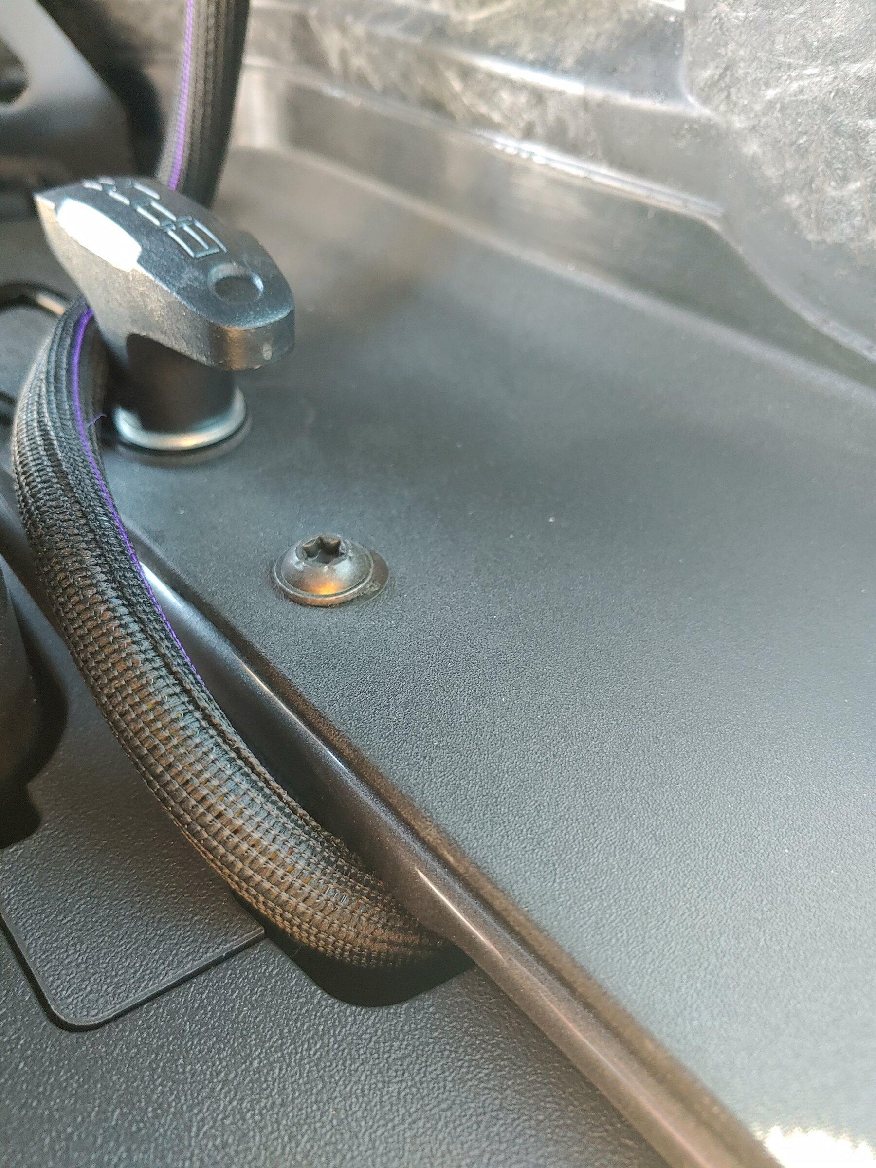

Pretty sure the extras are for hard top alignment. Don't think you have to pull them out. They have a little nub on the bottom that drops into a hole.
wonder if there's some thumbscrews out there that might fit... if they're not just guide pins

Nice! I was just wondering that because I just watched a few hardtop removal videos and none of them mention these bolts. I guess it's just the ones on the very top that still have to be removed with the socket wrench then?
This.
The 4 smaller screws hold the alignment pins and are not supposed to be removed.
In summary, there are 4 bolts on either side in the cargo hold and 2 on top for a total of 10 bolts that need to be removed in a 4-door, all of which are the same size.

This.
Same for the two door!

I just recieved the GPCA tie down anchors. I installed them thinking that they were supposed to be a quick release option for the hard top and eliminate the need to use the socket wrench. While installing the 8 bolts, I realized that there are still 4 smaller T30 bolts that have to be removed as well. So I still have to pull out the socket wrench for these bolts when removing the top. I guess I was under the assumption that these anchors replaced all the bolts holding down the top. 😒
https://www.gpca.us/shop/bronco-tie-down-anchor-pro/
