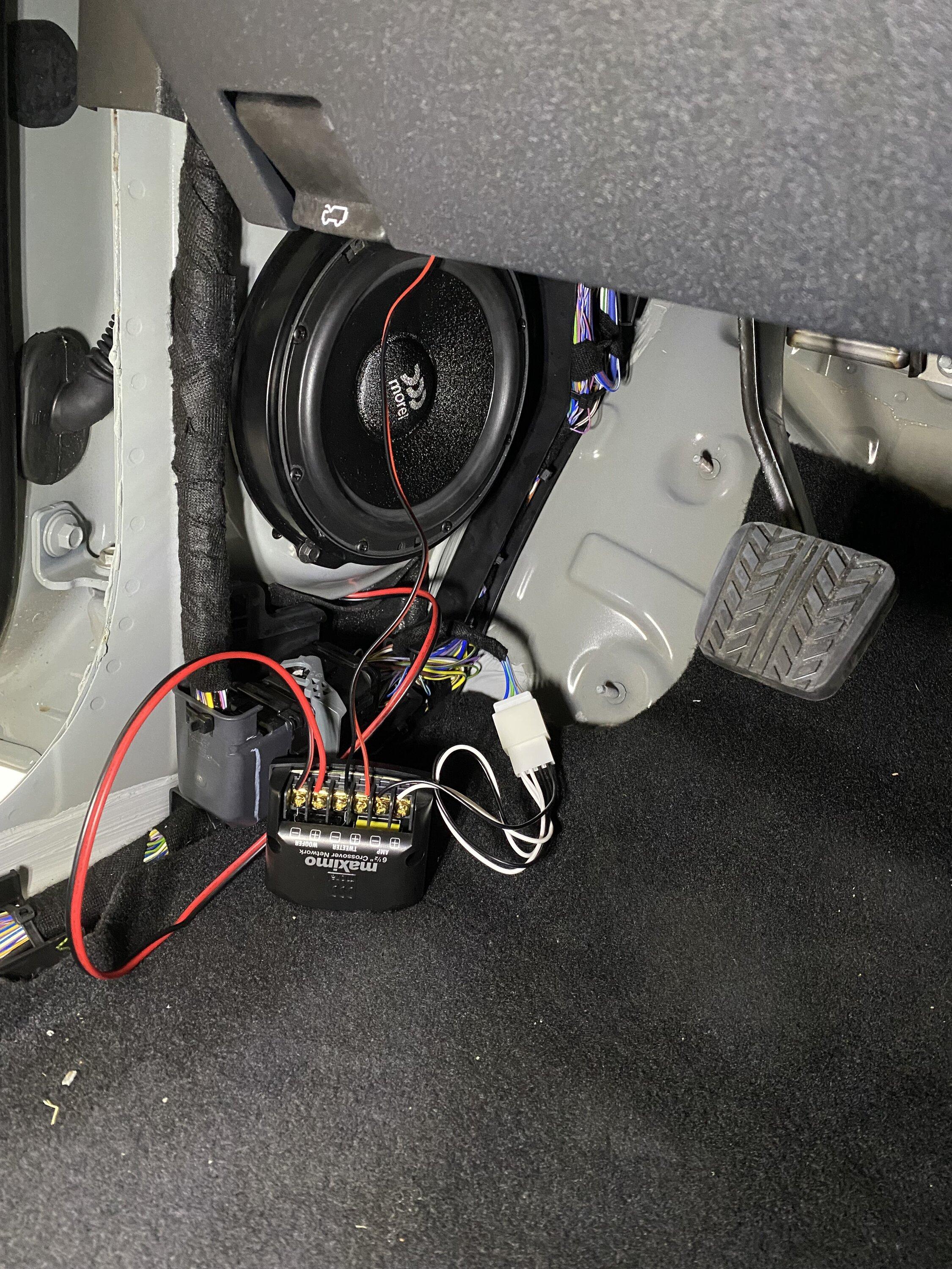

If you look at the following picture (another members picture), the kick panel harness is wired to the amp terminal on the crossover, which is what I've been getting at.

Yours should look exactly like my picture. Correct me if I'm wrong but, with the kicker Key, it continues to utilize all the factory speaker wiring for all locations. The crossover is passive so it won't need actual "power", it will just take the signal from the factory wiring and divide it.
You're going to want to just ignore the dash speaker wiring if you want the crossover working with the kick panel speakers (it will sound better splitting the kick panel since it receives full range from the stereo). So, plug in the the factory wiring that was connected to factory speaker, into the amp terminals on the crossover, just like I have it in the pic. Then, run new wire to the mid bass speaker in the kick panel and new wire to the new tweeters you're putting in the dash. Simple as that! It's going to sound even better than my setup since you'll be sending some extra juice with amp.
