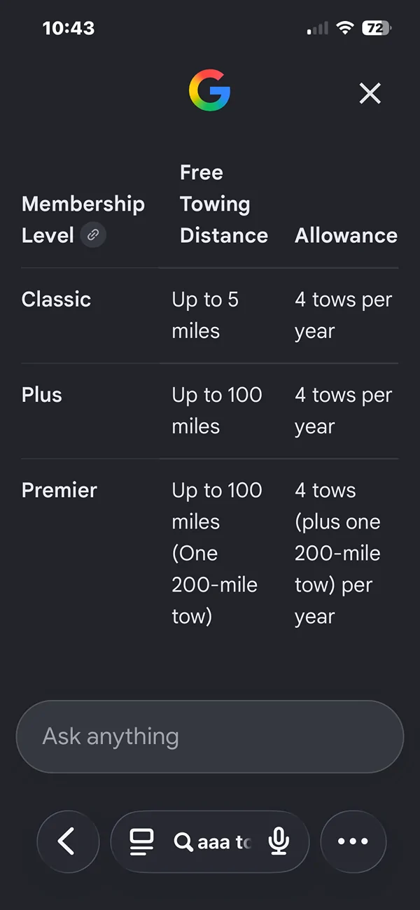

I have AAA. You get free hook-up and 5 miles. Or the closest AAA shop.
My mechanic is about 20 miles. Ford Dealer is 10.
Lost a water pump on an F-250 halfway between Barsto and Needles. That was a free 100 mile tow because that was the closest shop.
Ford Bronco Clutch Master Cylinder?  Exploded IMG_9088
Have gotten a vehicle towed a couple hundred miles… Called got it towed two hundred, called again towed one hundred, called again another one hundred miles…. All for same break down
Yeah, considering upgrading to "Plus" now. But these are basically brand new vehicles we have (2020 and 2022). It's not like I'm still driving a 69 F-250. (though at least I could fix that myself)
