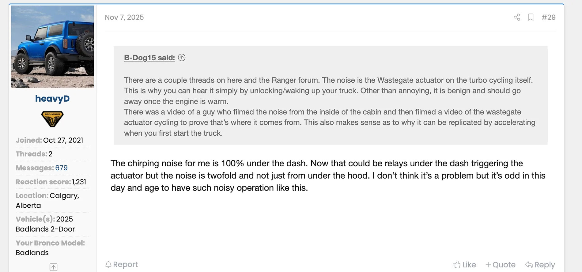

You may be experiencing something different then. However I thought the same thing until I realized I can hear the noise from outside the car simply by unlocking the car and listening. Others did a deeper dive and found the turbo wastegate actuator to be the cause.

Same issue here. '25 Badlands, 2.7L. Definitely sounds like it is under the dash rather than underhood.

I have the same chirping / cricket sound from the same area. Dealer does not know what is
causing it. Not super annoying...just very odd !!
