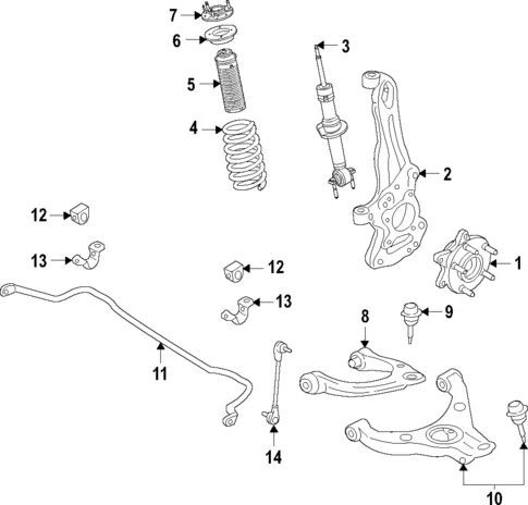

Did you double check you front coil over top plate nuts in the shock tower? The three nuts may be loose and causing the knock sound while on uneven terrain.
Suspension was originally my thought but then it felt like it was coming from the door too much.
Is this something I could visually examine with the hood open or will I have to take the wheel well protector rubber out. Or can I look under the car?
In the attached diagram would it be part 7 nuts?
Ford Bronco Knocking sound from bottom driver side door. 665bc98a880e28192ef1c01ffcb1861

22 2dr
@Arealhuman

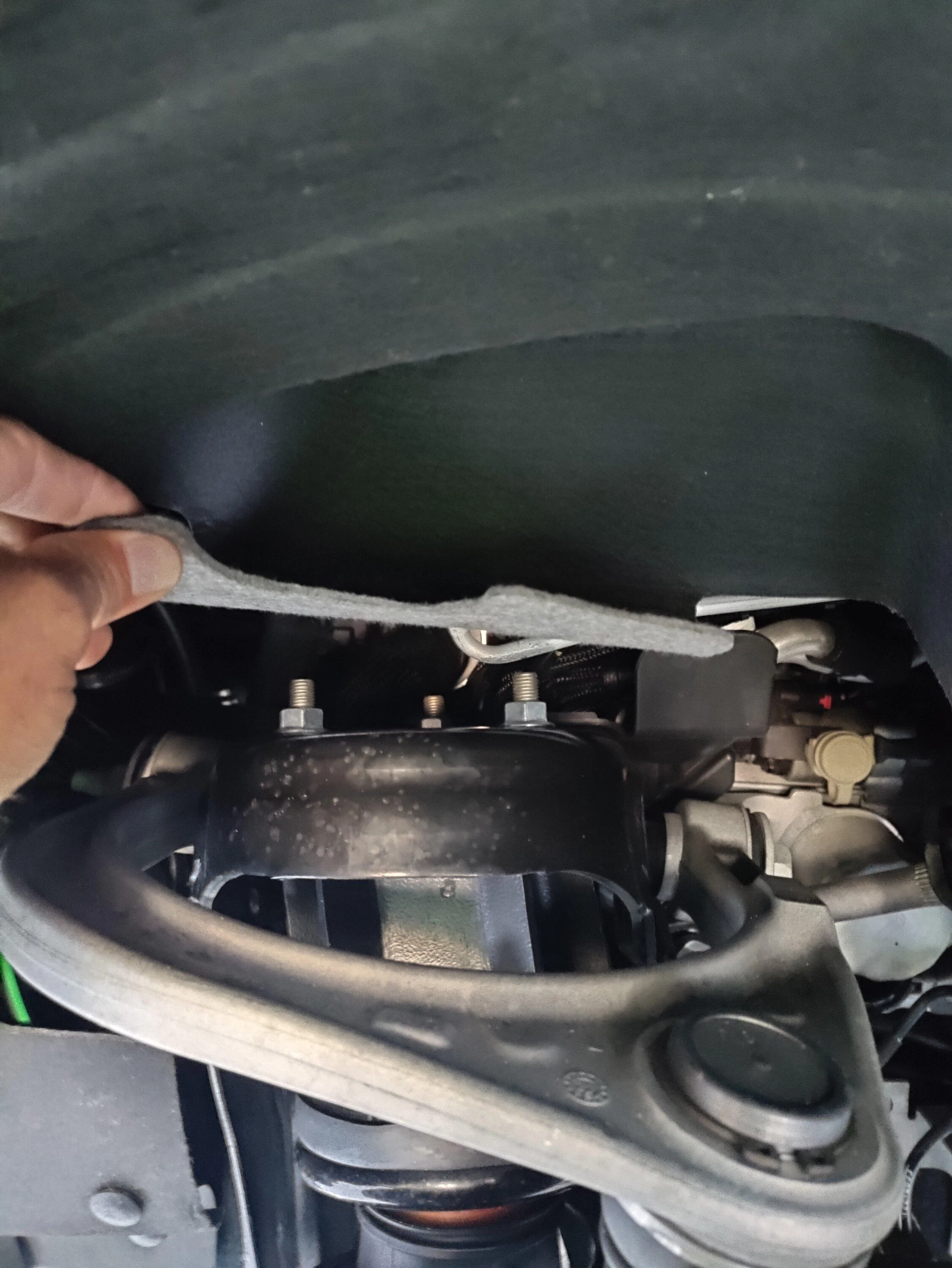

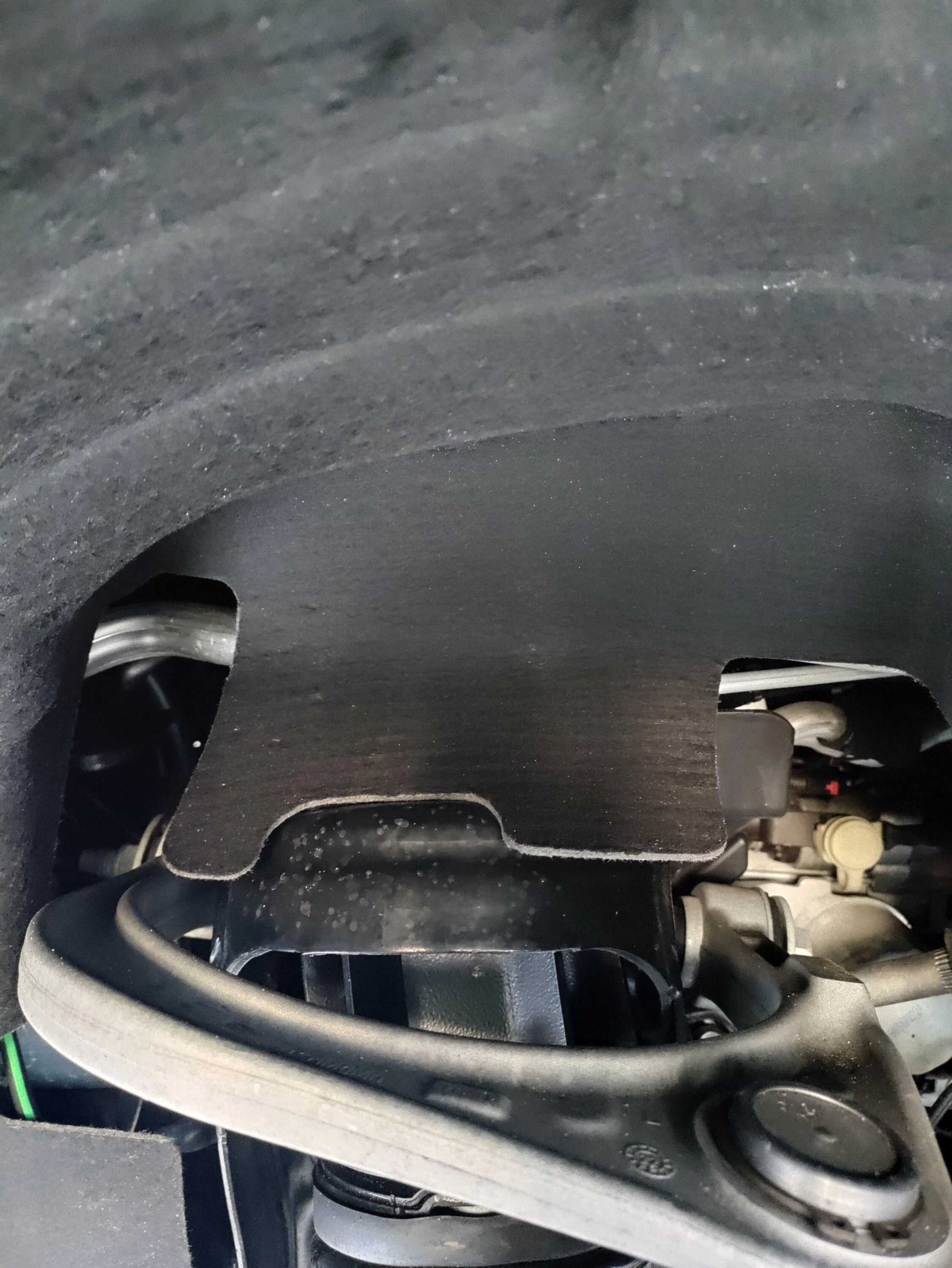

Yes you can take a wrench to all three without removing anything. At the top of the coil over there is a felt flap that is part of the wheel liner. You just lift up on that flap and all three nuts are visible and able to check for tightness.

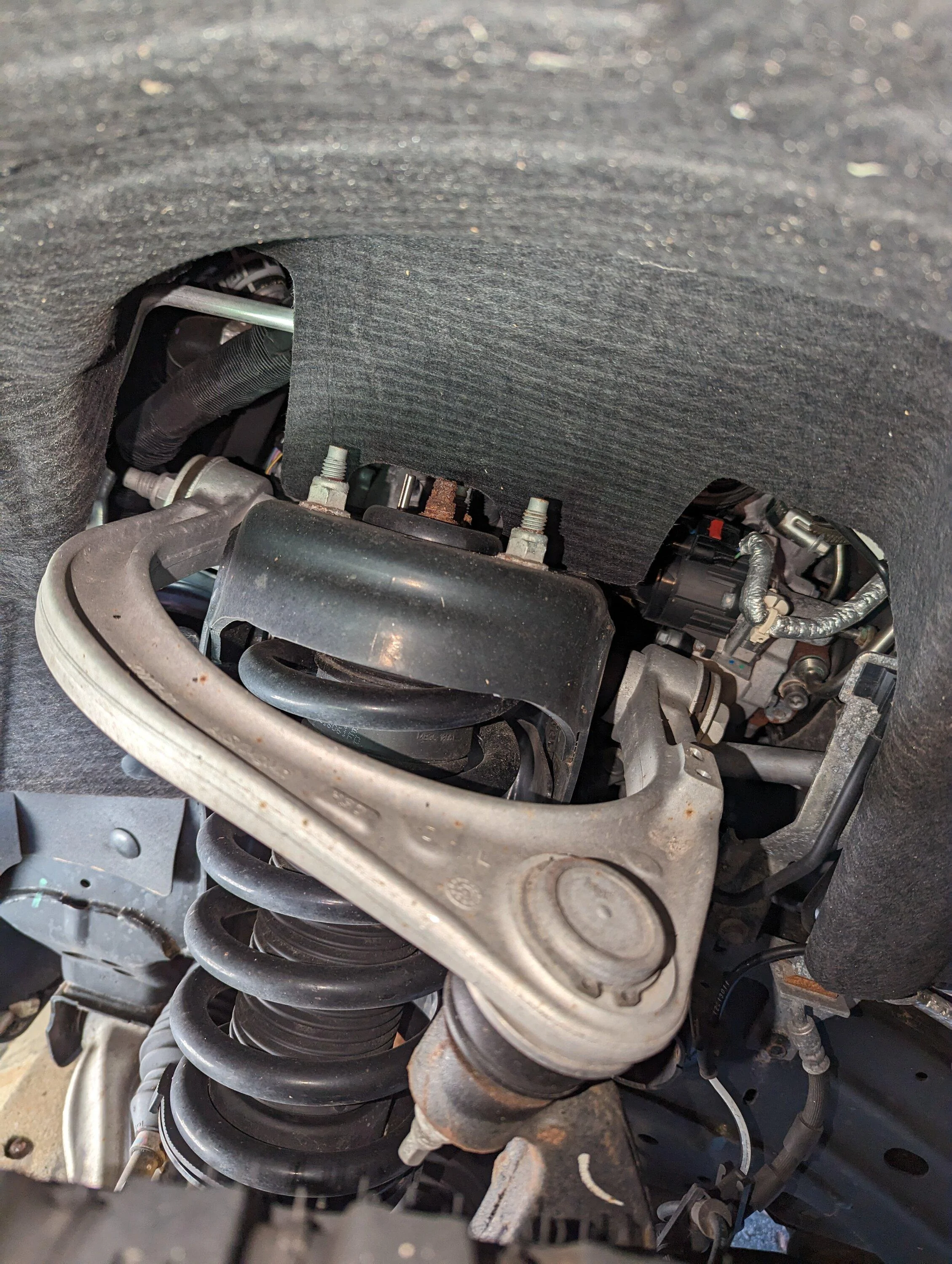

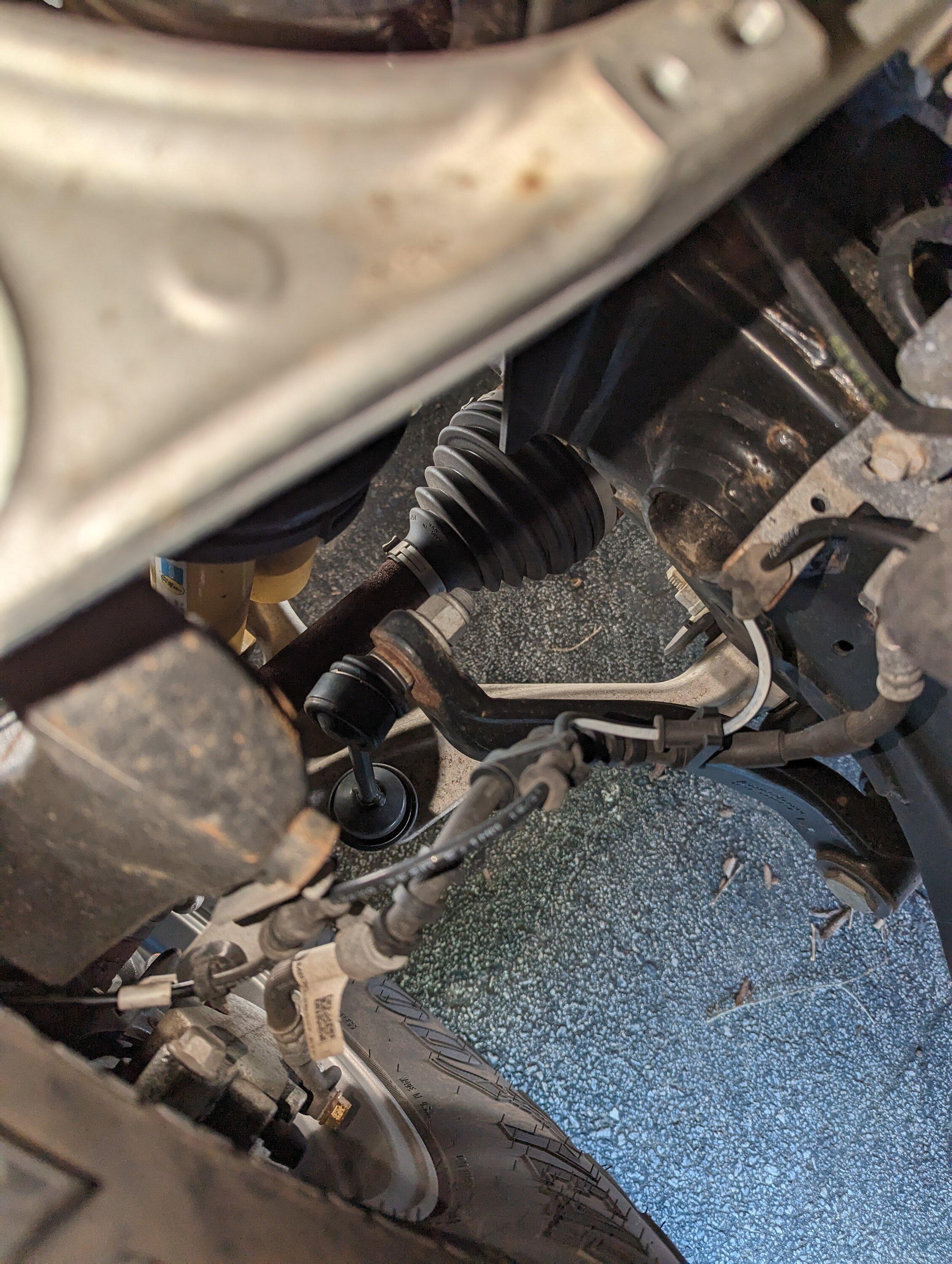

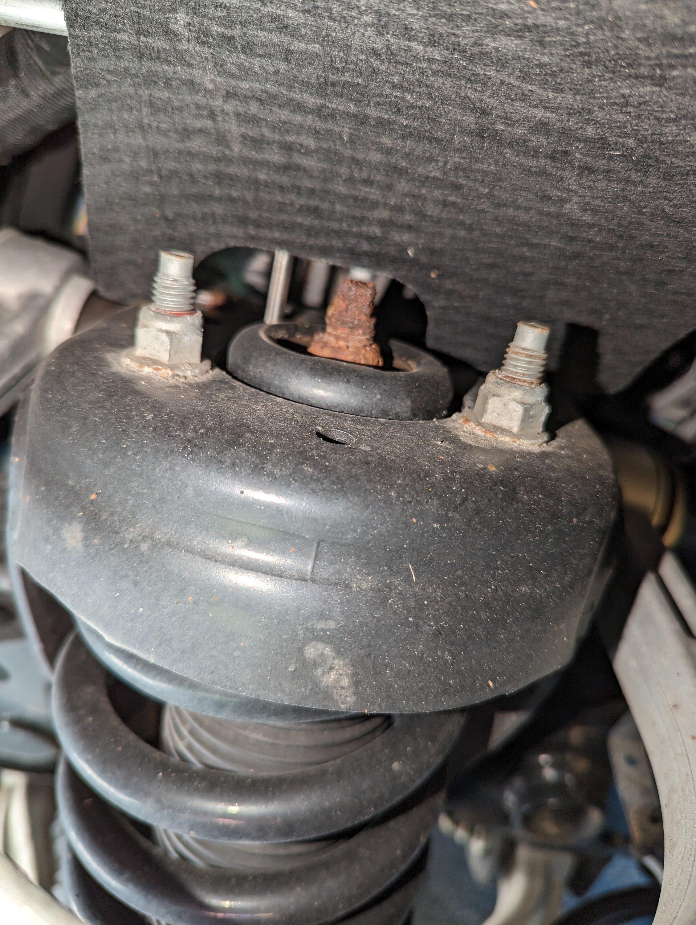

Hi James. Can you send us a DM with your VIN and dealership info? I can look into this for you.
Arealhuman
James
Oct 12, 2021
55
127
Massachusetts
2021 bronco first edition
Idk if you just took these, but thank you so much for going out of your way.
I've attached pictures. Mine looks nowhere near as clean. I guess Winters in the north have taken a toll. But it looks like the screw isn't an issue. I'll be taking the door off in the next week or two.
