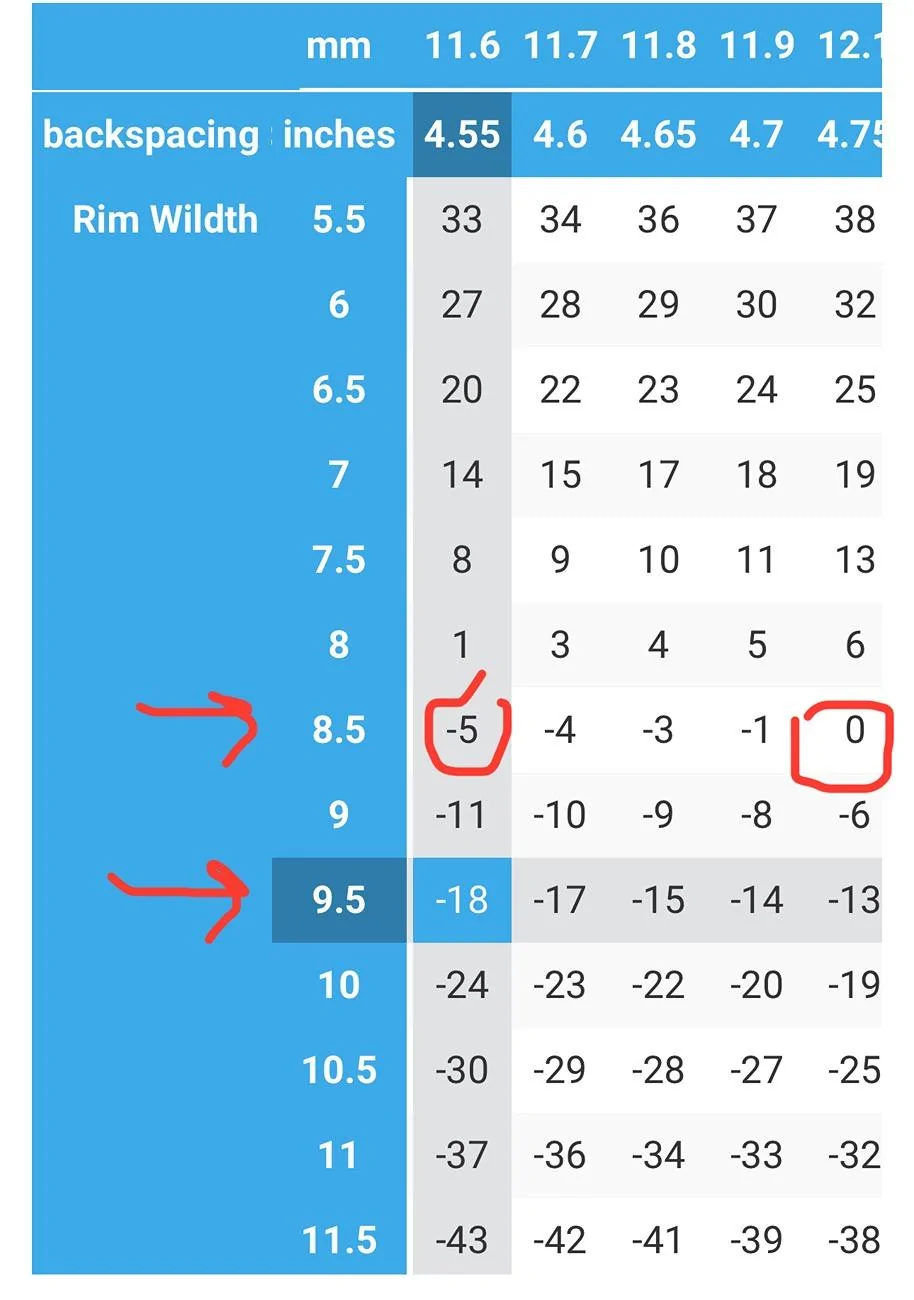

@lexi666 assume you were asking about the fender flare because you liked the wheel poke. If so, be sure to evaluate wheel specs as well.
Those look like Black Rhino Axle wheels. If so I would further assume they are 17” and only one size is available for 6x139.7 bolt pattern.
17x9.5 with -18 offset, 112.10 bores, 34.40#
Those are wider than most options talked about on here. SAS wheels and a slew of aftermarket options are 8.5 wide. A few are 9 wide but not many are 9.5 wide.
I mention this because wheel width has to be factored in to equally compare wheels. For instance, many here often run 8.5 wide with 0 offset. In the screen cap of the chart below, you can see a 9.5 wide wheel with -18 offset is comparable to an 8.5 wheel with -5 offset.
An 8.5 wheel with 0 offset is closer to 9.5 wide with -13 offset. So if you were shopping for an 8.5 wide wheel with 0 offset it would have 5mm (approx 3/16”) less poke than the Black Rhino setup here.
While poke is an aesthetic goal for many, it should not be forgotten that more or less offset from stock (adjusted for wheel width) also increases/decreases scrub radius that has other effects on drive quality, longevity, etc.
You could visually gain a similar look running less negative offset and even skinnier flares like the KBD’s or similar and have less scrub radius effects.

Correct
