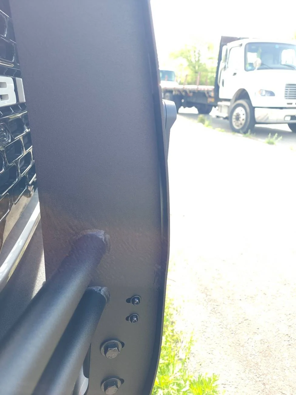

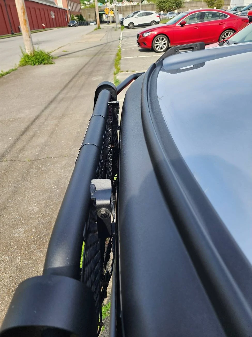

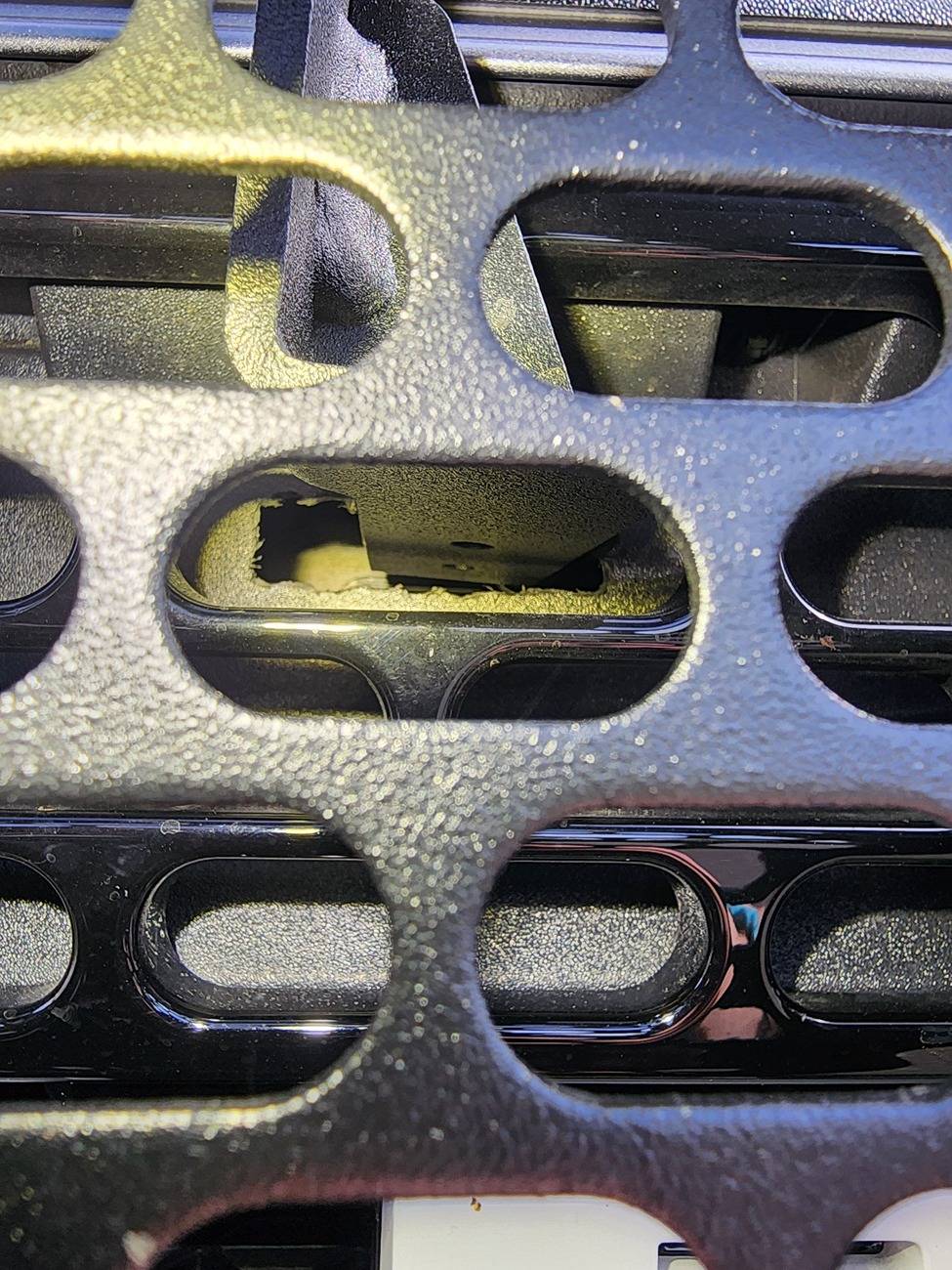

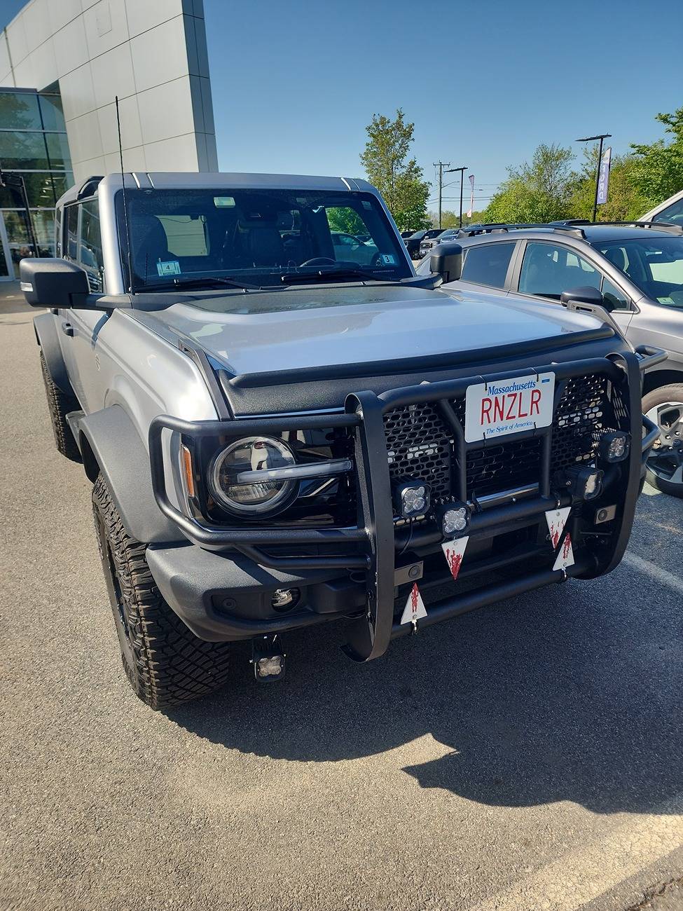

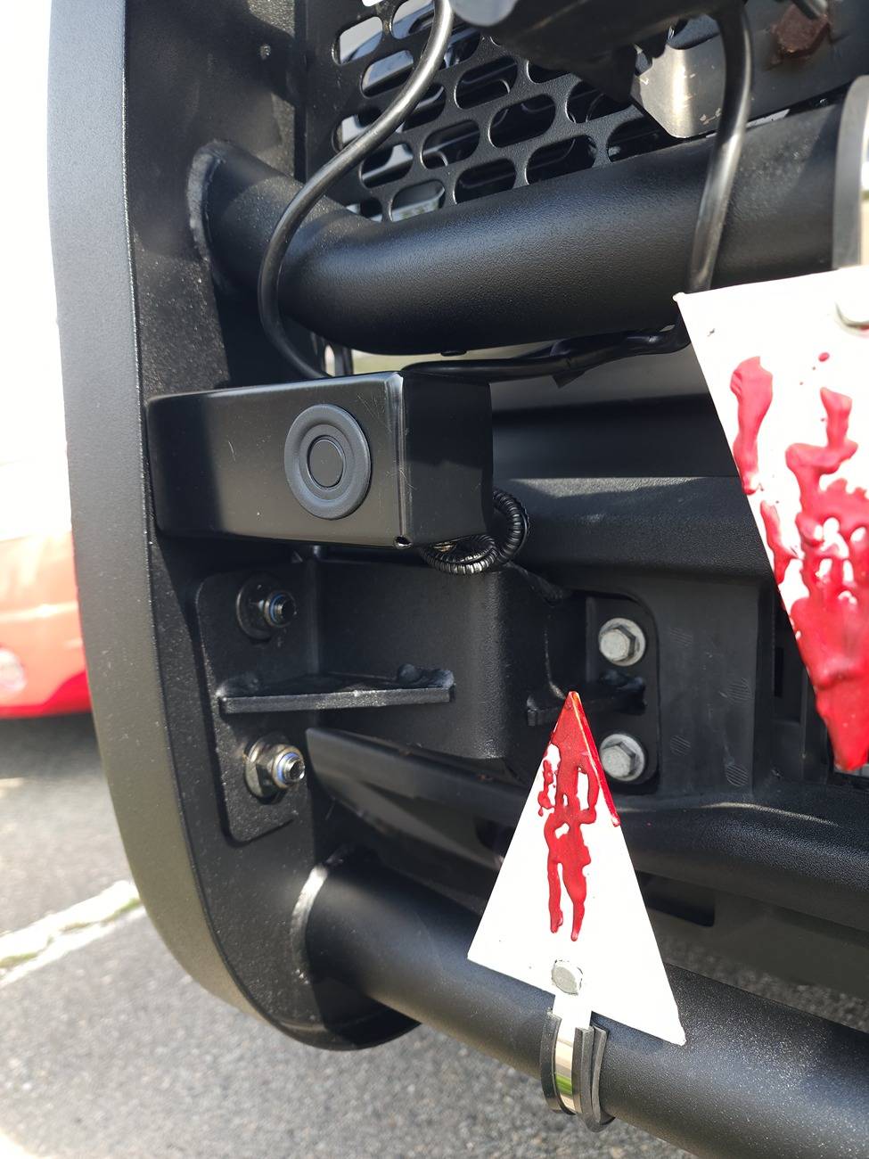

Yes! I'm glad you reminded me to send an update. It came with the bottom-center grille portion installed with some black hex bolts and black split washers. I ordered mine from Elite Truck's website. It was easy to remove and they even included the alan key. Idk what the other fella is talking about with the self-tappers - the grille on mine was installed with seemingly brass or nickel rivnuts for the stainless bolts to screw into. Ignore the terrible placement for my front plate - I was awaiting some pipe clamps so that I could attach the license plate to the bottom bar of the brush guard.
To attach the radiator support on the passenger side, I used a drill to cut the rectangular hole into the plastic trim piece behind the grille for the support to slide through. Basically made a bunch of holes with the drill and then pushed sideways to break the rectangle free.
