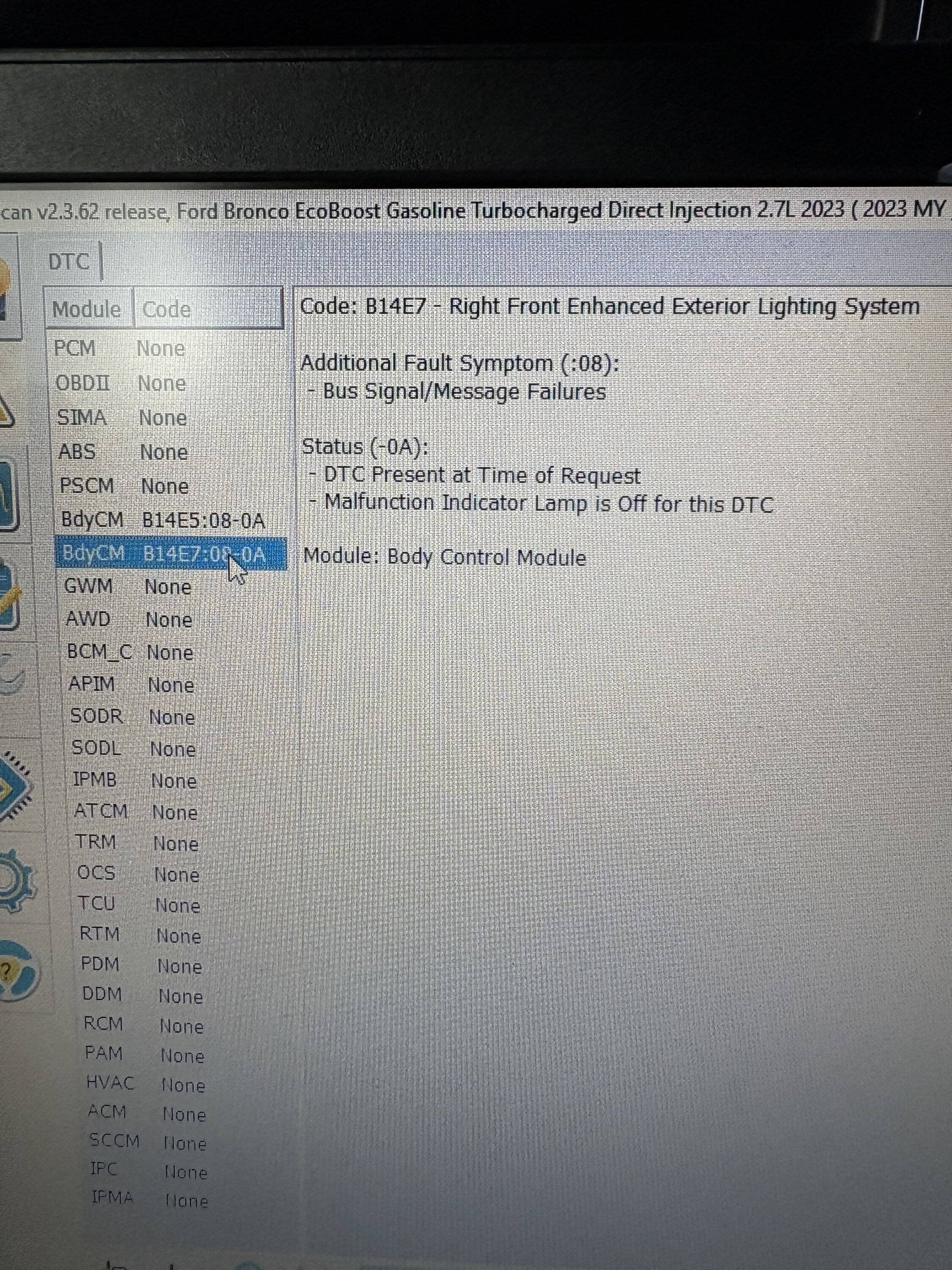

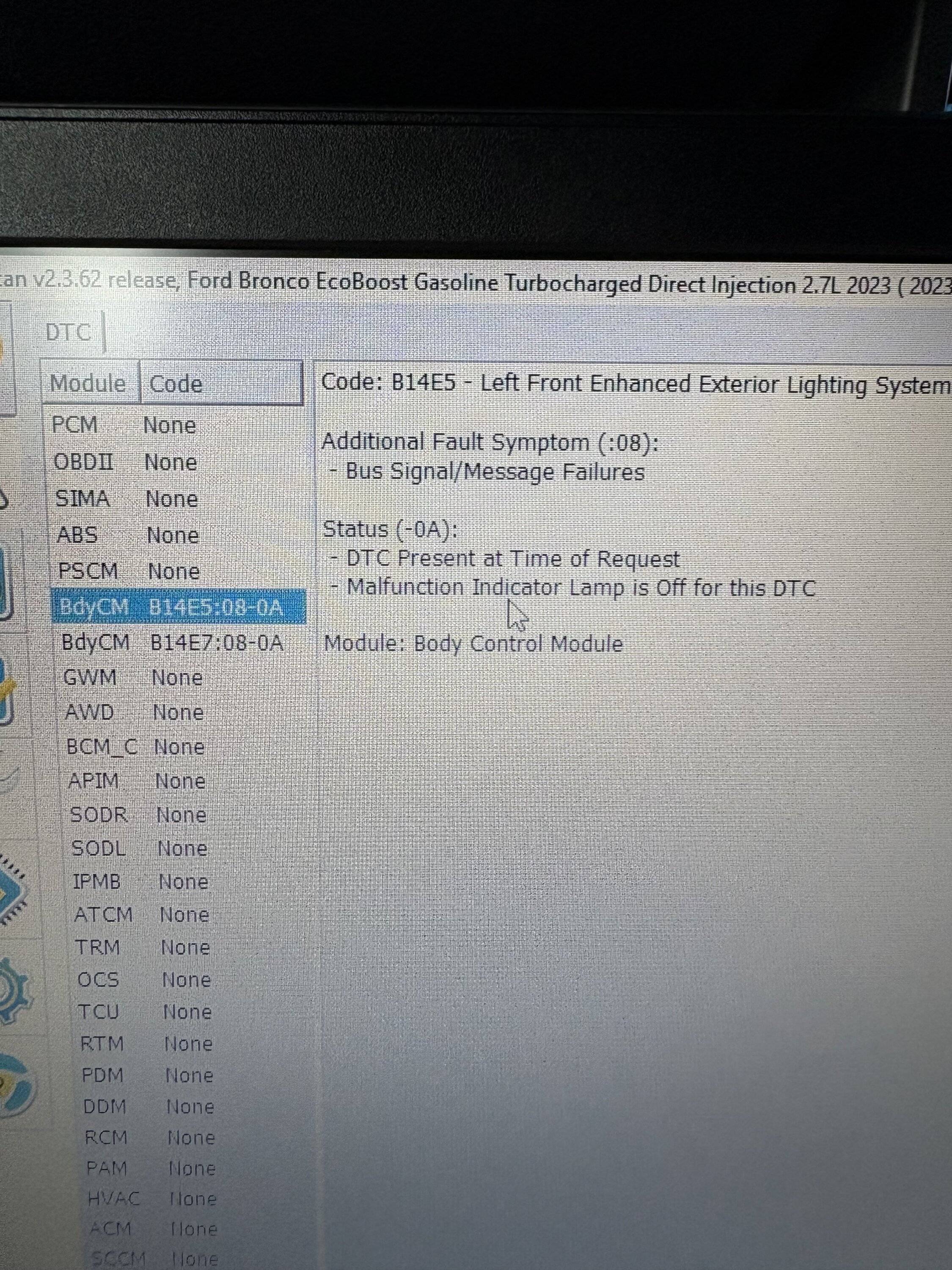

I can’t narrow down the source of this new CEL. No new light mods of the many done were recent, all over 1 year old. And these codes just popped up. Any ideas?
Ford Bronco CEL from BdyCM codes B14E5/7 IMG_0088
Ford Bronco CEL from BdyCM codes B14E5/7 IMG_0087

Do you have aftermarket headlights?

Thanks. Yes the Oracle Oculus, installed day 1 after delivery.
I tried DTC clear, stil got the thrown codes - but after power up-down, then driving, the CEL dropped out today. Hopefully it stays below the CEL threshold for good.

Ducati1098, I wondered also if there is away to force-ignore these codes, or if the dealer can do it, based on what you know?
