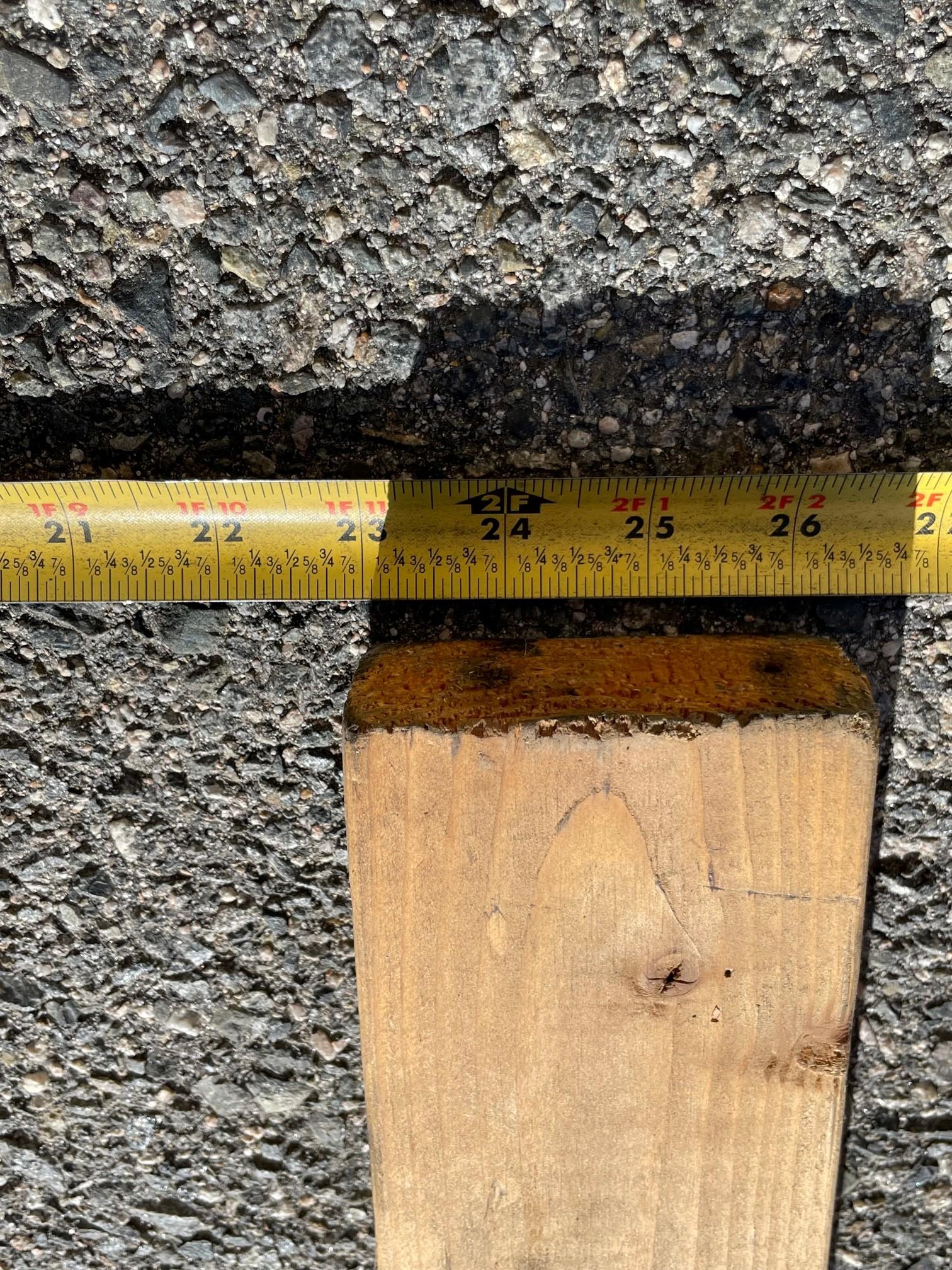

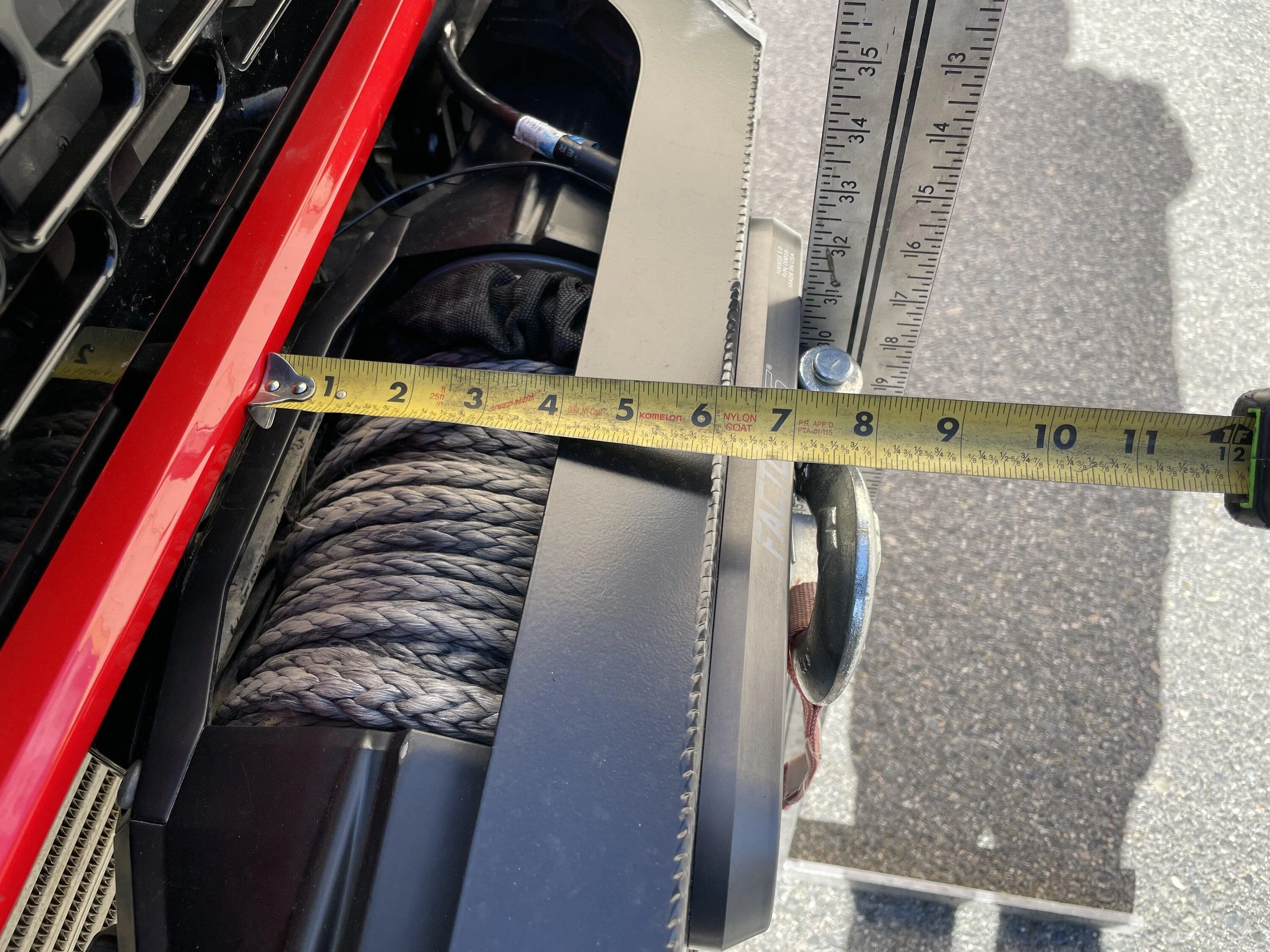

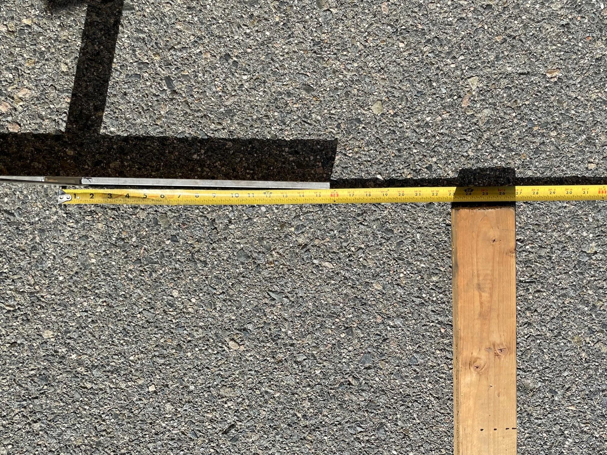

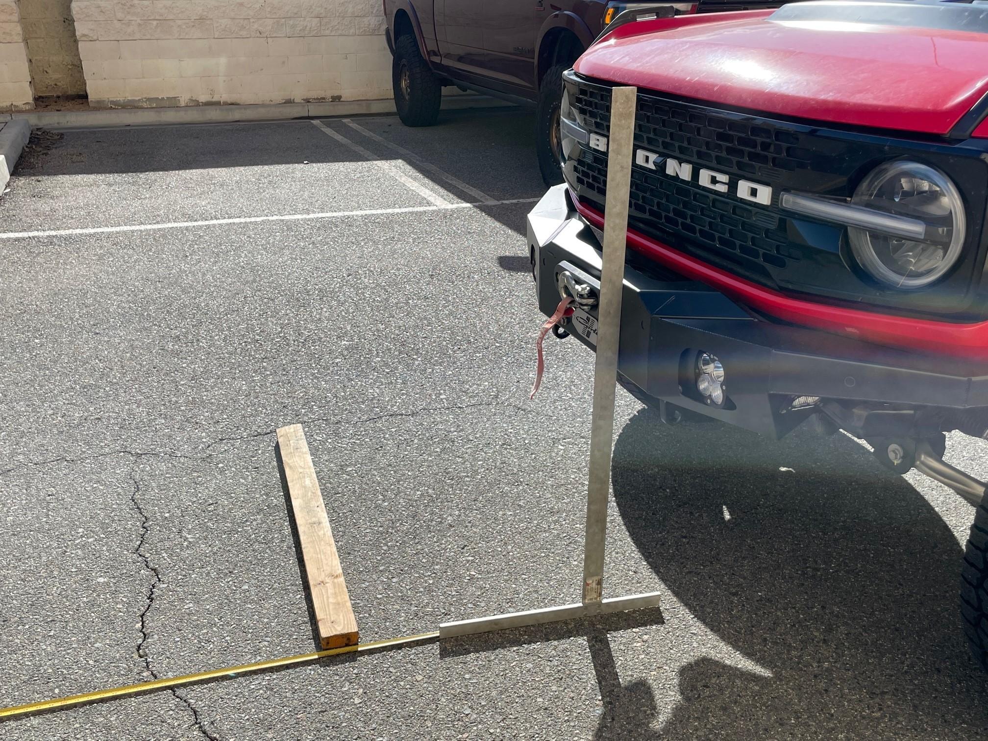

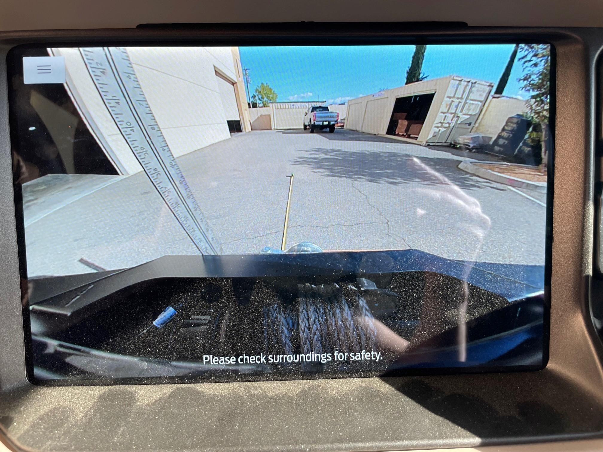

Here is a practical measurement.
The idea is to show how small of an impact our bumper/winch makes on the front facing camera.
In this picture above, I moved the 2x4 as close as I could just before it was completely covered by the bumper.
