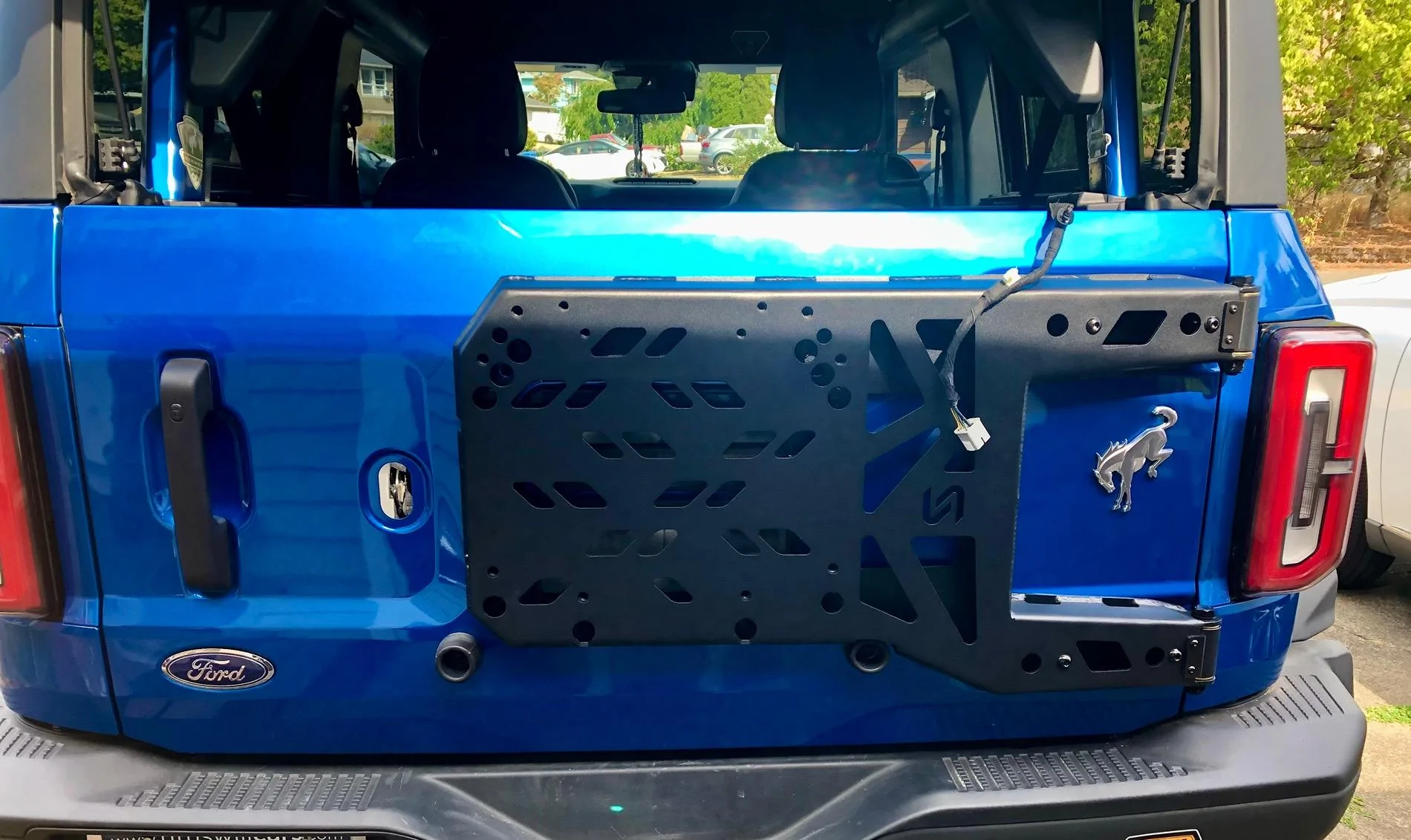

Remove your spare tire, see if that changes anything. My fixes, the soft top was terrible, new Trektop fixed that. Didn't realize a lot of rattles were from the tailgate, Hammer Built brace for the spare tire fixed that. From there, I've lined panels/metal with Dynamat, every little single plastic clip, OEM connector, wire with fabric tape/putty/zip ties etc. Adding a 10" sub uncovered the rest of the rattles. This and everything else others mentioned. The Bronco is super easy to take apart, you have to put in the effort to find the rattles on your own or you're SOL.
