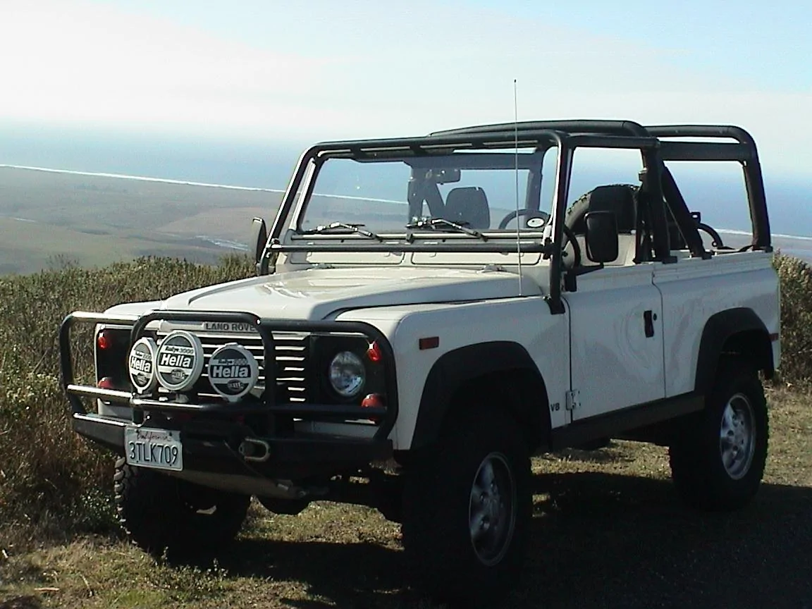

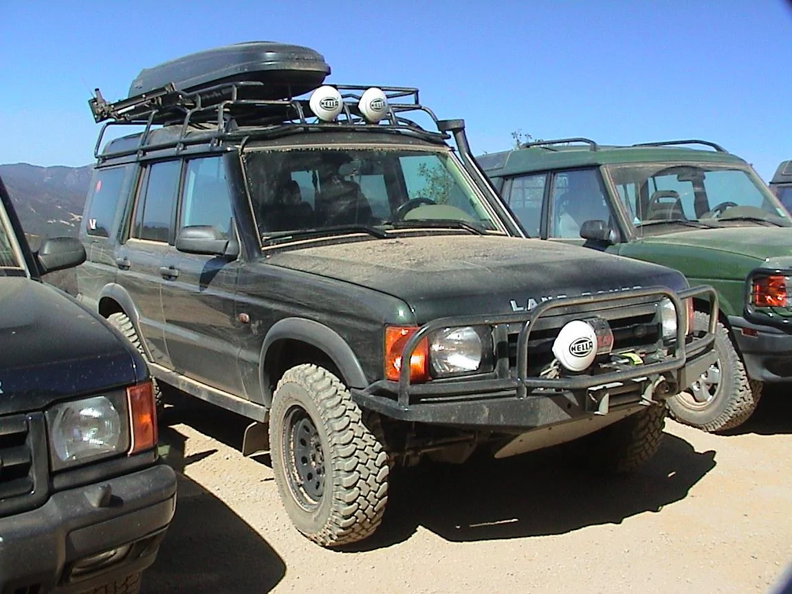

The ones on my Defender 90 and Disco II could do it, SafariGard. The Disco II's bumper had the side supports resisting collapse into the grill, beefy but these are all heavy. Given the other issues with Bronco gross vehicle weight, I am not sure what is possible??

I don't think any modern vehicle will resist collapsing. It's part of the energy absorption process that dissipates energy and or progressively slows the vehicle instead of coming to an "abrupt" halt. Maybe you could tie the bumper into the frame past the energy absorbers, but that seems like a potentially dangerous option. Several mechanical engineers on the forum, they know much more than me. I just learned how to assess the damage after a crash and you usually started at the "crush zones" to look for deformation (it was often hard to see any damage outwardly after a crash with urethane bumpers and energy absorbers, but then you look at the crush zones and they were wrinkled and the paint flaked away).

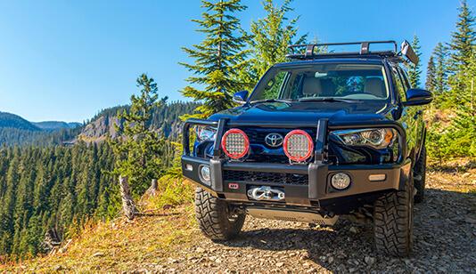

ARB looks like it should work too (assume they have the Bronco on their radar):
https://arbusa.com/bumpers-protection-equipment/summit-2/
I would think they do. I am looking closely at their catalog in another tab.
