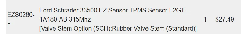

tpms.com will pre-program them for Bronco (included in cost). If you buy an unprogrammed sensor on amazon or such, your installer will have to program them before they will work.
This is one that is similar to Ford OEM. There are cheaper options also.
Ford Bronco Buying TPMS  Sensors 1673151837599
tpms.com is selling OE and OE tier 1 manufacturers' replacement sensors.
The Schrader, Schrader EZ-sensor and VDO redi sensor are all top notch products. In the case of the standard Schrader sensor, it's the same one that is factory mounted.
