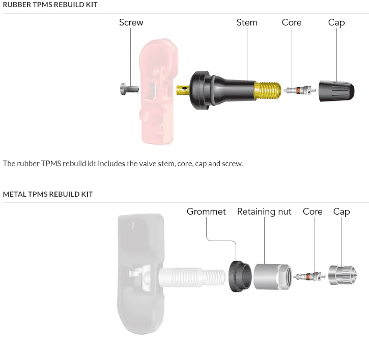

Yes you can reuse TPMS sensors, you would just want to ensure the shop rebuilds the sensor with new parts when they are put on the wheel. There are 2 types of sensor kits depending on how the valve stem attaches.
If its a metal stem there will be a gasket and new nut, if its a rubber stem it would come with a new stem and internals.
