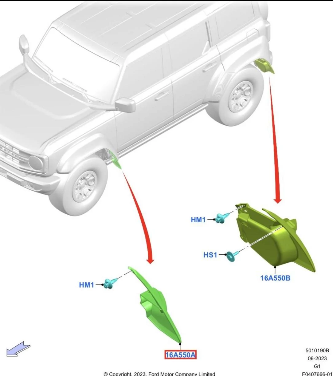

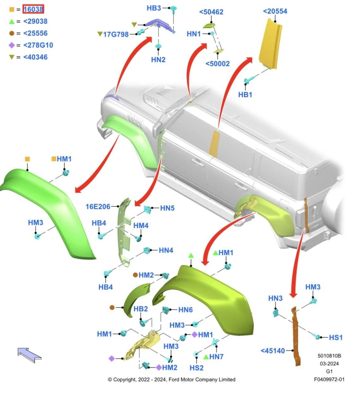

Here’s the info you need given to me a while back via @Ducati1098 :
(1) - N2DZ-16038-ZC (right front flare)
(14) - W715694-S300 (tabs altho the new flare should include these)
(1) - N2DZ-16A586-AA (splash guard)
(?) - HM1 (tabs for splash guard)
My advice is to use @flip for parts ordering. He’ll have the parts and even though he won’t be local, he’ll get them to you cheaper than your dealer (pretty sure). And be prepared that splash guard will be on back order for a while. …

Yep, that's the flare ... Not the entire fender. Did you go thru the car wash prior to it flying off? I guess that's why you were probably asking for the part number.

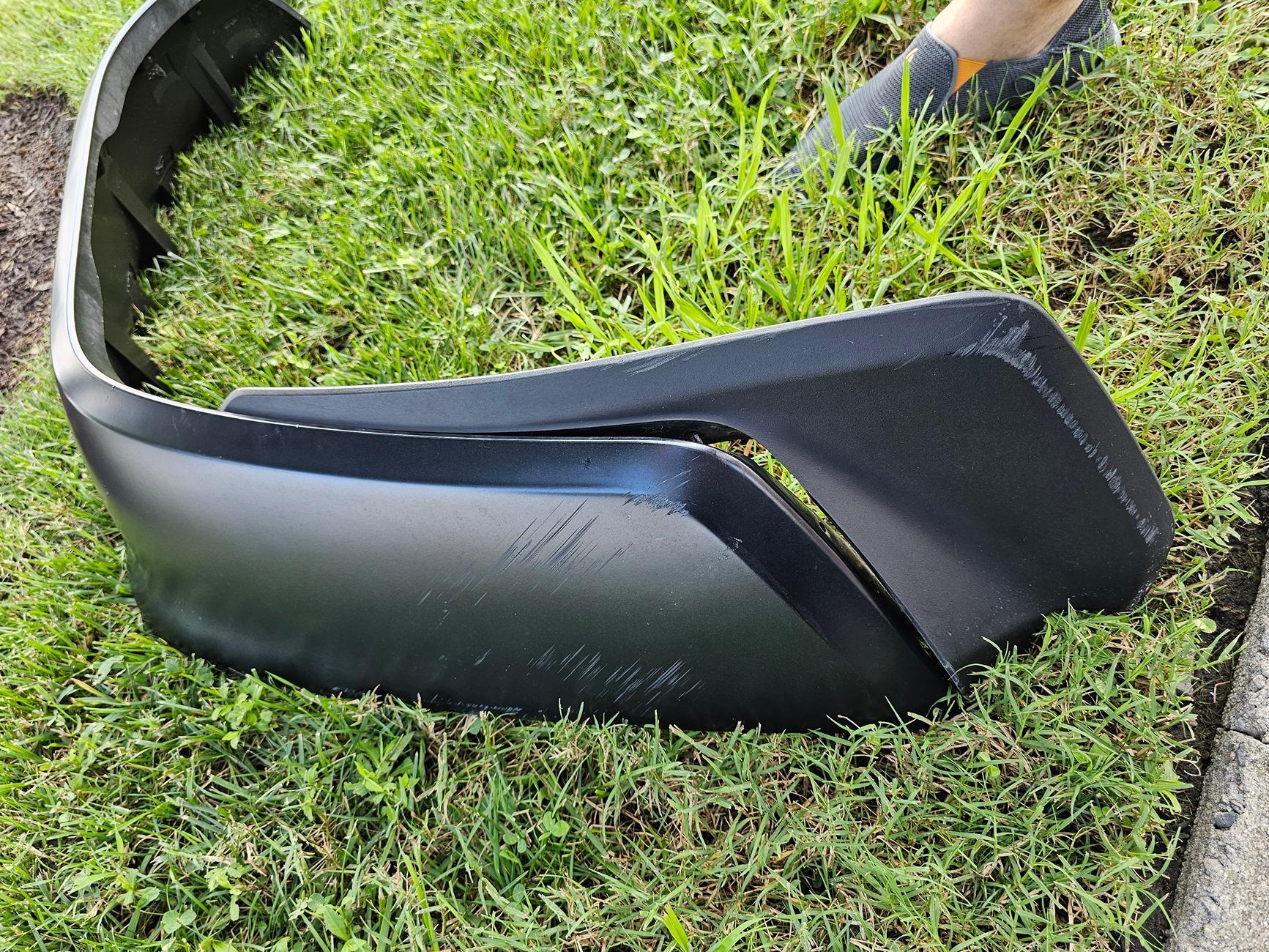

Both came off together. Unfortunately, I didn't pull over fast enough on the highway before it flew off. Suffered some road rash. I will call local Ford dealer and get a price.
Thanks for the feedback.

Did you recently wax it? Just trying to get to the bottom of why it fell off.

Fell off?
Based on what I see there, this was far from a "what'd you do?" type situation.
You're new here? It's a long running joke on b6g.
