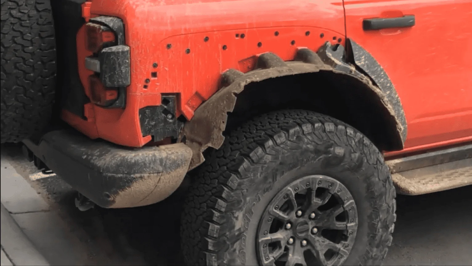

any picks
I’m looking for some kinda support to build a custom set off of
….of flares?
I don’t have any personal pics, but I ran across this a while back…. It should give you a good idea of what you’re dealing with before pulling a flare. It’s a whole lot of ugly under there, and why we’re not seeing Sasquatch style flares in the aftermarket.

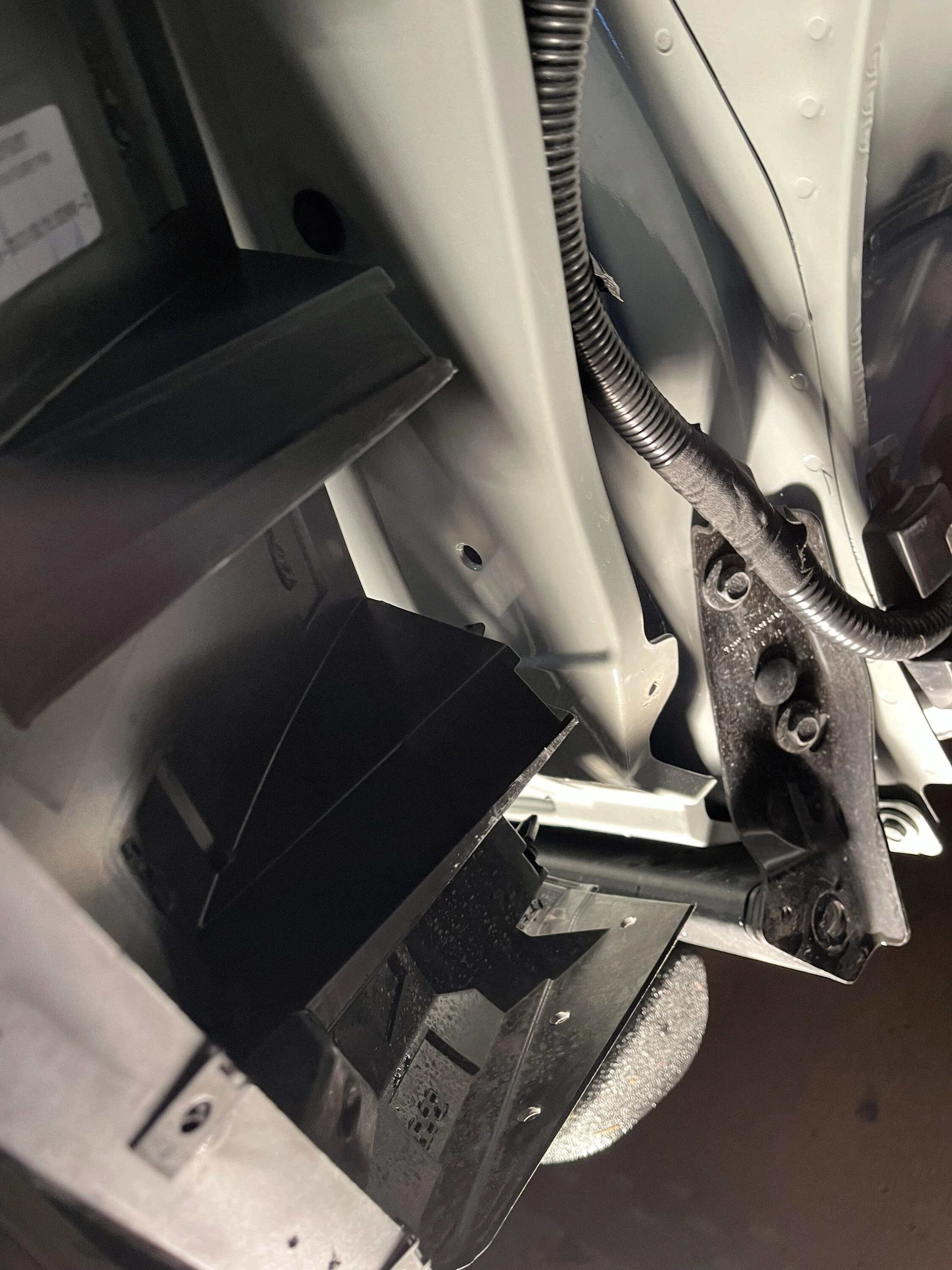

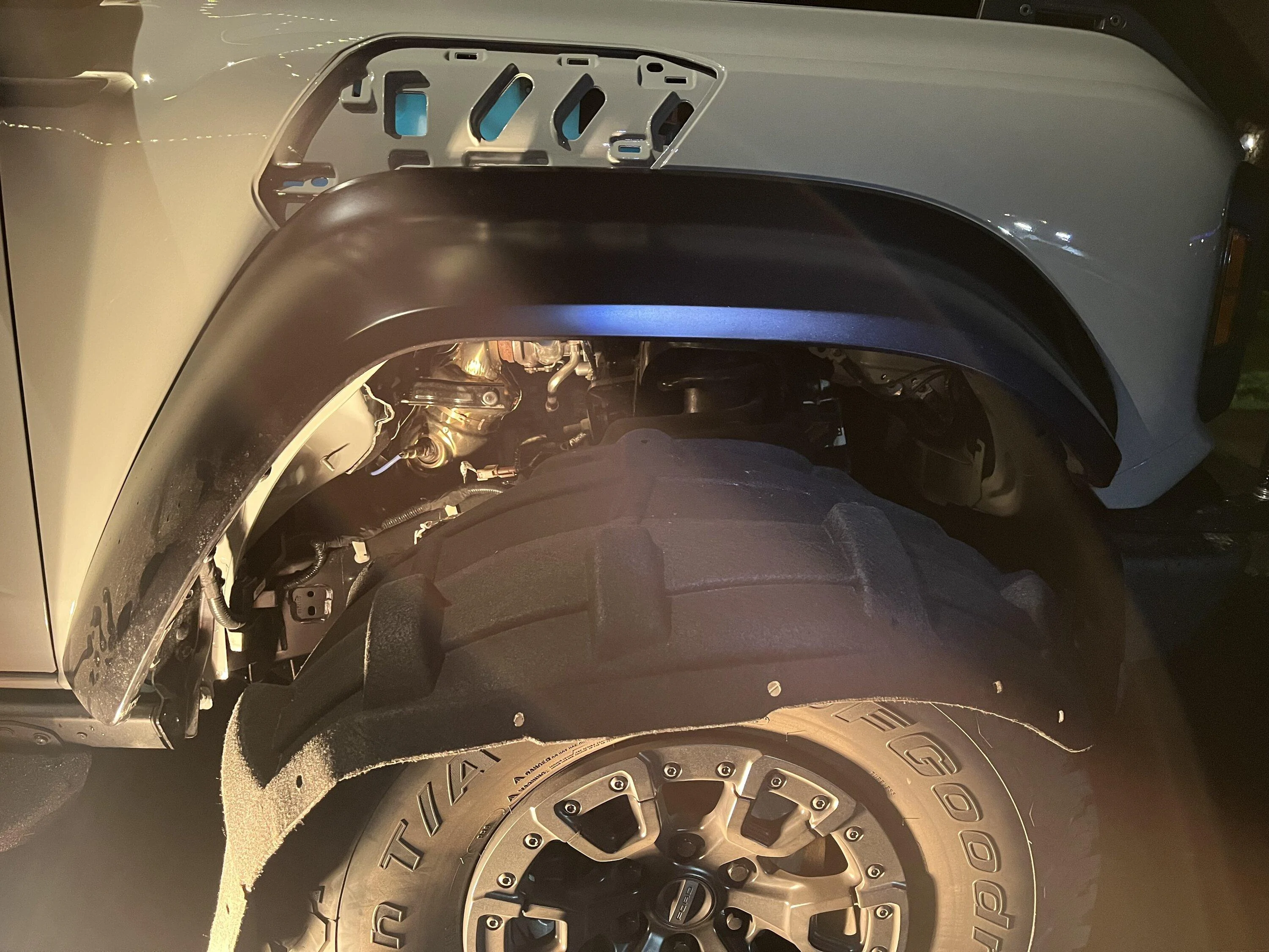

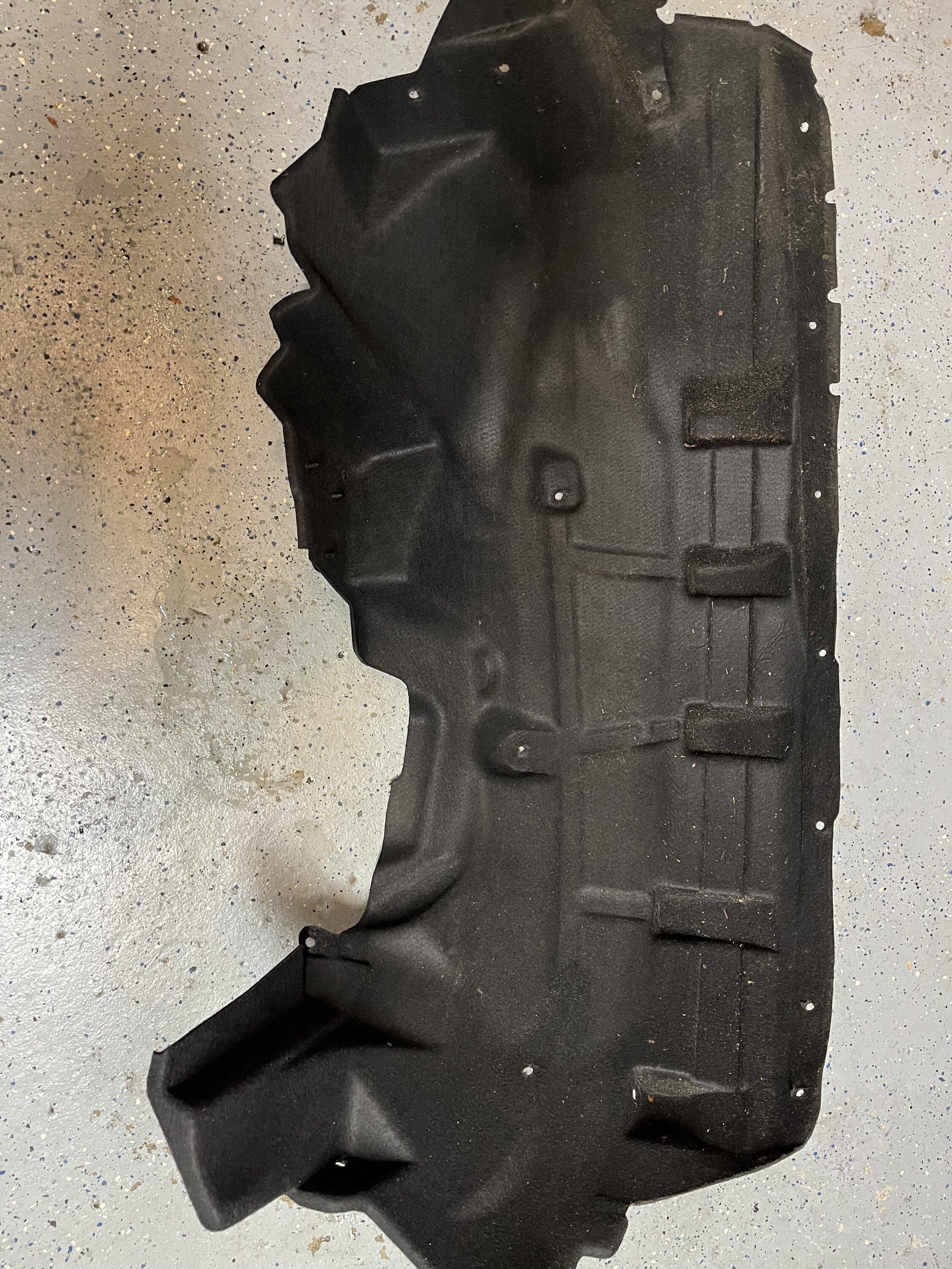

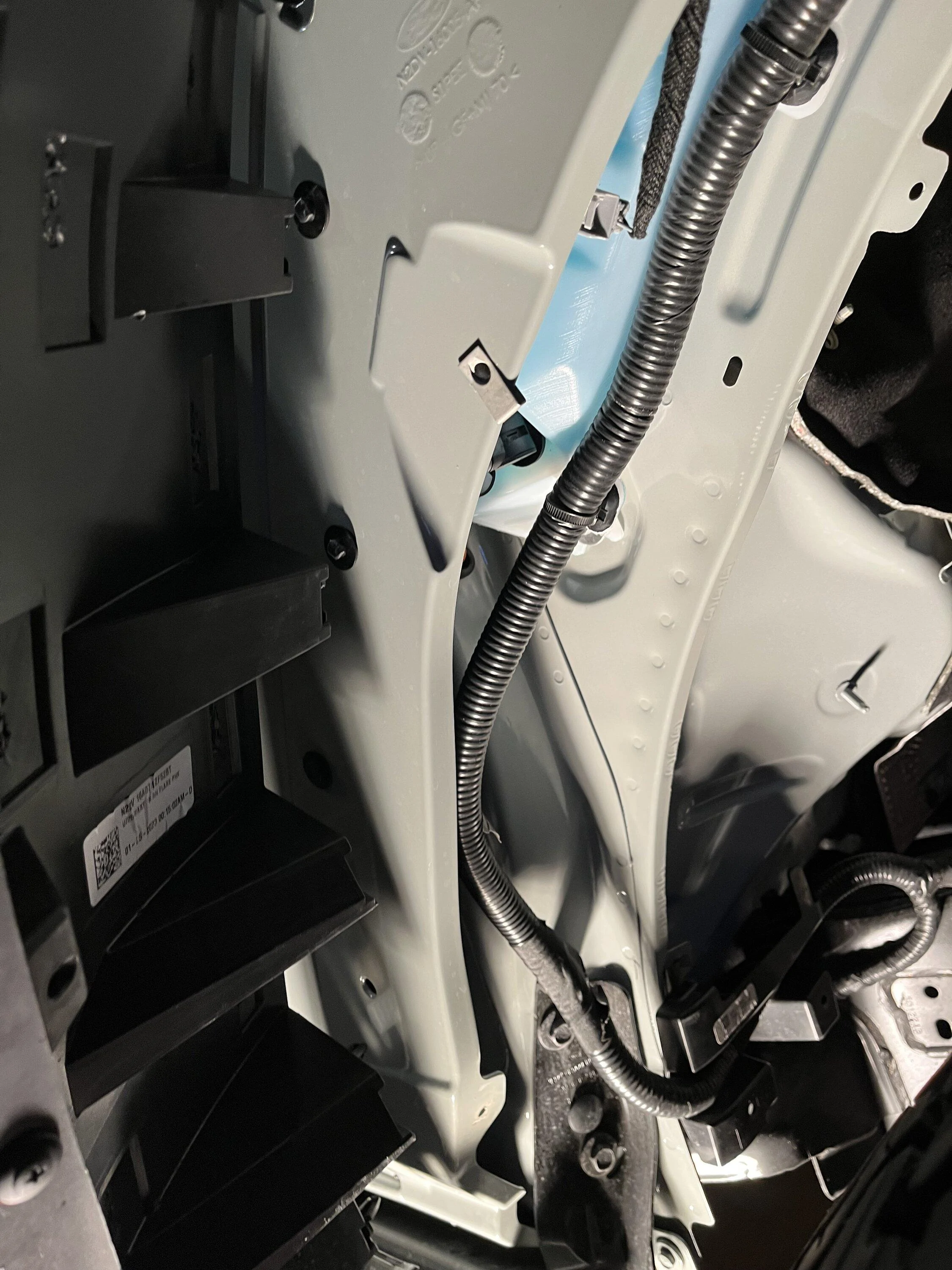

I have a question, does the removal of the Braptors fenders appear in any manual or is there a guide to look at?
I have no good pics - just these - and I only have front experience.
1) remove inner liner - you will break those crappy clips - the wheels can stay on.
2) “slowly” pop or pry fender flare off from rear to front. I broke no clips and reused all OE clips. When I reinstalled the clips, I had to rotate them 90 degrees to hold the flare on.
I think if any good mechanics actually give this a shot this will be reported out as much simpler than all the unclear info here so far
