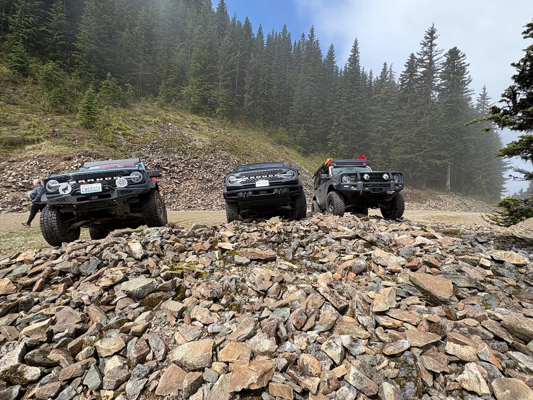

I have a 2021 Base, and this weekend I was out enjoying the great outdoors when I got stuck trying to go around a tree.
Once we made it to the top of the hill, my buddies and I noticed a burnt smell. After checking things over, we found that I was low on coolant and my 4WD had stopped working.
We topped off the coolant and headed home, but the burnt smell never really went away. Even after running a few errands today, I noticed it again.
Any advice or ideas on what I should check would be greatly appreciated. Thank you!
