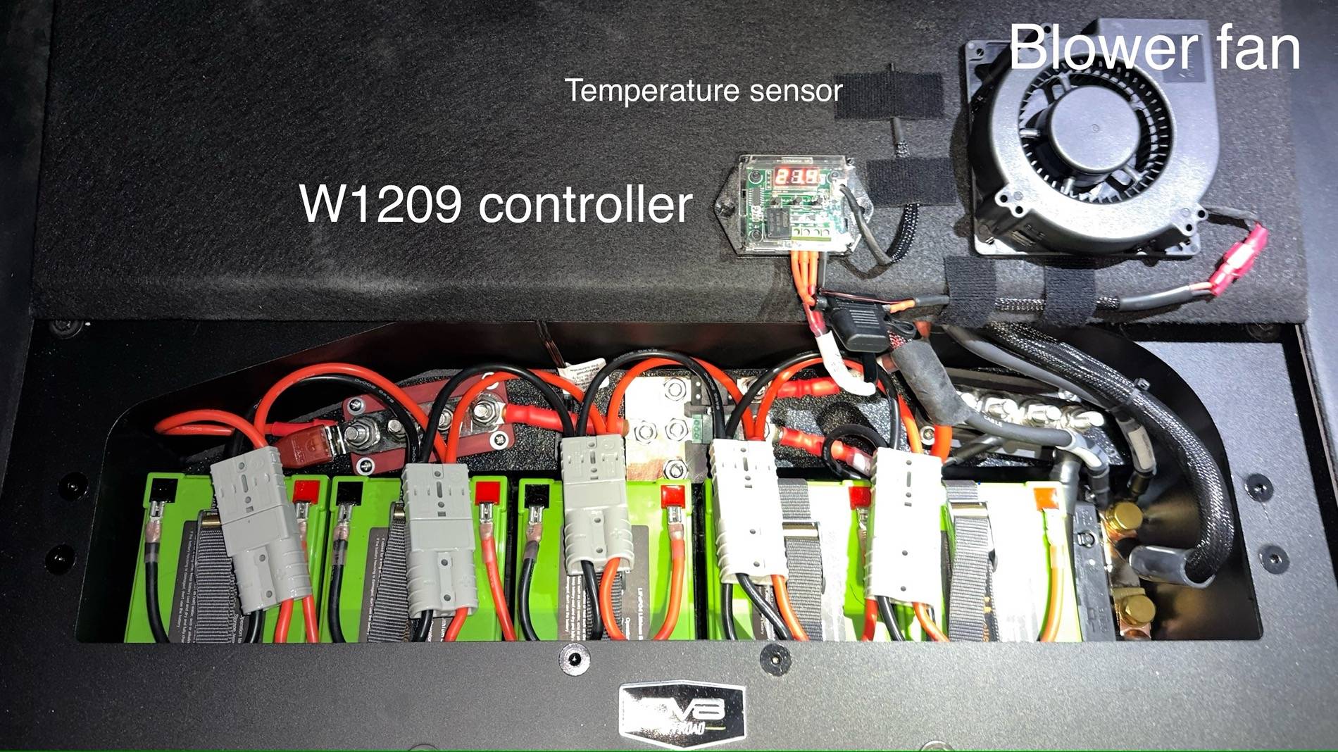

To manage temperatures I added a W1209 controller and a blower fan to the enclosure.
  • Blower Fan: 120mm x 120mm radial blower rated at 31.6 CFM
  • Controller: W1209 digital thermostat wired to trigger the fan
Everything fits nice and snug. I have them mounted with Velcro to the lid of the enclosure for now. I will reassess later on if I need to hard mount them, but for now this is ok.
The W1209 thermostat can be programmed to activate power to the fan when the temperature reaches a certain threshold. It’s set to kick on at 110 degrees and turn off at 100.
I’ll post some performance results after a few long drives.

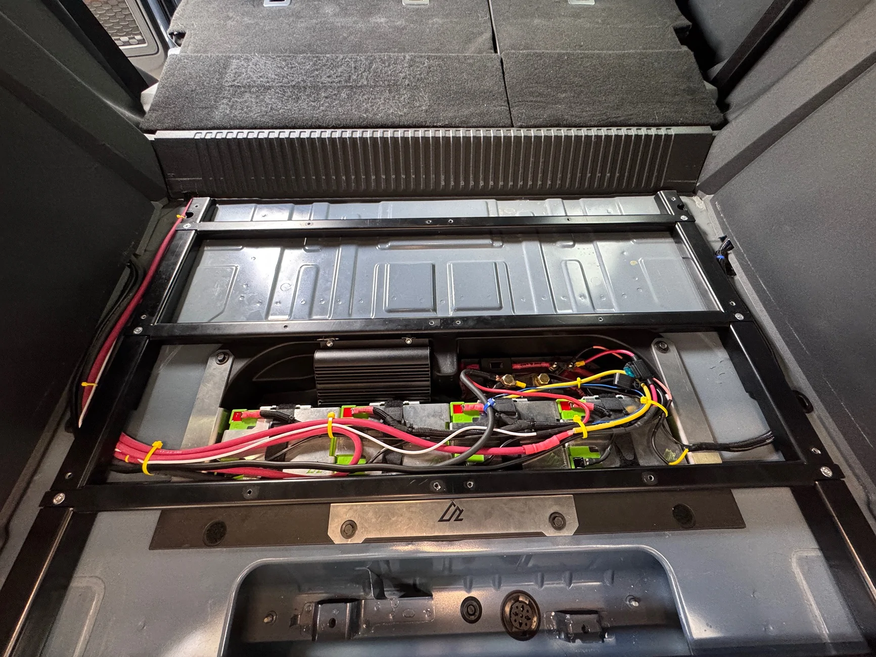

I’m not sure they would. The photo below is with the trunk floor plates removed and showing the black support brackets that the floor bolts to. They’re only about an inch and a half higher than the batteries

I can’t find any leaks, but I always seem to have moisture in that well. Do you have that issue? If so, has it caused any issues for you?
I haven’t but I noticed two things, one is the holes that the stock floor bolts to are pass through so if you unscrew the stock floor, water can get inside from underneath (maybe try tightening those screws?) I ended up using plastic body plugs that fit and plugged the holes. The other is there is a drain in that area you can make sure that plug is fully sealed
