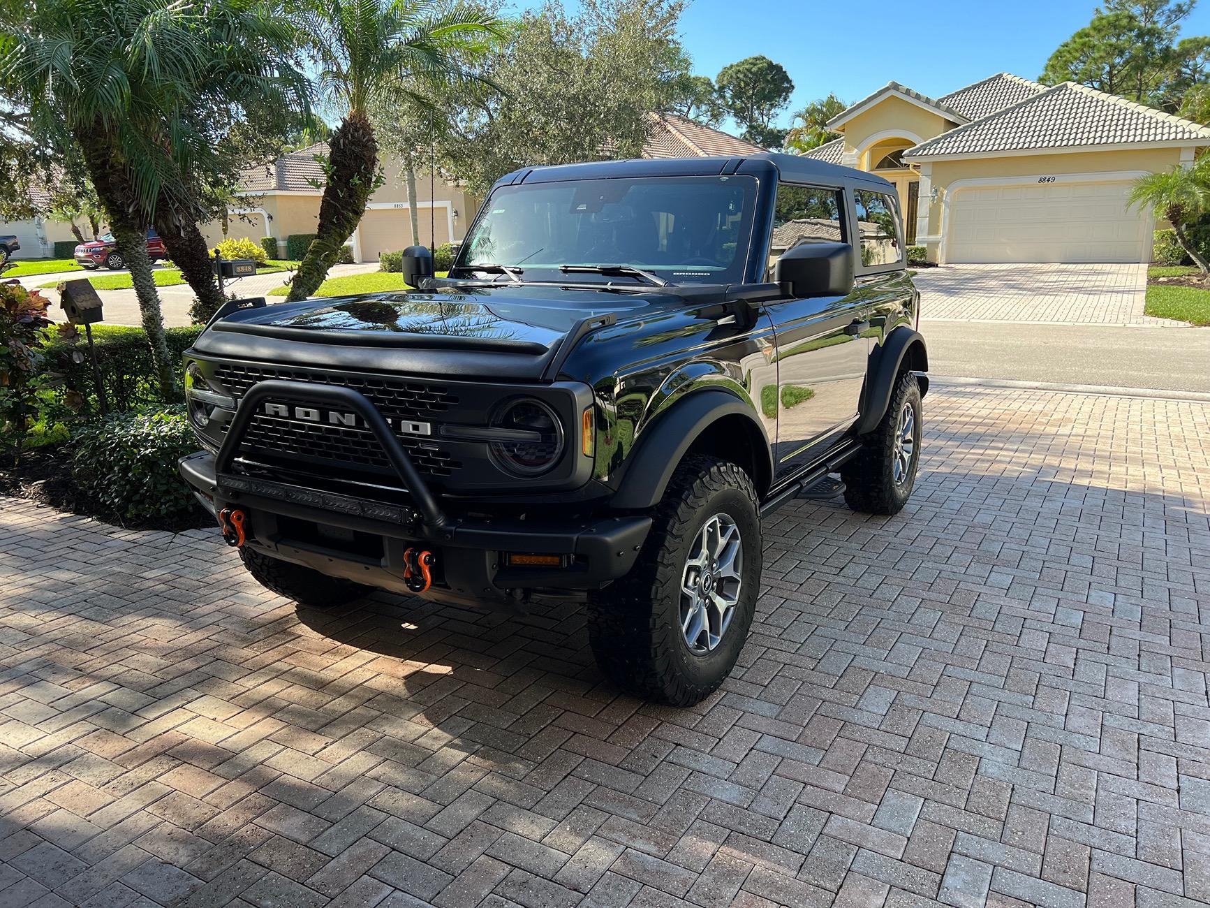

Mjtermini
May 8, 2021
214
224
2022 2DR Badlands
After my last trip in the Smokies. Torque did a great job on the scratches
Ford Bronco Buffing out limb and brush marks IMG_3371
