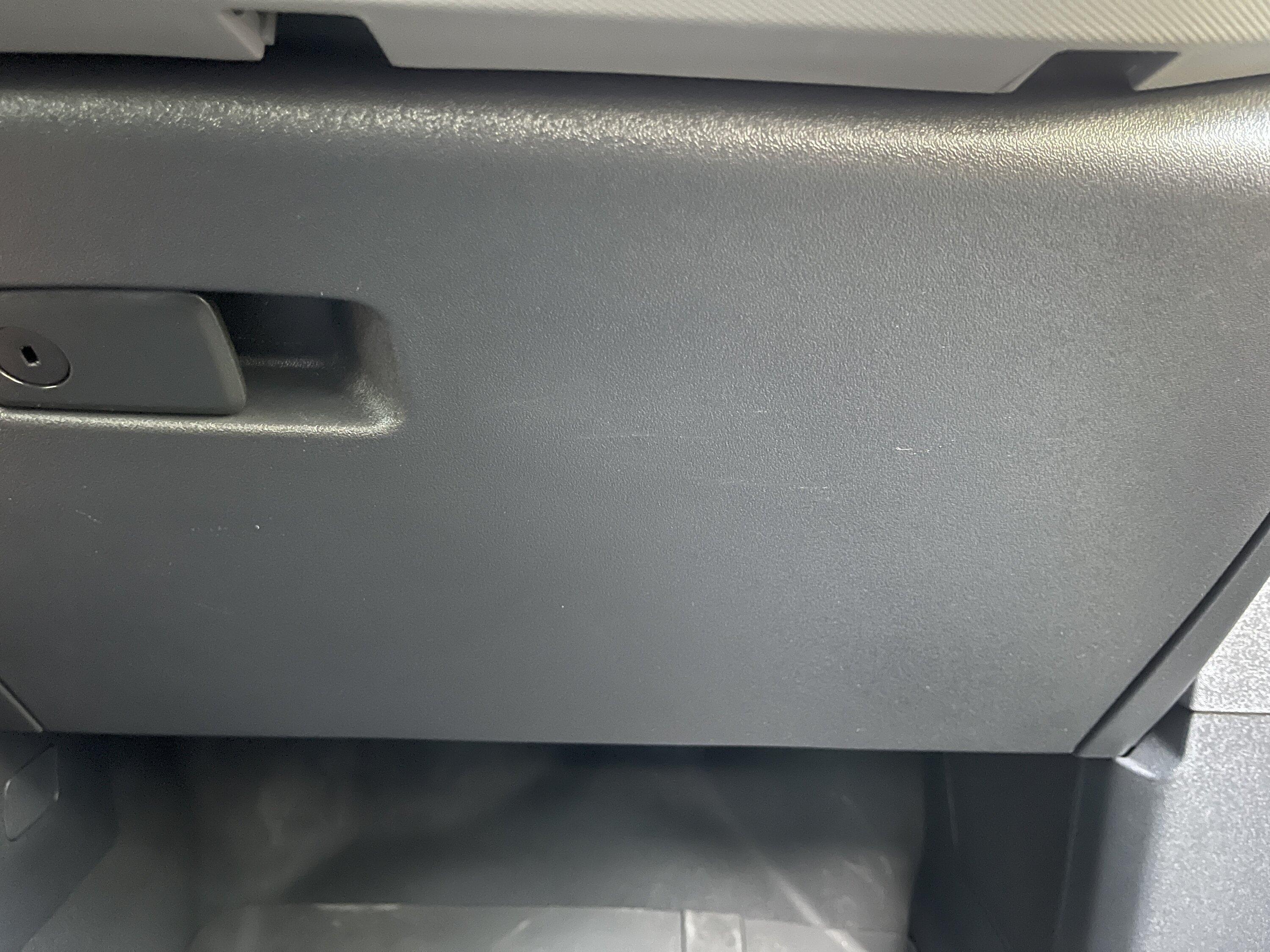

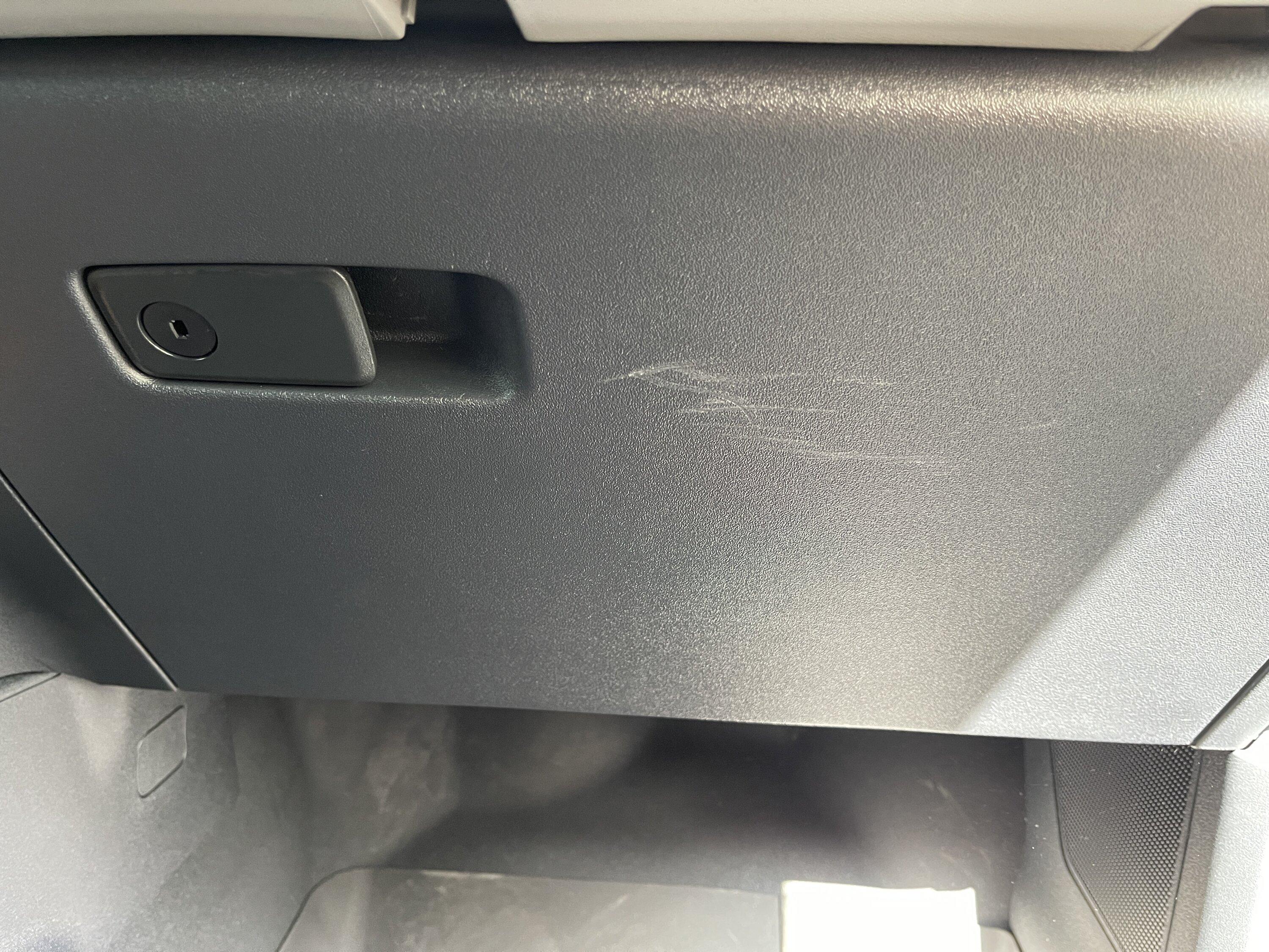

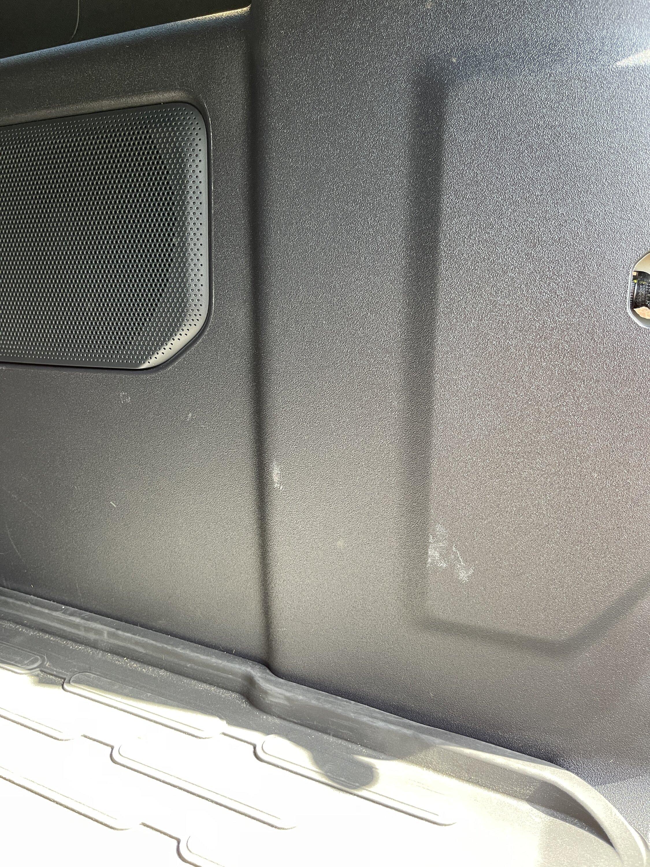

I was transporting a tall plumeria with a terracotta planter and did this to my own vehicle. 🫣
As soon as I placed it in the front and created the scratches I removed it and put it in the back. I’m not too worried about my trunk, but wanted to know if anyone has been successful buffing out scratches from the plastic. I tried cleaning with chemical guys VRP and a micro fiber cloth..

Heat gun, works well for scuffs like these. It won't completely remove them but it'll reduce the appearance.
Don't go too crazy with the heat.

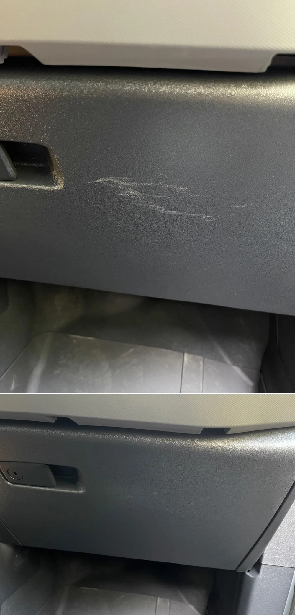

You saved me and my OCD nature. Heat worked. I worked up to 700 degrees, don’t didn’t let it hover, and buffed with 0000 in the same directional rotation, don’t reverse.

My experience using heat on cheap plastics is this it will be a temporary fix, but will lead to discoloration later on.
šŸ¤·ā€ā™‚ļø
Welp, better than looking at scratches probably. I coated it with VRP again just after, looks even better. It’s in the shadows, so I probably won’t see any discoloration and i won’t even bother trying to fix the trunk..
