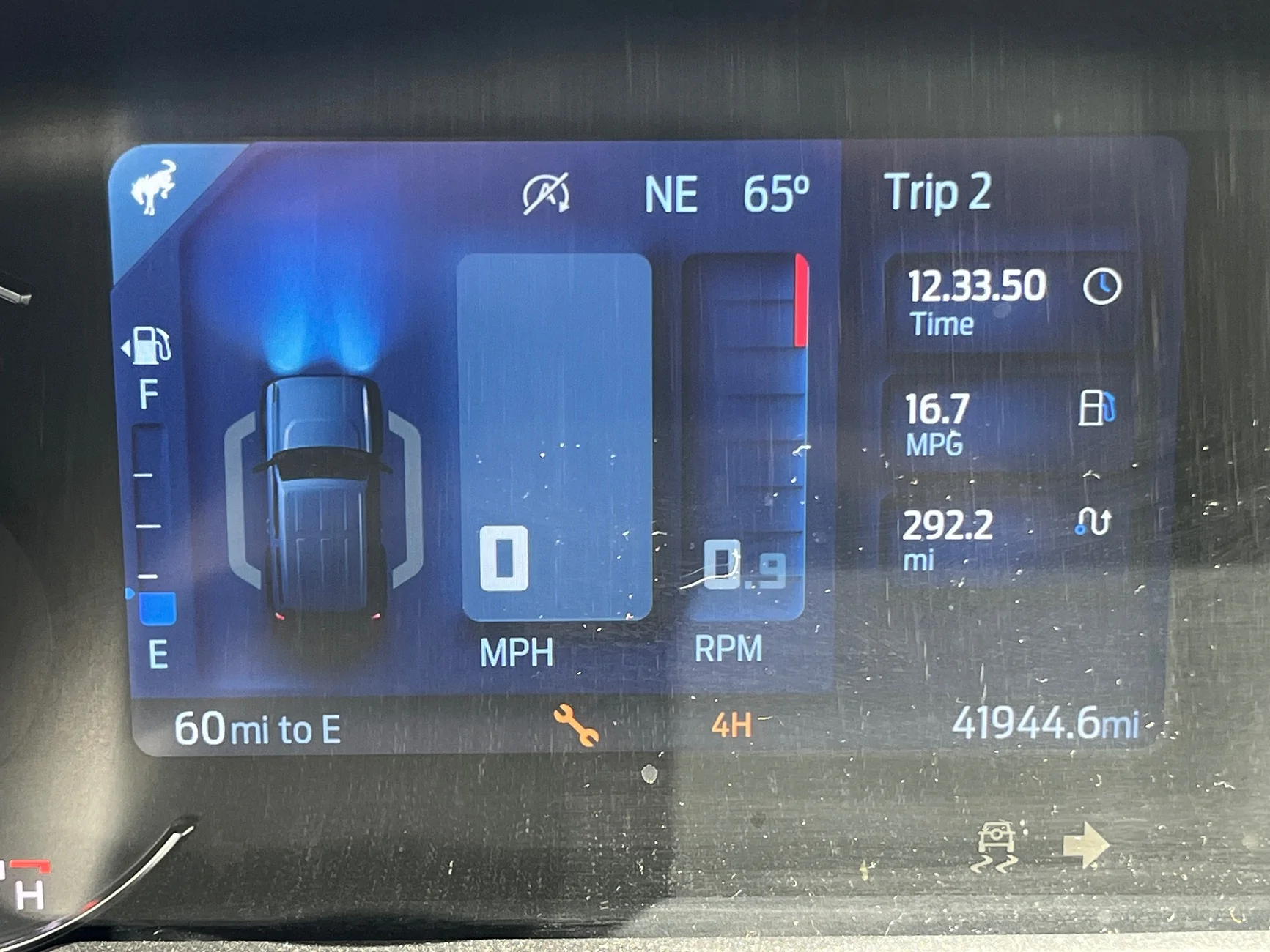

So very weird thing happened yesterday with my Badlands 2.3L 7-speed.

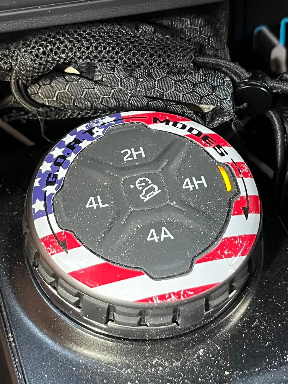

At startup, I put the Bronco in reverse to back up and warning lights came up on the dashboard and it was very "herky-jerky" in reverse. Almost like it was "surging" but at very low speed. When I looked at the dashboard, it said "Service vehicle soon" or something to that effect. I thought that was weird, along with the unsmooth reverse gear. Then I put the car in 1st and started to move forward and I felt the tires scrubbing. That's when I looked down at the 2/4 GOAT mode selector and noticed that it was in 4H. I am never in 4H unless I am offroad or driving in snow, and couldn't figure out how this could be.
I put the Bronco back in neutral and tried to switch to 2H or 4A. Nothing happened. I tried to move forward in 4H and it felt the the tranny was "binding up" . Tried several times to change 4WD modes but it was stuck in 4H. Finally I turned off the Bronco for about 30 seconds and then started it up again and all of a sudden it was in 2H and all seemed back to normal.
Has anyone experienced anything like this? I was not able to get a screenshot when it was saying "service needed" but I did get photos with the "wrench" light on and the dashboard showing 4H. Really not happy about this "incident" and will take it into Ford this week to have it checked out. Luckily I have the 7 year 100K miles bumpet to bumper warranty from Ford so I don't care what it is, I just want it fixed. Appreciate any thoughts as to what this could be to have a more intelligent discussion with the service folks.
Gonna be ticked off if they tell me there are no "codes" in memory from the OBDII port too.
Oh and looking at the photo after I posted this, I noticed that the traction control light is on too.
