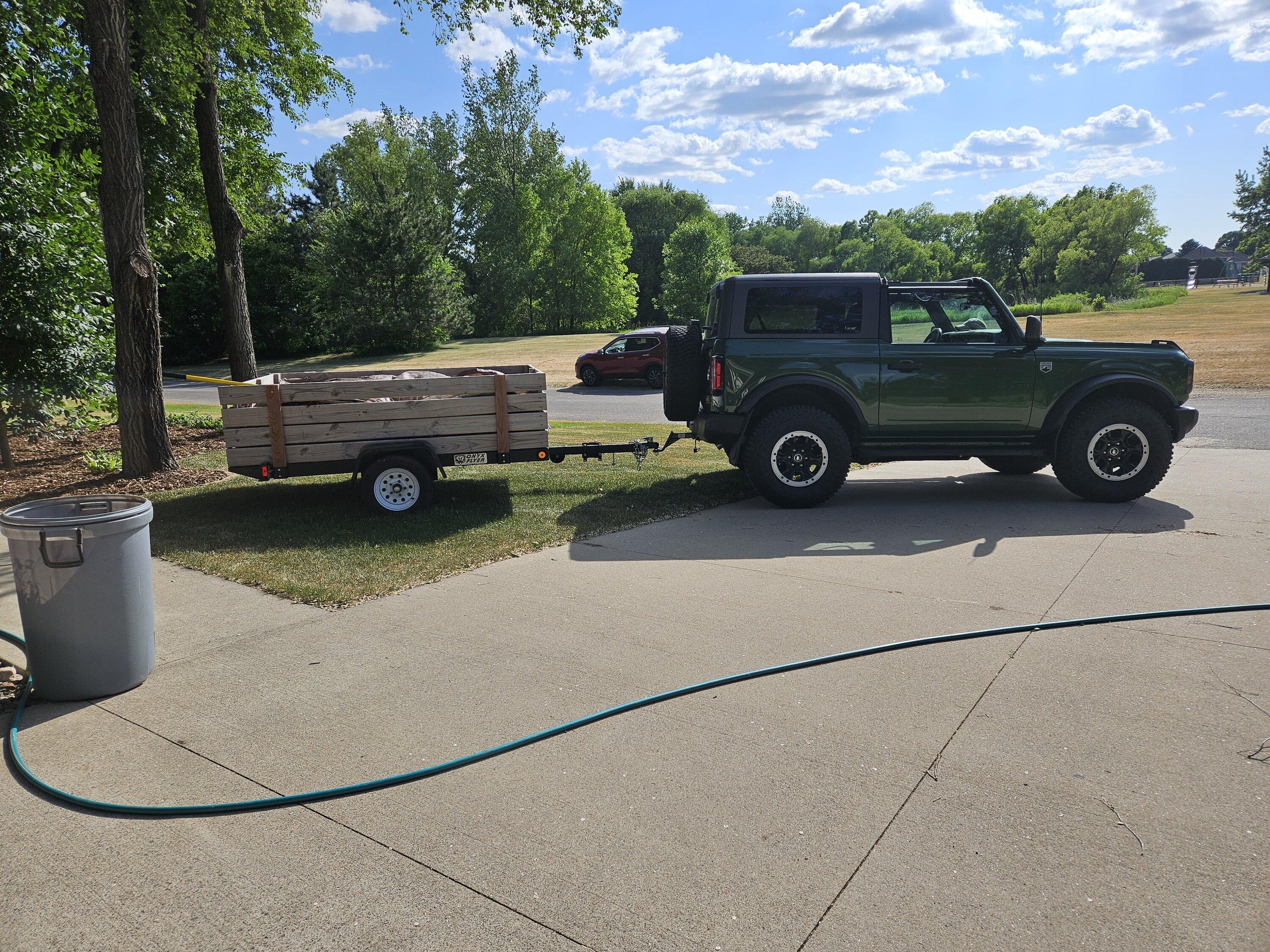

I have a 22 Big Bend 2Dr Squatch w the 2.7. I had this 5x8 utility before the Bronco, as I had an old Yukon as my daily, and this trailer filled all the needs of a truck. 8" drop hitch, pulls straight, no wobble. This load was 5 skid steer buckets of wet cedar mulch, and I didn't know it was back there. Don't see myself pulling anything much heavier.
Ford Bronco Bronco + Utility Trailer 20230611_172301
Thanks. That looks very similar. Did you need an extension for your drop hitch? What size tires are on your trailer?

12 in trailer tires, tongue is about 15" off the ground when fairly level. Drop hitch is actually a 6", (I thought I had to go 8") and the distance from the hitch pin to the ball is about 15", so a tad longer than normal. Harbor Freight special. Works perfect for my needs.

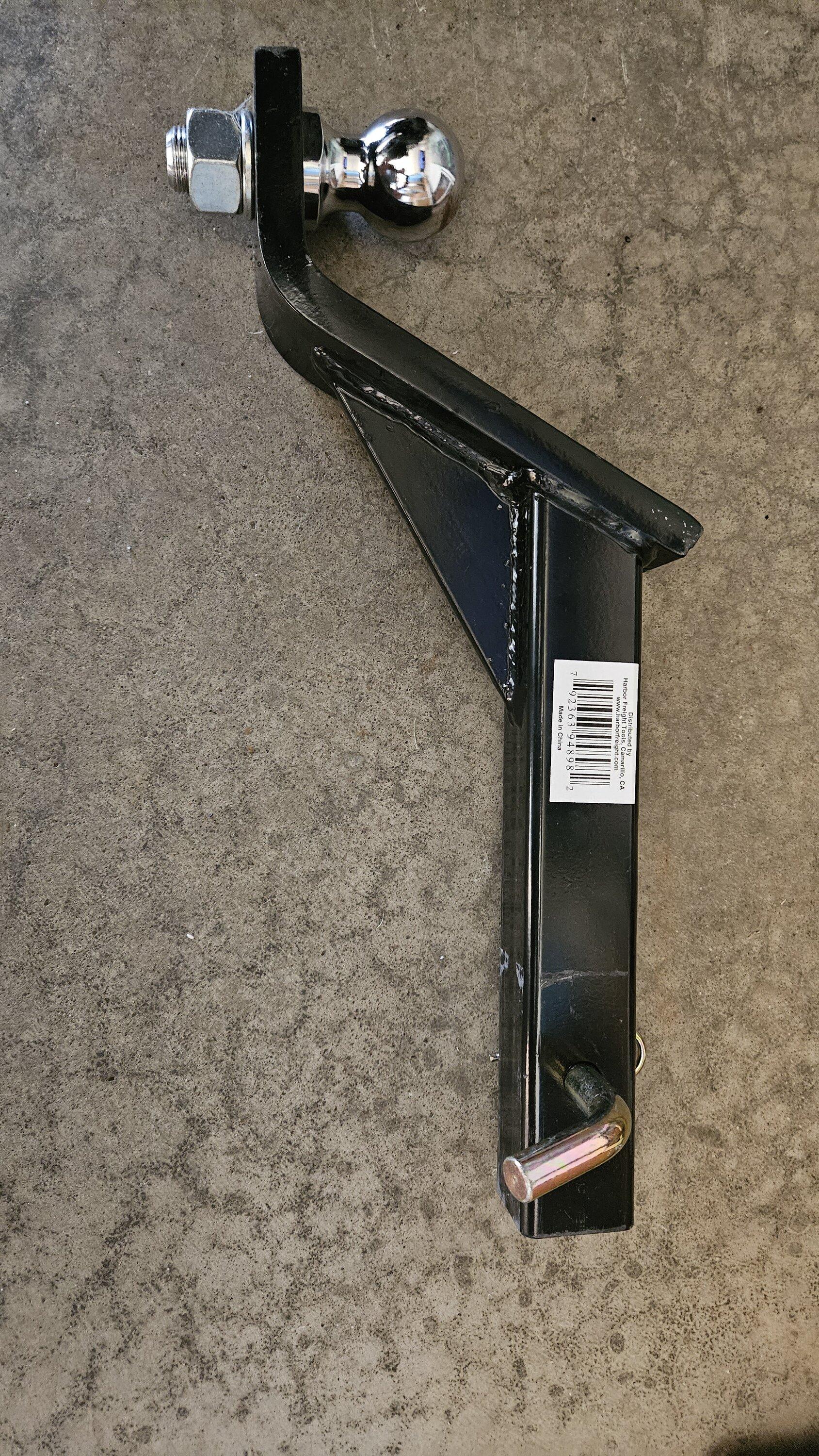

Ford Bronco Bronco + Utility Trailer 20230904_174127
I thought I needed a 6" drop, actually needed a 4" drop. Maybe someone someday can use the 6"
