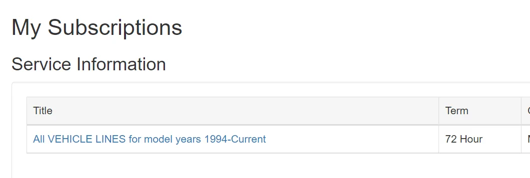

Once you've paid, log in to the same site, click on MY SUBSCRIPTIONS. You'll see this:
Ford Bronco Bronco TSB and SSM Notices 1652293578248
Click on the blue link (All VEHICLE LINES...)

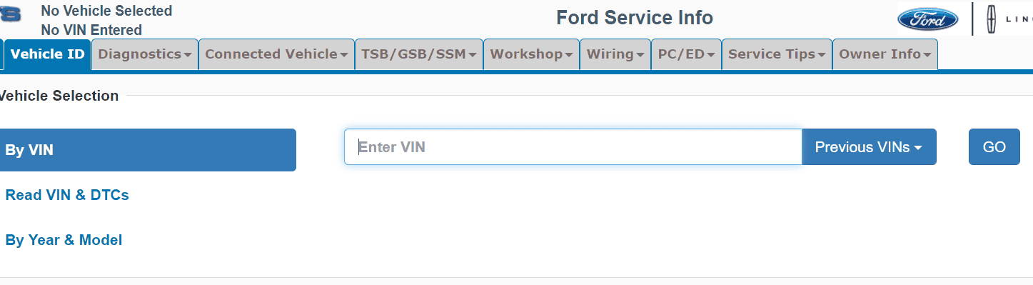

You'll see this:
Ford Bronco Bronco TSB and SSM Notices 1652293622262
Enter the VIN or select the year / model etc.
The manuals are under the WORKSHOP Tab. This is the same resource the dealer techs use.
