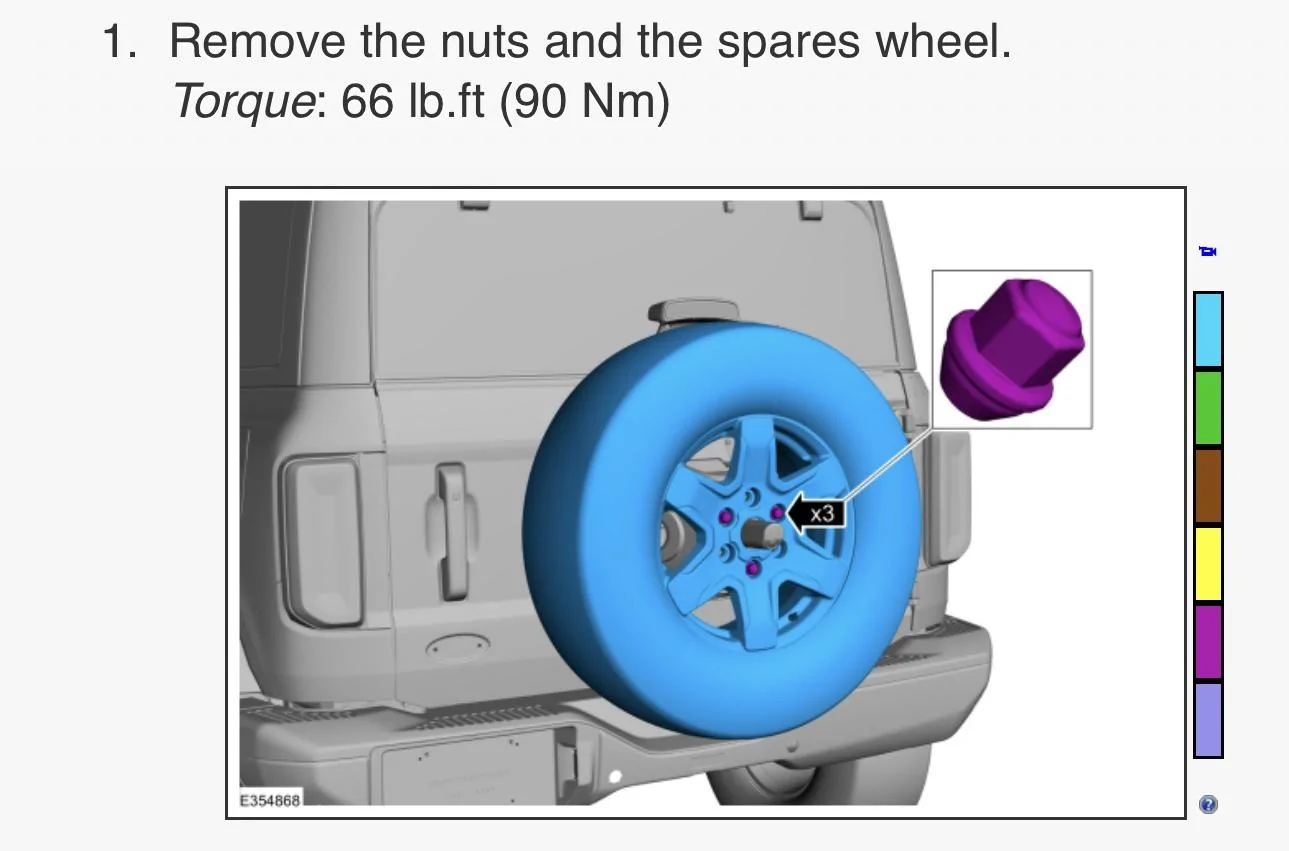

Guys, i checked with online ford manuals for the bronco, if you go to the bronco part which says excluding raptor, it is 41 lb and for Raptor is 66.
So correct one is 41 for bronco and 66 for raptor models. Just one thing that i can't understand is that, 41 is for the bronco w sas pack wheels and tires or it's for the the ones with smaller tires hahahaha... again confusing.
@fordmotorcompany please let us know. What is the exact correct torque spec for sasquatch wheels and tires. (35s) please someone let me know 😂😂😂

I asked the dealer and they have said, for bronco with sas and raptor, 66 is recommended and for smaller tire packages are 41

Did 41 lbs on my last 5-tire rotation. Noticed the spare from factory had pretty good indents on the tire where the bump stops make contact.
i just installed a M2M spare tire reinforcement and found one lug missing, one loose and the wheel lock still torqued. So guessing either they loosened on my last trip to Sedona when the rubber settled in on the bump stops, or someone failed an attempt to steal my spare.
Torqued to 66 today.

I did 41 the first time I put my spare back on and some time later, I noticed the spare would shake on the carrier when opening and closing the tailgate. Turns out the lugs worked themselves loose. I went to 66 after that.
